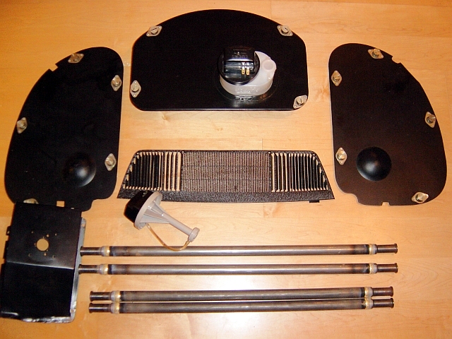

If I am interpreting your problem correctly you have no bulkhead panel in your wheel arch and the debris is being thrown directly onto the back of your head light.
There would be less wear on your light fittings if you fitted these shown in this picture.
As it were : belt and suspenders.

Jeff..Good idea...I'll do same on 2125
James...SPF does use a rear bulkhead so debris getting in somewhere else or through minor chinks?

The car does have the bulkheads (access covers) fitted. I may be mistaken but I think the inlets intended for front brake cooling are picking up sand/dirt from the road surface and its making its way to the back of the headlight.
