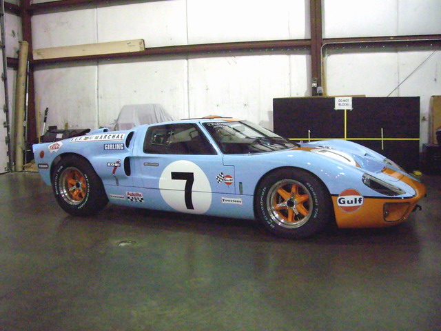

Have you considered 17's?

WOW! Those wheels look REALLY good!!
Can you post more photos? What size/brand are the tires?
Team Jeff is offline

N-I-C-E. Classic livery, if there ever was any.
Is it my imagination or does your car sit lower than the GT40's that Ford ran at Le Mans. (I believe the ACO, at the time, required all cars to drive over a and clear a small wood box or block as part of the qualification requirements. I don't think your car would make it.)

Alan, you're right, it does sit a bit lower due to the 17" wheels and lower profile tires. They're Goodyear Eagle F1 GS-D3 size 315/35/17 and 215/45/17. I lost about an inch of ground clearance. The stock 15" tires are about 26.6" diameter, and the F1's are 25.7" rear 24.6" front. The advantages are availability, Z speed rating, and apparently exceptional wet grip that I hope never to experience. Driving feel is much improved with the 17's versus 15's. The steering feels tighter and more connected and the ride quality isn't diminished. If you're not constantly monitoring road surfaces, whether you're driving 15's or 17's, the road debris is going to get you.

Hi Kevin,
"Is 215/45/17 wide enough for the front ????"
My first answer was..no, not unless you want to have some semblance of a turning radius...but realistically, I guess it all depends on your model of GT40.
I tried the 235/45/17's first and they scrubbed the well, but ending up with the 215's only lost 0.8" of tread width (7.9" vs 7.1" or 10%), of course, the 15" Goodrich tires are somewhere closer to 9". I also want to be able to find tires for the car in a few years, and with everything going to 18's and 19's and more, I thought that it might soon be difficult. Also, the S speed rating (112mph) bothered me a little bit....and I thought it maintained the classic GT40 look with a contemporary slant.
Here's mine with 15's:
