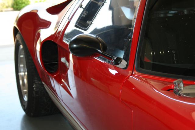

Many types of mirrors are bing fitted. While not period correct, I like these on my Mark II.

SPF has a thin seat and here are my mirrors; though on my CAV. The interior mirror does work and these outside ones are also OK.
I believe you can see all three in this shot. The pedals should have adjustability if a new car.

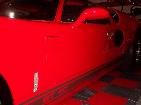

Yes, the carpets are an extra. As to mirrors, I installed the Vitaloni "Sebring" style on my MKI as I thought it was the best looking of the period correct mirrors. They work well - no blind spot at all. The Vitaloni's came in black ABS plastic, which I had intended to paint to match the body color. After installing them though, I may just leave them black. It's a low-key look that goes well with the Titanium/black look of the car. Here's a pic. I'd welcome opinons.

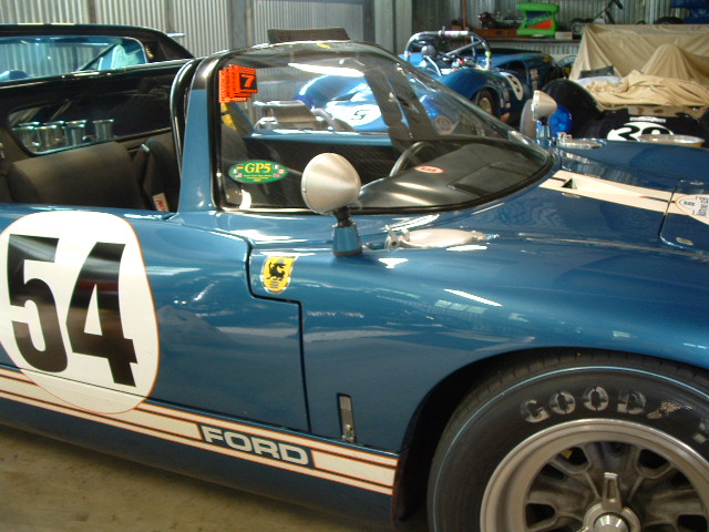

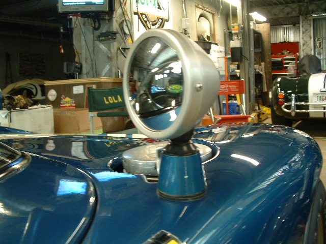

Most period photos that I've seen show these mirrors mounted not where you have them, but rather right on the highest point on the wings, immediately above the front wheels. Here's some photos from the NVSAAC online gallery:
Note that they were all chrome-colored....
For your car, in their current location, I would probably vote for body-colored though.
One of the reasons the race cars had the mirrors placed farther out on the fenders was to get them out of the way during re-fueling. Road cars more often had them closer (see the famous "Would you let your daughter marry a Ford owner" posters) because the closer they are to your eye the wider the field of vision. Ultimately I also felt they would look too prominent way out there over the wheels. But...that's just me.

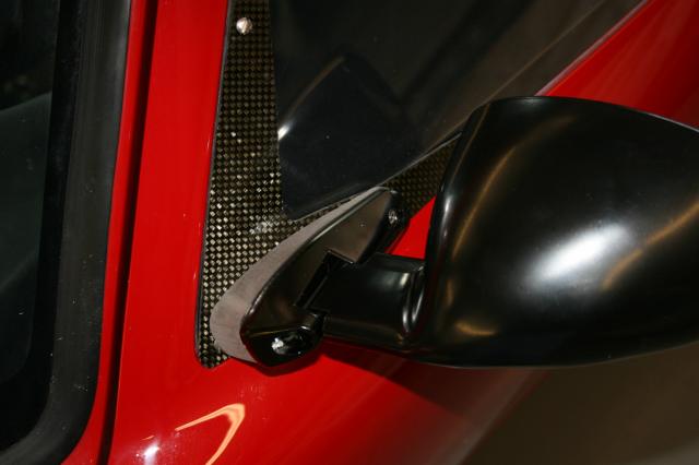

Here are a couple picture of what I did, Mike and I seen these in Monterey last year on car 1083. I bought the same mirrors and after looking at the picture of 1083 again seen they had to cut the mirror to make it function, I just cut some 1 inch acrylic and milled it at an angle till you could have good vision on both sides. I will paint mirrors and mounts to match the car. The carbon fiber bracket will remain the same. Everyone has different taste that is what is great about owning one of these cars.
Daryl,
I noticed today that if we install the mirror on the passenger side parallel with the centerline of the car, I can't see much of the road behind me. I did get a good look of the dachshund on the sidewalk though :) Did you tilt the mirror inwards or did you mount it straight?
The driver side mirror works perfect. Great suggestion!
