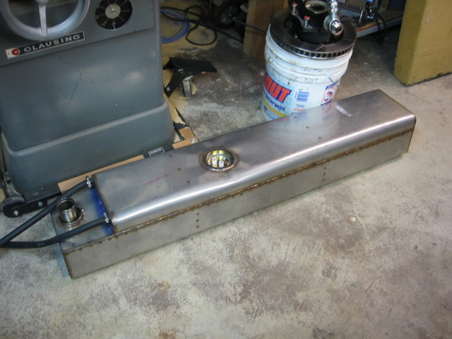

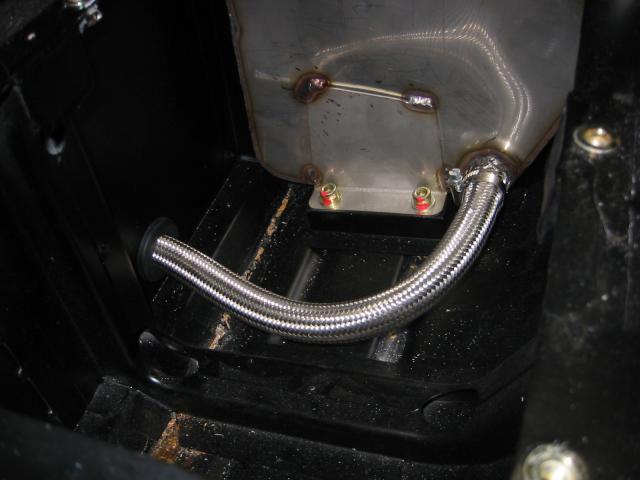

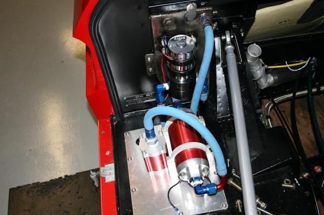

Laurent, I had excessive pressure in the main fuel tanks (the ones we fill up). My system may be different from yours, I have a catch tank (small 3/4 gallon tank) which a low pressure high volume pump feeds, then then high pressure pump for the EFI pulls from the bottom of that small tank and feeds the EFI, also the return from the fuel pressure regulator feeds that small tank, the over flow from the little tank goes into the left side main tank. By removing the rubber seals on the gas caps relieved all the pressure thus preventing the main fuel tank cross over from being pressurized. If you have any questions please feel free to PM me and I will give you my phone number. Here are some photos of the tank and the system I have.

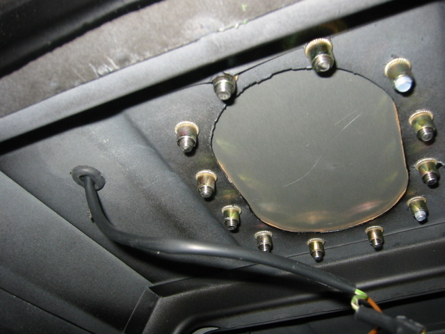

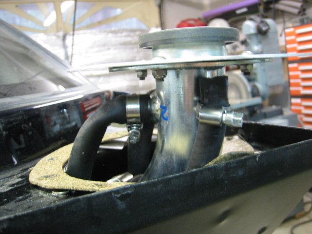

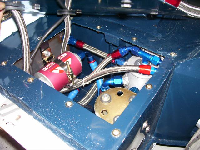

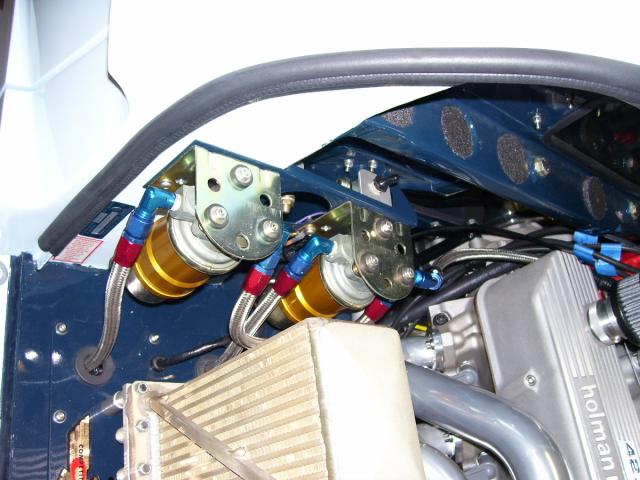

See pics of my install below:
Like Jack I have a catch can (swirl pot) atrangement as I described in post above.
Low pressure HV pump in the left sponsoon pulls fuel out of the left tank through the Canton large filter in pic then into the swirl pot. Pumps on the firewall (can select either pump, have 2 to insure have a back-up) take suction on the swirl pot and supply the carb.
Overflow of the swirl pot (there is always an overflow as the engine demands less volume that the sponsoon pump puts out) goes back into the high return into the left tank and the full swirl pot insures that the engine pump chosen always has fuel available even if the main tanks are low on fuel and car in a down by nose attitude when without the swirlpot the pumps would starve.
Right and left tank equilize through the right to left tank cross connect connecting the lower rear of both tanks.
Although I can fill from only one side (if I allow for a slow fill that the equilizer line can accomodate AND have the opposite cap open to insure a good vent) I perfer to fill 50/50 ie 1/2 load into rt tank the 1/2 load to left as it allows faster fueling.
Never have had the problems you describe now many fill ups and 2,500+ miles.
As you describe assuming your supply and return is to the left tank you must have run that tank dry with out knowing as the fuel gauge is in the right tank and there must either be something preventing flow through the crossconnect line right tank to left (a blockage) or a vacume due to bad gas cap/vent causing a vacume on the right tank that kept that tank full allowing it to warm up during the day and expand to the point that it overpressured and overflowed.
Assuming you have driven the car through a few fill ups has something changed or been changed or have you never run far enough to let the left tank (approx 10 gallons) run dry as it seemingly has in this case. Do you always fill the left tank (if so could always have had this problem and not known) and have you never filled fully up and in climate that would have let change in ambient caused gas in right tank to expand and overflow (in other words you might have had this all along and not noticed and in that case really could be something clogging or a crimp in the crossover line not allowing tanks to equilize.
I still say it's either clogged cross connect or vacume lock.
Let us know.
Regards, Steve P2125

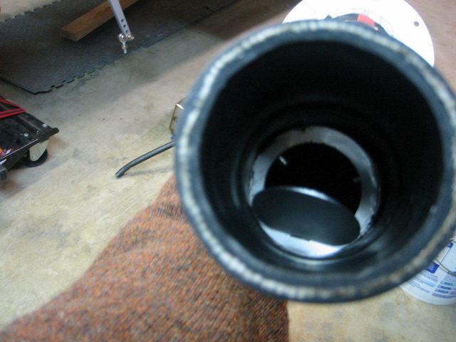

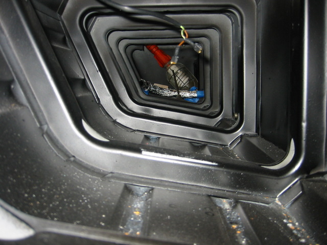

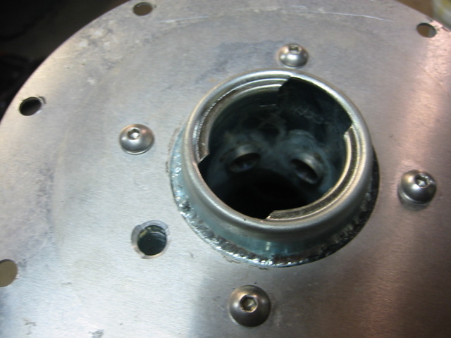

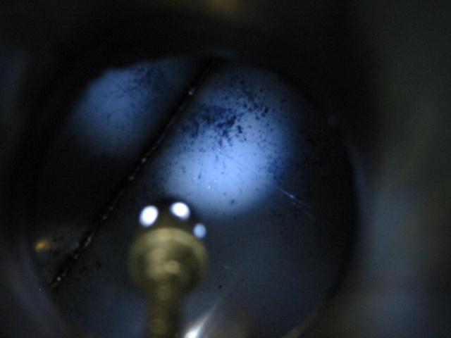

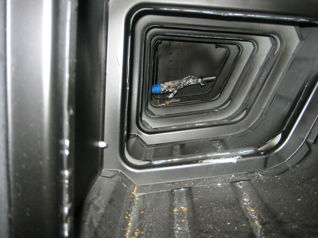

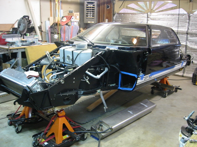

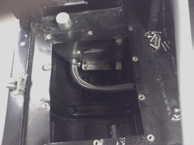

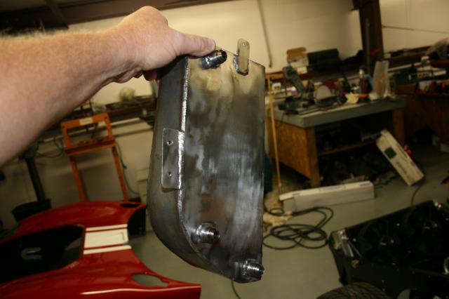

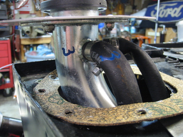

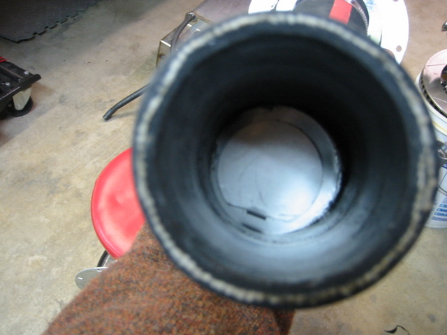

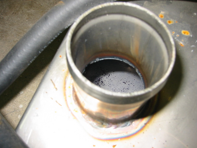

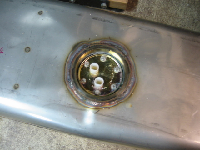

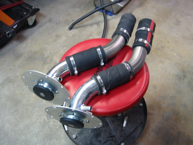

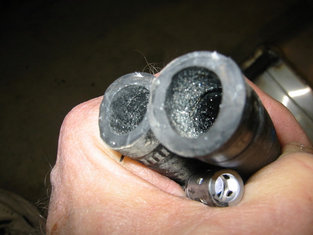

Laurent, as your car is only one number off from mine I would expect our cars have the same fuel system. As Steve stated the rear of the left tank has three connections. The large one at the bottom is the cross connect that runs to the right tank and that is the only connection at the rear of that tank. You can see most of that line as it comes out of the left sponson just below the motor mount, then runs up just in front of the engine and back down and into the bottom of the right sponson again just below the motor mount.
The next line out of the bottom of the left tank is the fuel supply line. It supplies the fuel to the carbs and/or injectors. The final connection comes out near the top of the tank and is the FI return line. All old news I know but as I just pulled the tanks out of my car and I might have some additional information which may help the discussion.
At the front of both tanks there are three connections, the first one is the filler neck but the other two have to be vents. I haven’t had a chance to look inside the tanks yet but I would guess one vents the front and the other vents the rear of the tank. Also of interest is the fact there is a flapper valve about 6” up from the tanks in the filler necks. I suspect in your case that your flapper may be stuck in the closed position, OMG hope that doesn’t hurt, lol. (see photo). The vent lines come up off the front of the tank and go to the top of the filler necks. The one other line in the area is an overflow line that has a hole next to the filler cap and dumps out on the ground.
If your flapper valve is closed surges from the tank either coming up from the filler neck or vent lines would not easily return to the tank. Your left tank may have had the same amount of fuel as the right tank but the filler neck was full from the flapper valve up to the gas cap.
The other thing is since the gas gauge sender is in the middle of the right tank it shouldn’t have shown full. The connection to the sender is just under the oval opening on the top of the sponson in the middle of the door opening so if you’re still having problems you should pull the plate and make sure the wires are still connected. The pictures say it better.
I did find some welding slag in the tanks which is why some of you have had to replace many fuel filters. Also the cad platting on the filler necks does not seem to be of the highest quality as seen by the metal particulates in the vent hoses.

Hi Rich,
I don't think his problem is the flappers (check valves) as they are metal to metal contact not air tight seal used only to prevent heavy sloshing of fuel foreward due to longitudinal tank construction when heavy braking. Also the flapper is top hinged with its mass pulled down by gravity so unlikely stuck anyway (easily checked if he has filled up into the right tank or if he does and the fuel easily flows in).
Vent lines primary purpose is for fueling to insure no air trapped during fueling that would preclude a full tank (note they are UNDER the gas caps).
The gas caps should have a vent feature that allows the tank to not collapse under vacume caused during fuel consumption and during fuel temp change and the cap should also have an overpressure feature for opposite condition (the overpressure feature seems to be working in Laurent's case). Has he changed the caps?
We need more info from Laurent as I questioned in one of my posts above: Is this a new condition, has he filled up both tanks in past without a problem, how far does he go between fill ups, does he only fill the left tank and the refill that tank after he consumes less than the 10 or so gallons it holds and this time did he go further than the left tank would take him causing the fuel starvation he noted cuz the right tank isn't supplying through the crossover, has he ever seen the gas gauge show less than full when he fills up cuz the right tank has never been able to supply through the crossover line, no problems in past and now....if so something is different and we need to know what.
I still think it's either crossover line not allowing equilazation or something wrong with his gas cap vent or both.
Steve P2125
PS...Laurent...Give us more details of your plumbing and specifics as requested and someone might have better answers.

I'm running the original locking gas caps as supplied by SPF w/o problem but, as I noted above the caps have 2 holes drilled through the outer edges and the drill that made those holes also grooved out the metal above the rubber gasket allowing an air passage even if the cap is installed from outside the cap to the vent valve/spring assembly.
Do your caps have these drilled passages? Wonder if they came from the factory like that or Olthoff did a mod?
As I have said before I don't see Laurent's vacume issue nor do I have the pressure issue you had before you removed the gaskets.
Any other SPF owners see either of these issues?
