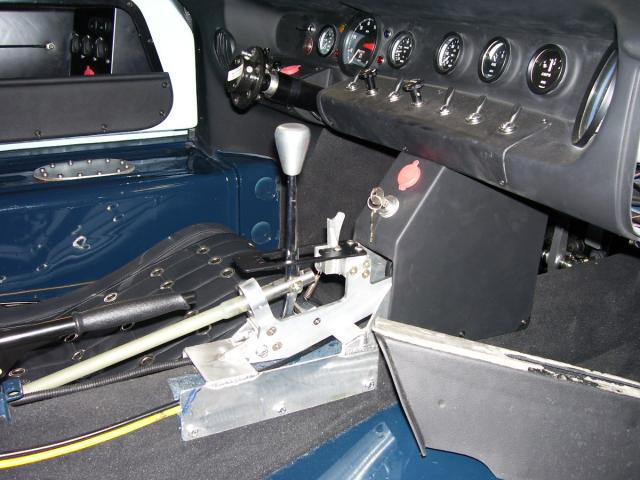

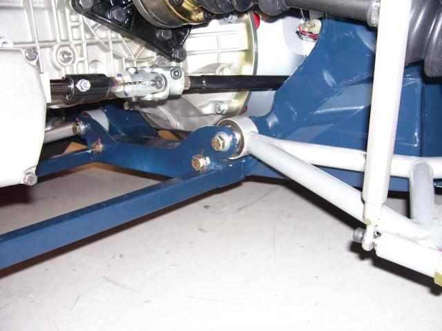

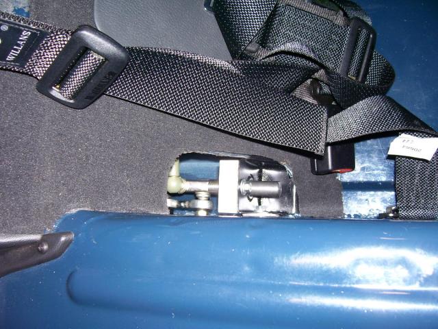

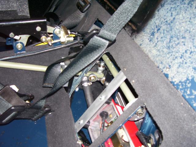

Has anybody placed the shifter on the sill of a LHD? (left hand shifting)?
blueovalz is offline
Old 30th July 2009, 01:00 PM   #8 (permalink)
steve c
Steve
Join Date: Jul 2005
Location: Boston, Ma
GT40: SPF GT40 P2125
Posts: 693
Re: RHD vs LHD differences?
Terry,
See center rod shift as fabricated and installed by Olthoff (works great, has positive feel):
Steve
Steve, firewall photo shows more than I understand. I may contact you offline to gather more information on that portion.
