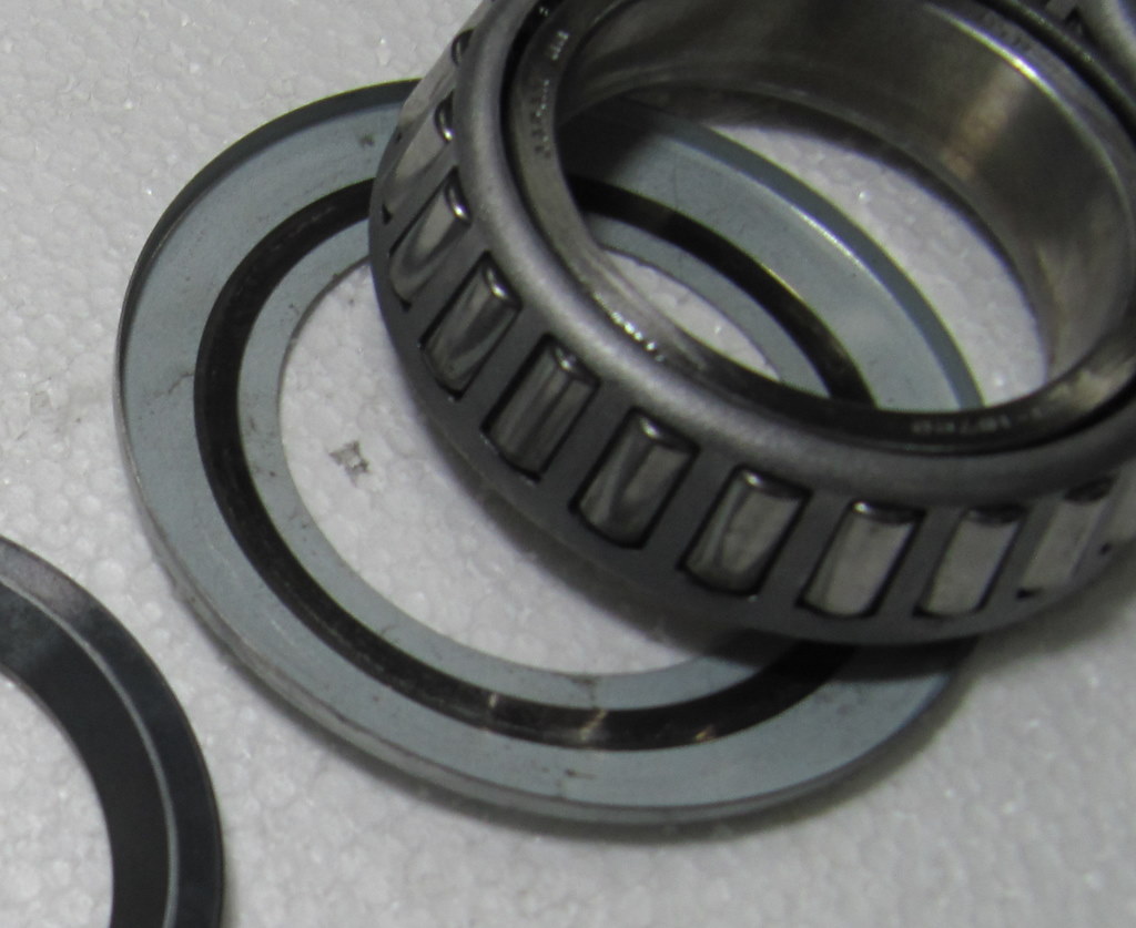

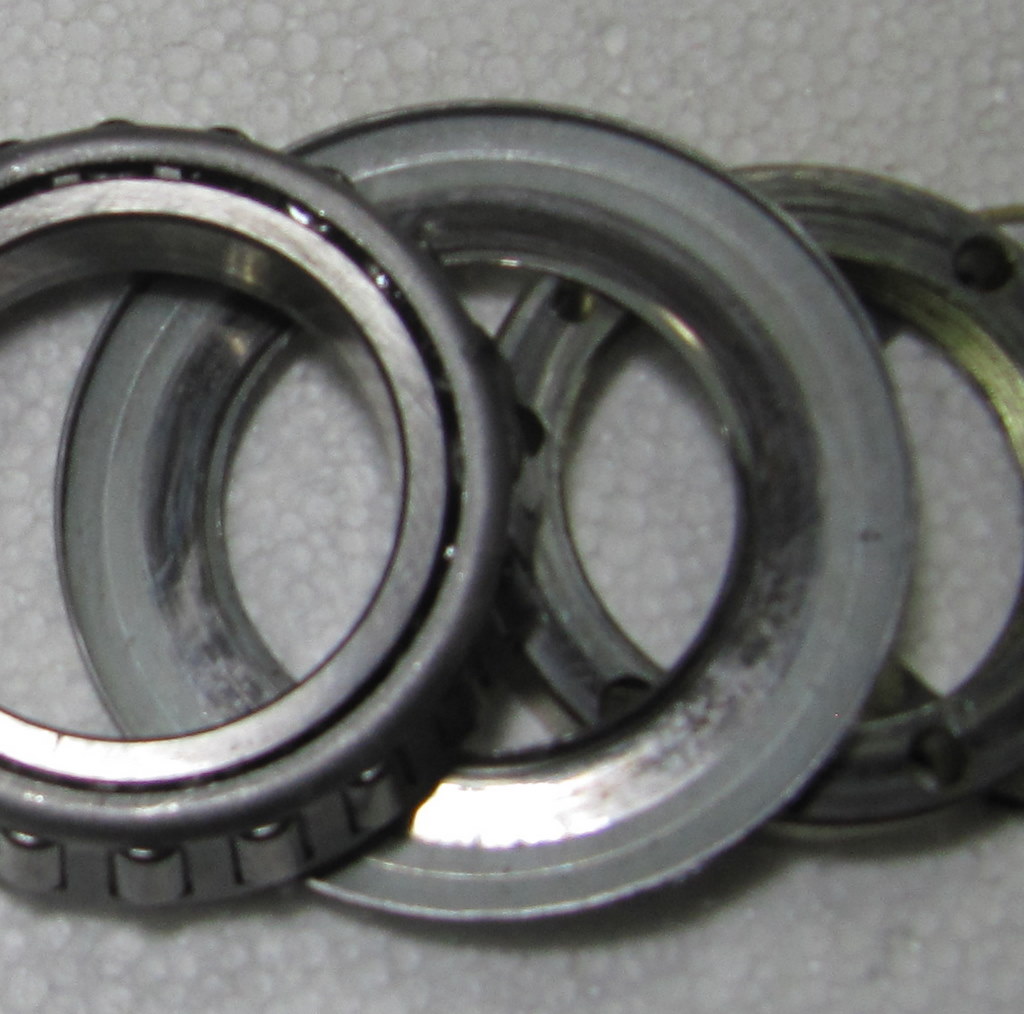

No markings and I don't think they are Niols. They are simply dust shields. I've seen bearing like you're talking about and these are not it. Very crude. I still have one out of the car some I'll see if I can't get a picture of the other side.

Alan, that theory from Nilos is all very well, but if you look closely at the pics in Richards post#70 above its evident from the wear on the inner portion of the nilos seal that it has not been 'clamped' between the bearings & shoulders of the hub/or retaining nut. ie insufficient preload..... this might actually be the source of the 'creaking' sound that I think Richard & Kevin have been trying to pin down as the nilos seal instead of having the OD spin against the outer race as per the literature, it is virtually 'locked' there @ the OD & spinning on the shaft...... again converting to a solid spacer between the bearings would make the 'nilos seal work as intended, might not be what SPF designed/copied, but seems the logical way to an immediate fix, albeit for all the extra hassle I would rather run a 'proper seal'.

.... this might actually be the source of the 'creaking' sound that I think Richard & Kevin have been trying to pin down as the nilos seal instead of having the OD spin against the outer race as per the literature, .
Interesting. Of the two variants intended for use with tapered bearings the AK versions has "nibs" intended to interlock with the locking ring to prevent rotation. However I see no evidence of that in Richard's pictures so we probably have type AV. I don't quite understand how that version is guaranteed to spin, because the catalog makes it quite clear that you are allowed to have play and the whole system works. I suppose they could think the friction between locking ring and ID of the seal is guaranteed to be greater than that between outer edge and outer race. So yes, I'm mystified and this could easily be the source of some noise, not to mention ineffective sealing.
The catalog is located at http://www2.nilos-ring.de/DWD/_11132...media_4190.pdf and the discussion of mounting AV and AK seals is on page 17. I'd love to hear anyone elses insight into how this seal is supposed to work with tapered bearings that do not use a center spacer and high locking torque.
If I had mine apart today I'd be tempted to replace the seals and take some measure to guarantee they rotate with the axle, although I'm not sure what that would be; probably a dimple in seal and locking ring, or switch to type AK. Or install a center spacer.
OTOH if you look at the picture of Richard's outer race (http://www.gt40s.com/forum/attachmen...3&d=1309324110), there does seem to be a nice neat groove carved into the race, right where I would expect the seal to create it, although somewhat obscured by all the silver stuff (anti-seize?)
