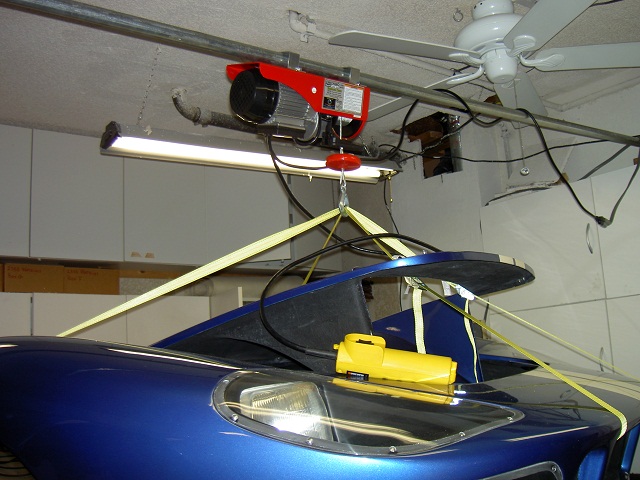

Just guessing I would say around 75-100lbs. I have no one to help me so I have to use redneck engineering to do all these sort of things. To get the clip off I use the engine hoist and cotton shipping straps(tie down straps). mounted through the wheel wells and lined up between the rear window and the top exhaust vent. You will find the median point where all is balanced. Just go slow and adjust the straps as the clip begins to lift. If you have enough straps, you can tie off the front/rear so that it doesn't tip so much. Pull the straps tight as you can. The straps will stretch some and you may have to pad your hoist to keep the rear from bumping as you pull away from the body over any protruding surfaces. I have rear coolers so that increases the height. I also have the car mounted on a jack stand to keep from having to bend over so much. You don't want to know the tricks I used to get the spider and frame so I could do horizontal TIG welding on vertical surfaces.

FWIW here's my electric-Redneck version of Bill's solution to solo R&R-ing the clips: two $80 Harbor Freight electric hoists sliding on an 18' long pipe so I can shuttle the clips forward and back (i.e. out of the way) as needed without taking up valuable floor space.

With a little preparation an engine hoist works very well. I used some lifting straps from Harbor Freight threaded through the carburetor cold air intakes. It balances very well and is a straight lift to remove it from the car (don't forget to unplug the tail light wiring). If you have the room just leave it on the hoist with some padding, if you don't transfer it to a hook hung from the ceiling otherwise you have to deal with banging it into the legs of the hoist when you put it down and pick it back up. You can ask me how I know but then I would have to lie.
