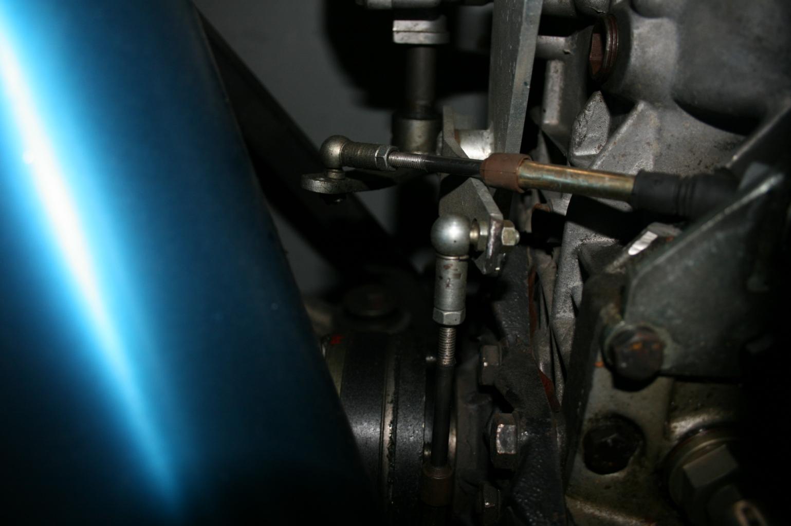

I speak a different language most the time, sorry.... I meant to say re-drill the levelers. Here is a picture of my car set up, sorry for the dirt, I drive mine.
