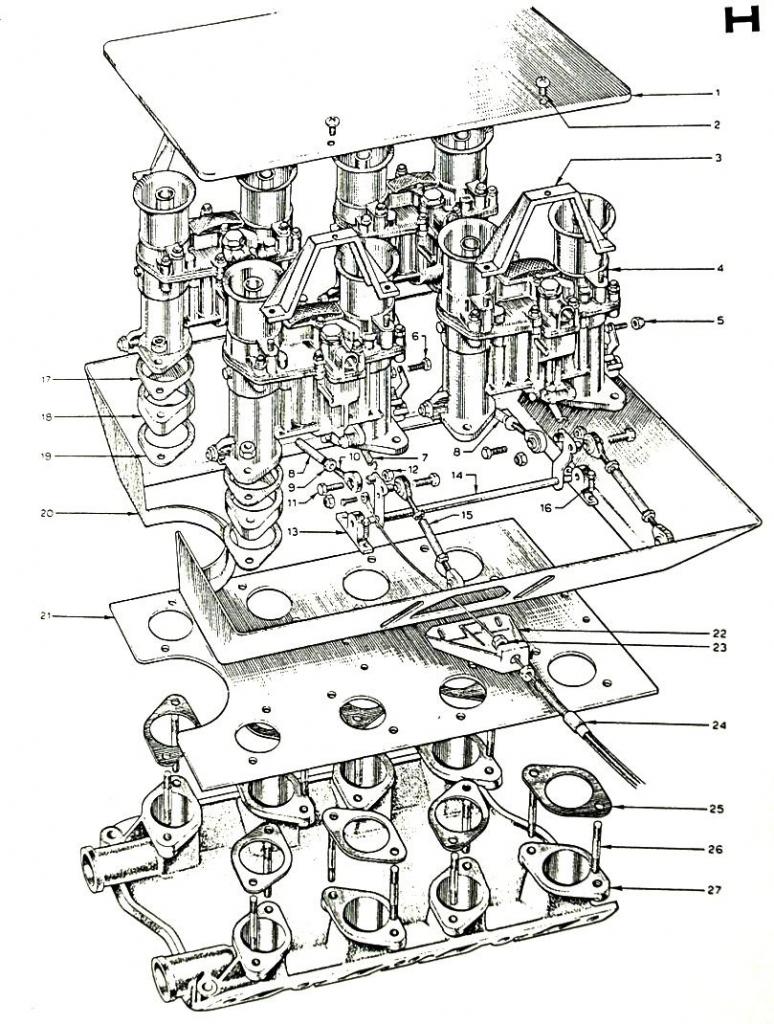

What do you think would be the easiest-to-obtain "from the era" documentation that one could show to a BAR official to illustrate the point?
Ron --
Regarding the weber carb issue, if you could show that at least one GT40 Mk I was registered or was registerable in CA in the day, then a page from the FAV parts book should suffice, eg
