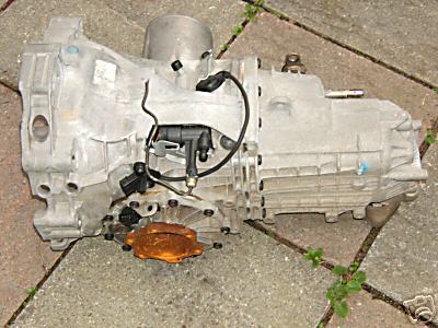

hi there was wondering if anyone coulkd tell me by looking which audi trans this is and if it would be suitasle to match up to a 1uzfe lex v8

That looks to be an Audi model 012 5 speed as used on all (USA) late front drive Audi/VW's except TT & Beetle. I'm not sure what a "1uzfe lex v8" is. This transaxle has the same bellhousing bolt pattern as the Audi model 01E.

Does anyone know how the 012 compares in strength to the 016? The 012 should be more plentiful and maybe cheaper if they would be suitable.

Hi Andy, The box you are looking at is a 012 from a audi a4 1781cc and produces 110 kw the bolt pattern is the same as the 016, depending on the weight of your car , i would go with an 016 if you can find it, they came in the audi 5000 in the USA or audi 100, i have pictures of my setup which is a 016 to Lexus 1uz can attach pictures if it helps, have a look here so you know what an 016 looks like. Trans 5000 Audi - Lambo Lounge and Audi Shifter - Lambo Lounge

AFAIK, the 012 has the same bell housing bolt pattern as the model 01E, not the 016.
Andy, I don't recognize that number you posted. The part number and code will be stamped at the bottom adjacent to the differential side cover (on the drivers side). It should read 012 XXX XXX XXX, with the last three places being the lettter code. Though it doesn't appear in the photo, there is often a label with the part number on top of the housing which rarely stays affixed.
Is this transaxle from a USA vehicle?

Hi Andy, My mistake i have an 013 and a 016 and the bellhousing pattern looks the same, if you go to this site it lists just about every gearbox that Audi have ever made, maybe one on our German members can decode the non english bits for us, but your code letters do appear in the listing, this list may be of help to others also looking for codes. Zuordnung Fahrzeug, MKB, GKB, AKB, MJ

thanks for the help fellas the box is a uk one believe it or not im realy having trouble finding an 016 as the audi 100 hasnt been around for a while now anyone know what other models they were in such as audi 80 etc

The Audi 80 was an 012 box, and as you say the Audi 100 is like hens teeth to find now.
The other box to go for would be the 01E fitted to the Audi A8. It comes in six speed and is quite a strong box, so I have been told. For more info on the different Audi boxes fitted try: Online spareparts catalogue for AUDI/Volkswagen/Skoda/Seat
