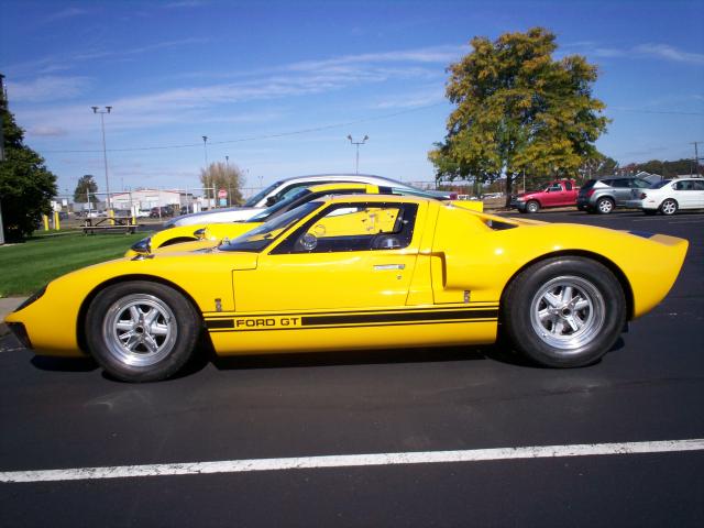

I was blasting around the western Massachusetts hills today and had to stop for something cold & refreshing, when I got this idea for a picture.
I think it look good so I thought I'd share it...
I have yet to weigh the car so I can get accurate performance data from my G-TECH.
When I do I'll post it
Cheers,
Scott

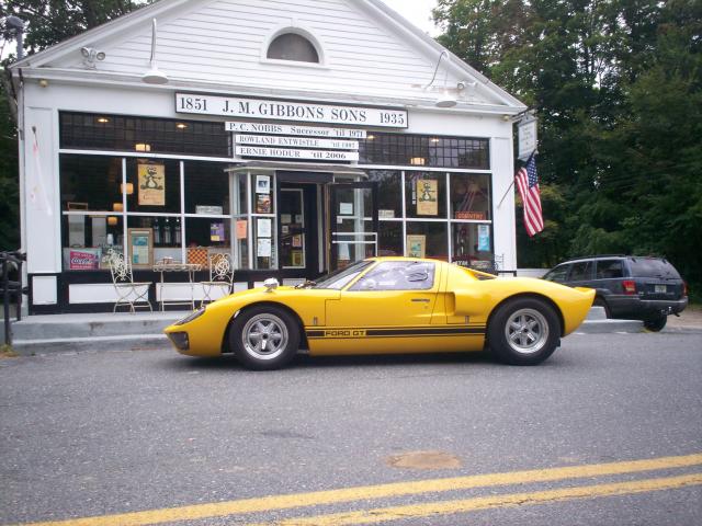

Nice photo, I think we need to get a camera truck and film 875 going through the twisties of New England. That would be AWESOME !!!!!!!!!
Spikelp is offline
Old 09-16-08, 09:17 PM   #287 (permalink)
Scott Calabro's Avatar
Scott Calabro
Supporting Vendor
Join Date: Oct 2006
Location: New England
GT40: TS40 # 875
Posts: 874
Rep Power: 12 Scott Calabro is a splendid one to behold
Re: Tornado TS40 #875
Thanks Spike.
You are going to need one hell of a fast camera truck!!!!!!!
Here is another...
S

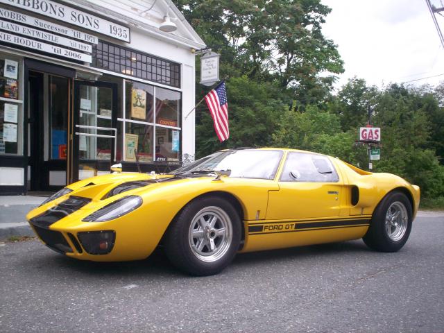

Took a few more pictures today of a couple of "Gentlemans Toys"
Cheers,
Scott

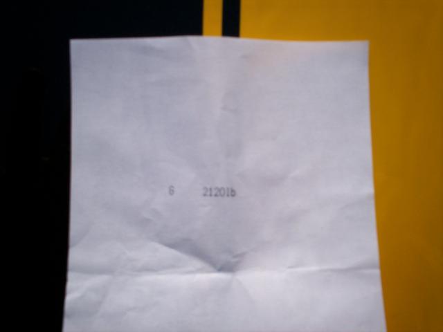

Well some more great news for Tornado TS40 owners, I had TS40 #875 weighed today on a Massachusetts state certified truck scale today.
Its accuracy is guaranteed to be within +/- 20lbs.
The car had a full fuel load on board (19 US gallons or approximately 117 lb fuel load)
It is outfitted as follows;
1). 1.75" Exhaust headers
2). Foam filled fuel tanks
3). Wilwood brakes (with integral p brake)
4). Engine oil cooler
5). Dual fuel pumps and filters
6). Single vent front hatch
7). Chrome plated wishbones and suspension links
8). Helicopter vents
9). Front and rear anti roll bars
10). US DOT APPROVED 15" Silver BRM knock off wheels
11). Weber 44 IDF 71's
12). Alloy cyl. heads
13). Alloy water pump
14). Alloy shocks
15). Alloy radiator
16). Rear bulkhead braces
17). Original type curved headlights
18). 3lb Dry Chem hand held fire bottle.
Attached is a picture of the weight printout
2120 - 117 = 2003 lbs
Or for my Metric friends, 908.55 Kg.
For those interested, our new Carbon Fiber chassied TS40 with the same build spec will be around 300 lbs lighter
I will post some G-Tech data soon.

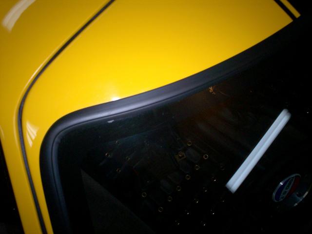

Windshield molding... Hmmm... Available to non-Tornado owners? Price?
Loved the entire build - the car is a lot lighter than I anticipated!
Regards - Randy
Big-Foot is online now
Old 10-01-08, 08:38 PM   #295 (permalink)
Scott Calabro
Supporting Vendor
Join Date: Oct 2006
GT40: TS40 # 875
Posts: 874
Hi Big Foot,
Glad you enjoyed 875's build log, I think I'm going to have to install tie-downs in my garage floor for when a Carbon TS40 kit shows up!
You can easily purchase a seal from your local auto glass installer.

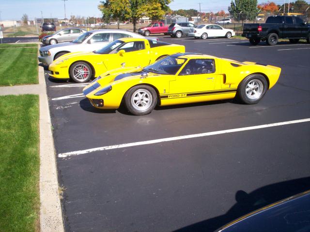

Two shots of 875 next to its arch rival........
