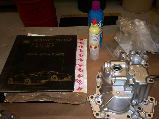

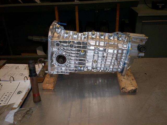

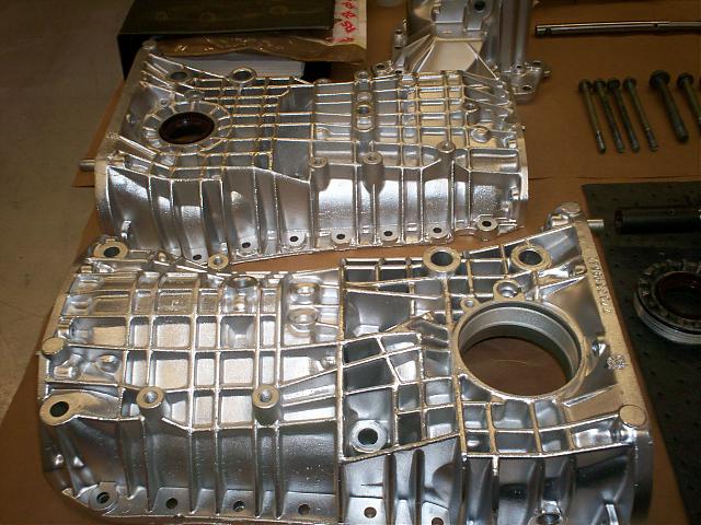

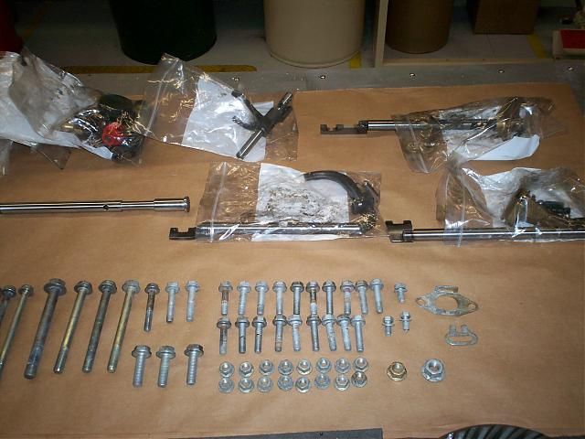

Phil ... The rear brake calipers will have a cable actuated mechanisim for applying the P-brake. That is all I know right now.

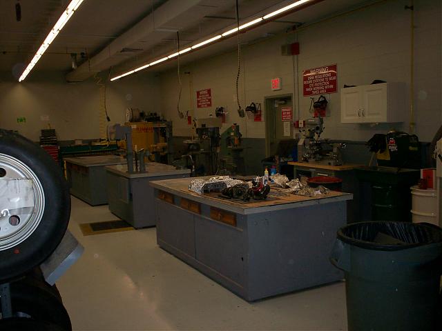

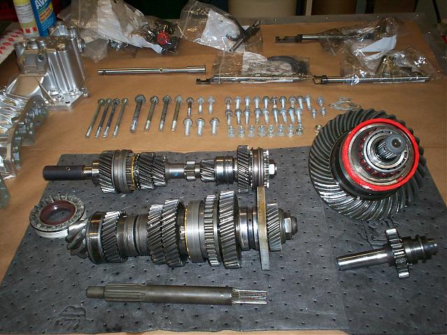

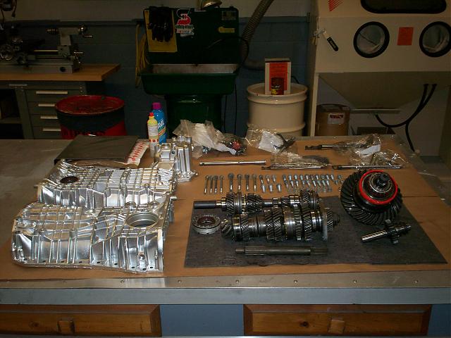

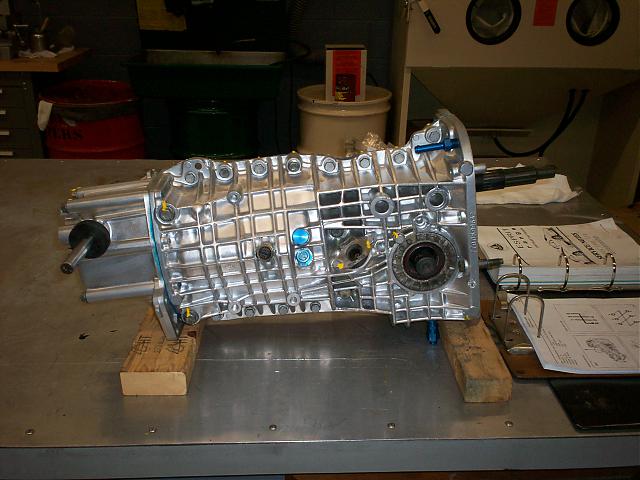

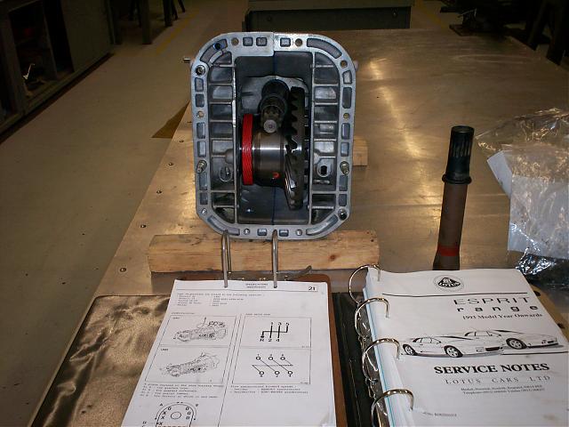

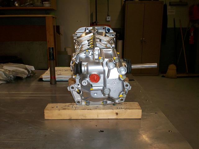

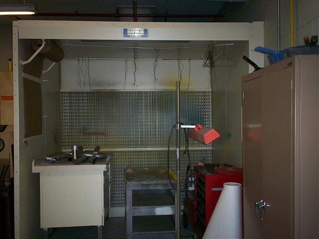

Here are some pictures of the shop and the UN1, after bead blast, water rinse, etch, alodine, epoxy prime and paint.
The case is from a -26 (Lotus Espirit, heavier case rib's around the ring & pinion, more aluminum at the 5th gear bearing support. Plus the shifter mechanisim inside the tail is improved over the -13).
The lower gearset and R&P are both UN1-13 piece's.
The gearsets were both very low mileage and in pristine condition. New O-rings, seals and gaskets have been used exclusively.
Kind of the best of both worlds.
Soon I'll post some 289 pic's at the engine shop.

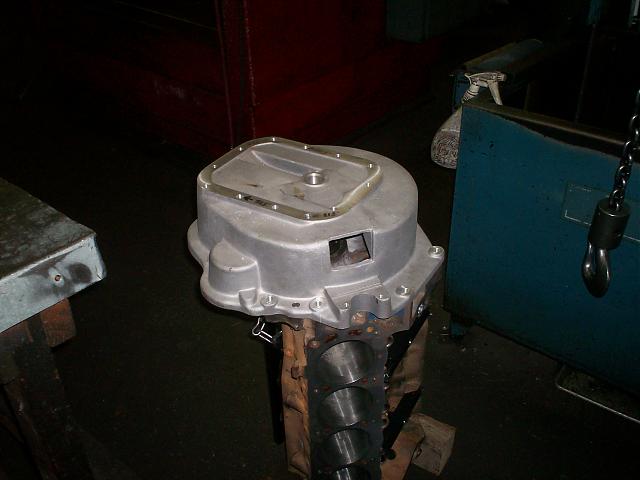

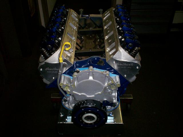

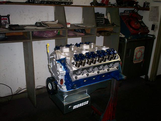

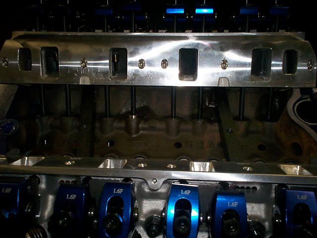

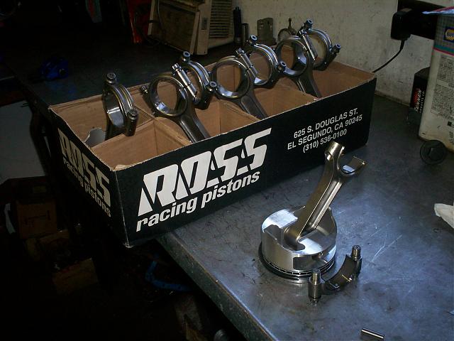

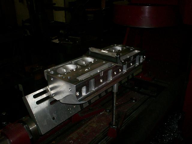

A few more pictures.....

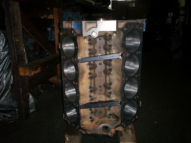

Bell housing index
Cyl. head setup for .050" flat mill
Completed UN1-26 with 3.44 F/D
Ross pistons & Probe 5.4" 513 gram rods.
Sorry for the poor picture exposure.
Scott

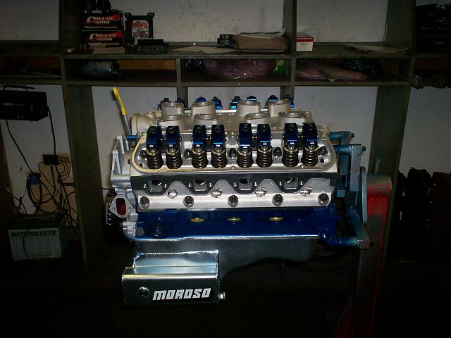

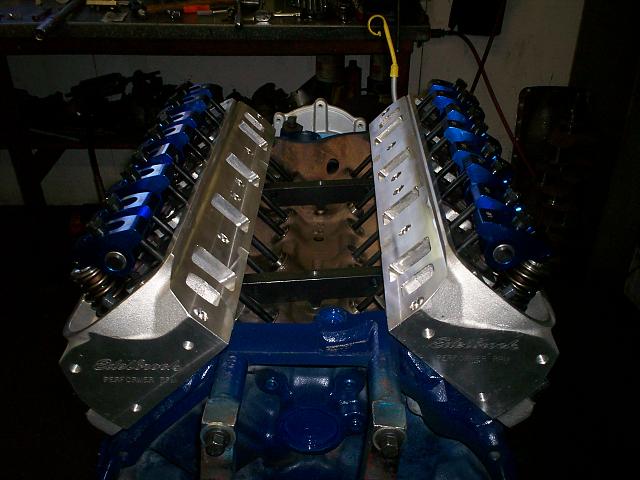

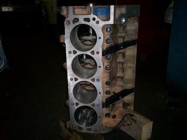

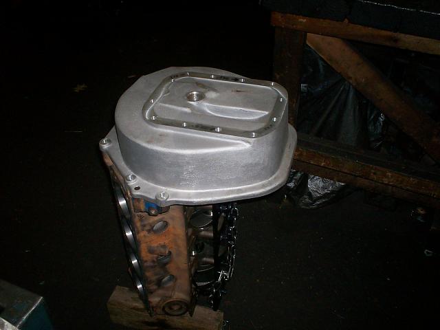

Long block pictures ...
Cheers,
S

Question Re: Tornado TS40 #875
Not using any stand pipes in the valley drains to cut down on windage Scott?
Jac Mac

Jac Mac,
I was not aware that valley standpipes were available for the SBF .
Do you have a mfg. & P/N?
Scott

No this has a Diykiwi prefix- Ford drill those holes to 0.500" which precludes using stuff destined for that 'other' brand. I usually just break the guts out of 4 old 14mm spark plugs, cut the thread down so they dont protrude into the cam cavity & press /easyflo a piece of thinwall tube into the plug body. To tap those holes to 14mm turn the block assy upside down while on the engine stand and apply some grease to the tap.( You can stamp em pn#SCM001.). You did do the CC ' Louie' mod to the lifter bores did you not?
You might also want to consider stand pipes in the corner drains of your alloy heads to raise the (running) oil level up to the base of the stem seals. Drill a small 0.050" hole in the alloy tube where it enters the head drilling so that oil can drain after shut down.

Ahhhhh..... Kiwi thinking!
Good idea on the fabrication, I am concerned though that with standpipes, under heavy braking oil will not retun to the pan so well as no drains are in the front of the valley. I'll ask the engine guy, but I know what he'll say.... "You said you only wanted 300-350 HP, why the hell are you concerned with valley pipes"
The lifter bores were checked for index/bore, I'm not sure what the "CC LOUIE" mod is !!!!
Clue me in.
