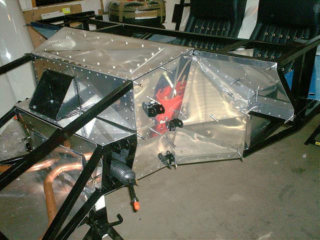

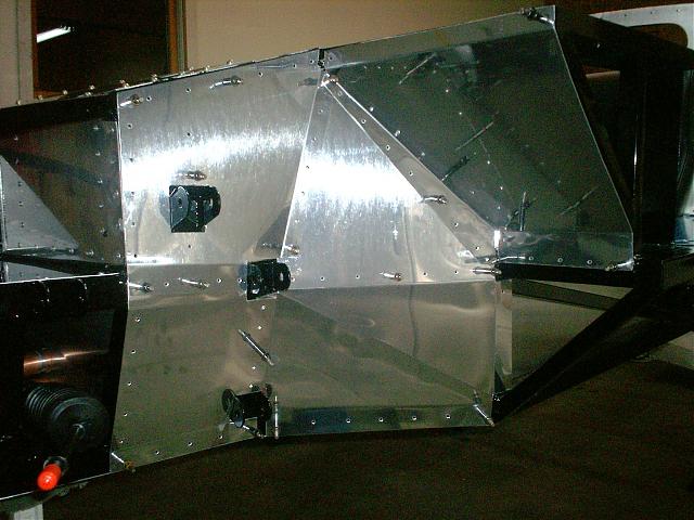

Not much this evening, just drilled the left front wheel arch.
S

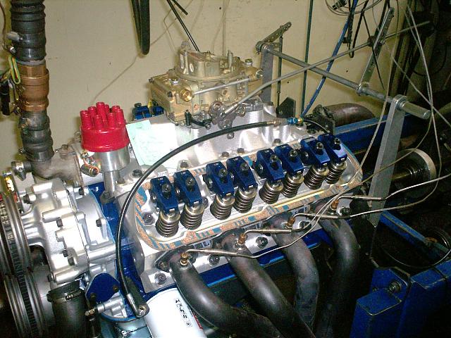

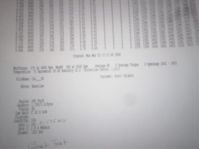

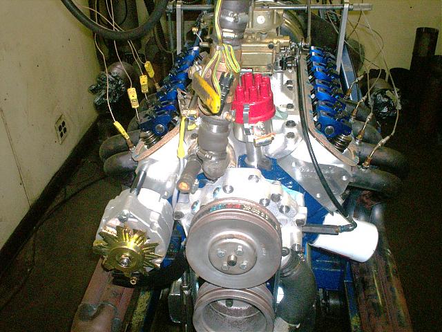

Today the engine runs went very well.
My 289 developed 395hp & 355tq !
All from the "little" Holman Moody C30Z cam & 11-1 C/R, & Eddie heads.
This was with the 180 deg high rise and 600cfm holley.
The pictures show this setup on the inertia dyno.
We went on later to install the 44IDF's, and made a best of 384hp @ 6500 rpm & 375tq @ 4800 rpm.
The Webers really ran best overall, as the time from 3500 rpm to 6900 rpm was just over 1 sec faster with the Webers.
The engine shop is in Simsbury CT, THEY ARE A FANTASTIC SHOP!
Thanks to Norm, Dave & Chris!
