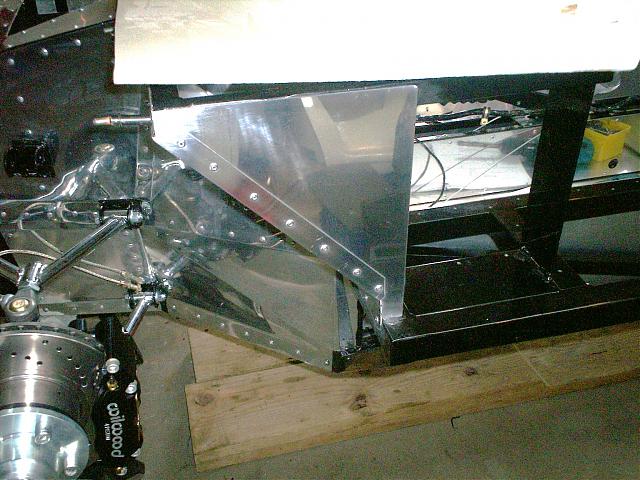

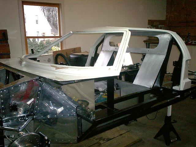

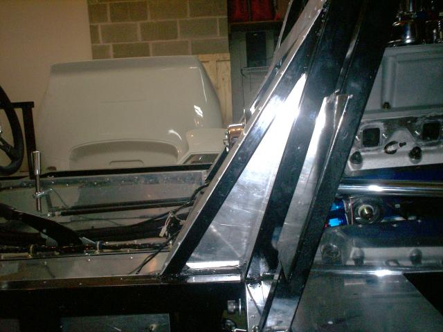

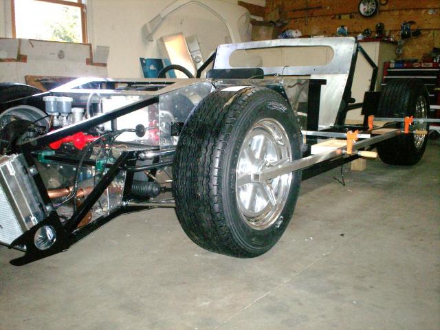

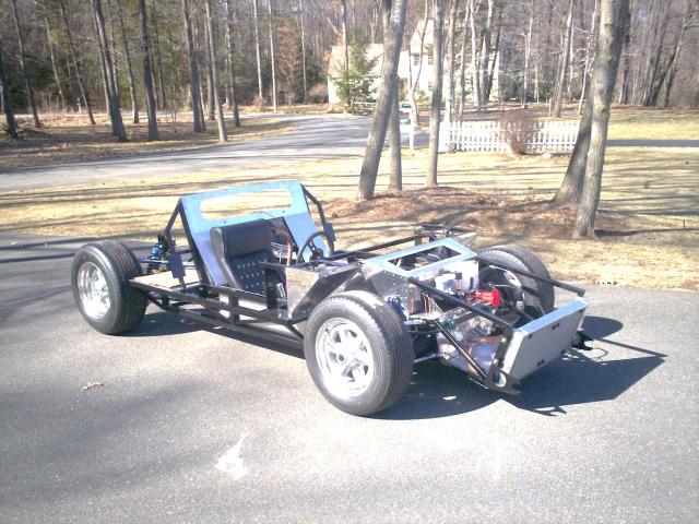

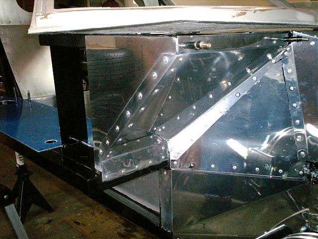

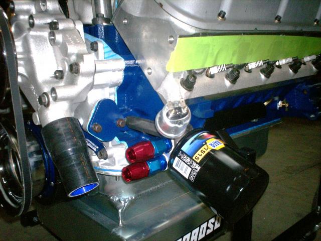

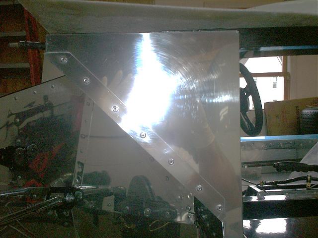

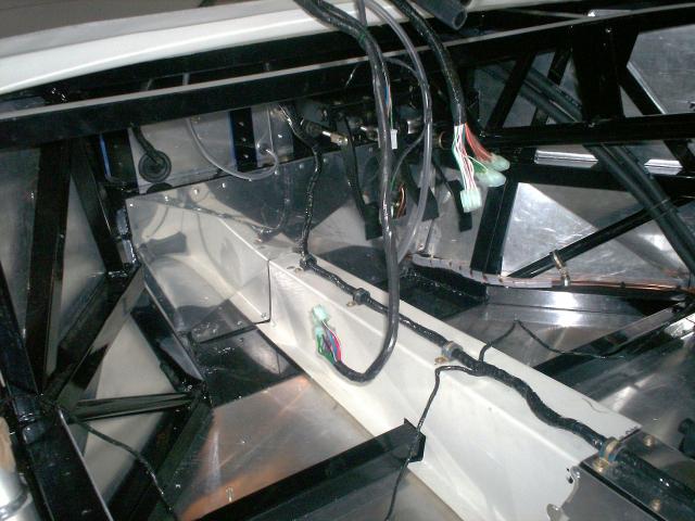

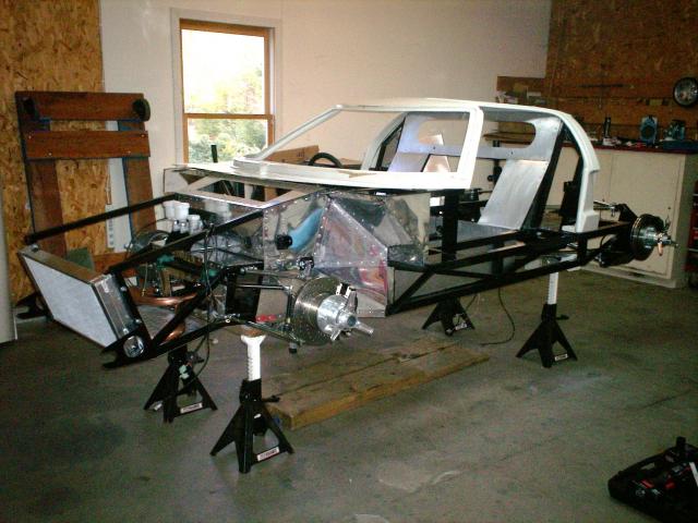

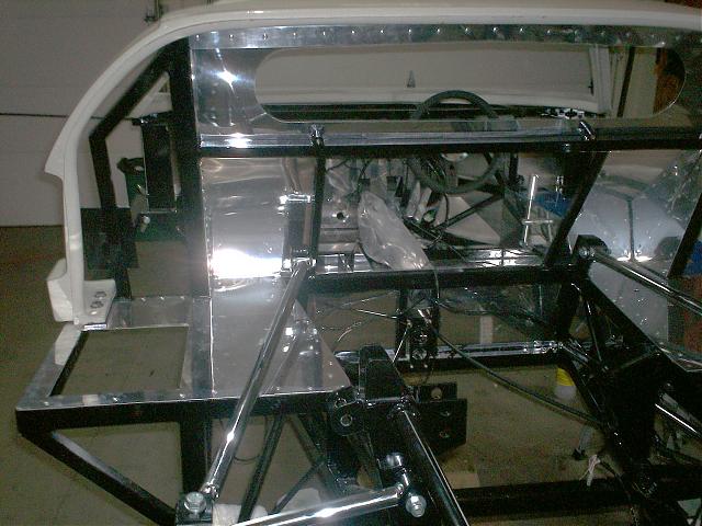

Most recent work;
Installed both dash frame side panels.
Started installing the roof spider.
Cheers,
S

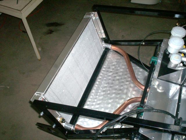

Hi John,
The pre cut alloy panel blanks are supplied mirror polished on one side from Tornado Sports Cars.
To keep them looking good I will use "Never Dull".
Todays accomplishments;
Mocked up the 100% alloy radiator for attach holes and fitment.
Installed the rear wilwoods on both sides.
S

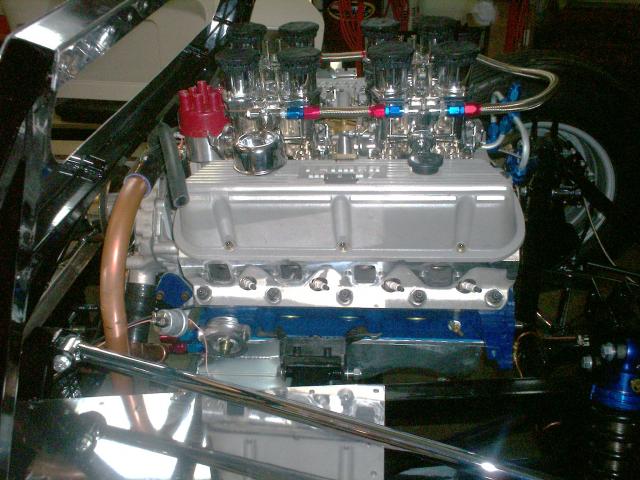

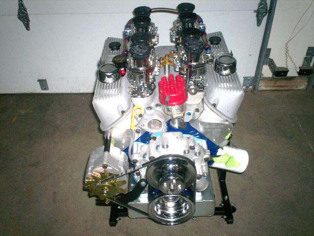

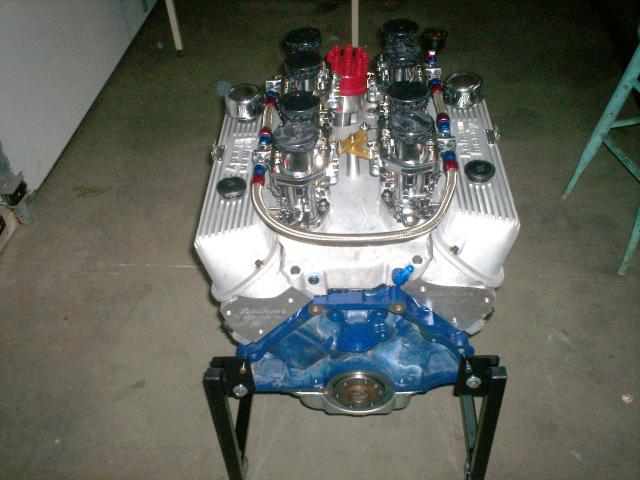

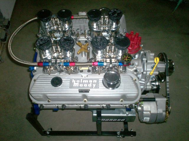

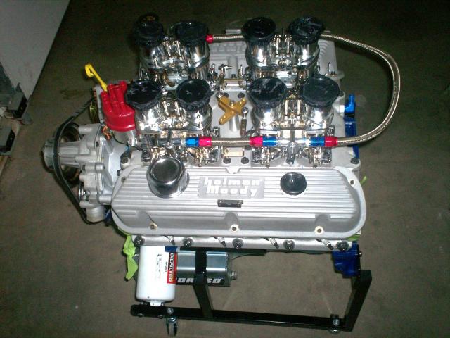

Picked up my engine from the shop today after the valve cover mods were completed and the pulleys were installed.
S

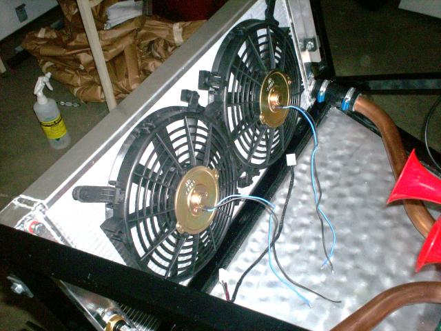

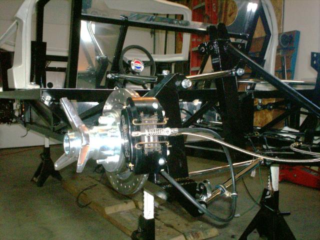

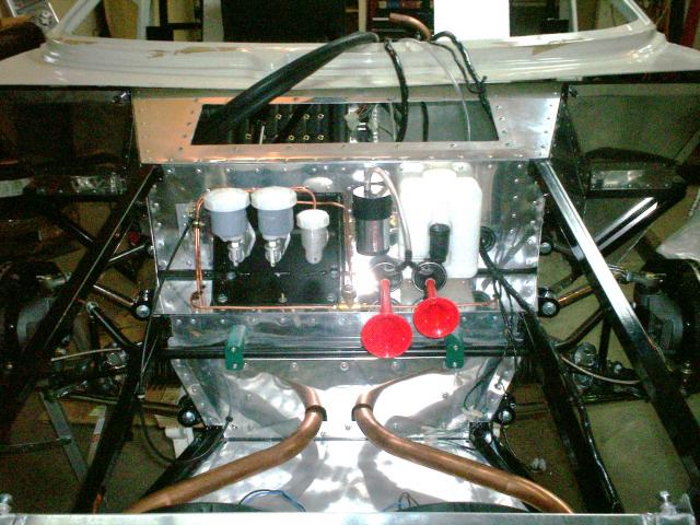

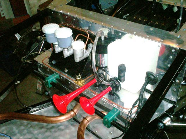

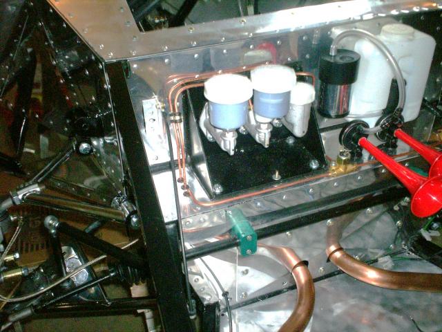

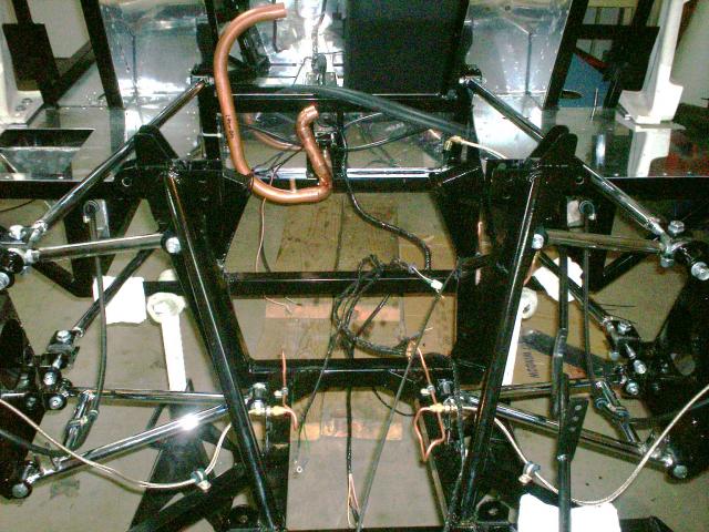

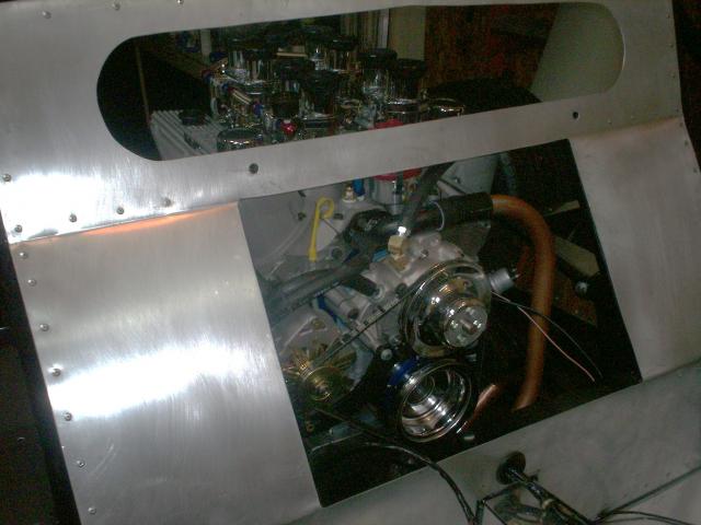

The last few days activities ...
Installed the electric cooling fans.
Installed the windshield washer fluid bottle.
Installed the air horn compressor.
Installed all the brake lines and bled the front and rear systems.
Finished the hand brake rigging.
Finished the engine front dress.
Later this evening I will install the heater/demister.

Scott -
May I ask how the fans are mounted? The reason I ask is if they are mounted using plastic ties that run through the radiator fins I strongly recommend using a different mounting method. With the vibrations associated with running the car the ties tend to wear through the fins causing small leaks in the radiator (ask me how I know). If the fans are just set in place for the photo then no worries.

Hi Dave,
The fans are mounted on the black crossmember running beneath them.

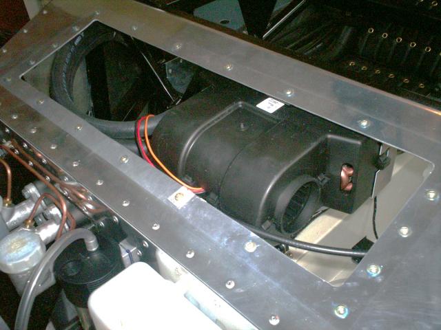

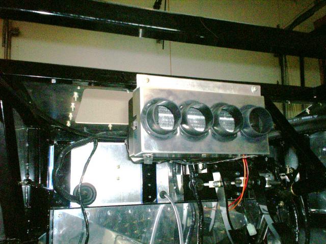

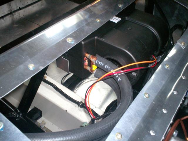

Mounted the heater/demister.
Installed the speedo cable.
Installed the wheels for wheel alignment tomorrow.
Installed the engine oil cooler adapter.
Tomorrow I will wheel the car outside and turn it around for the engine installation.
S

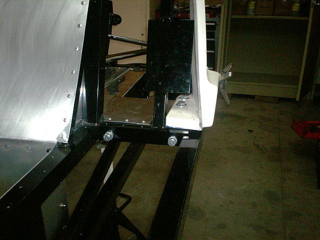

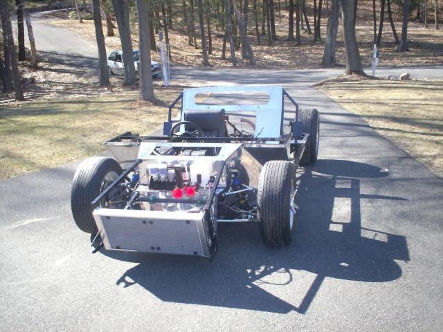

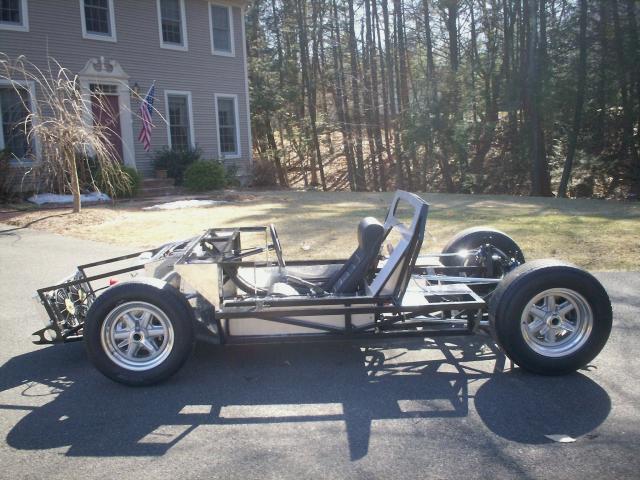

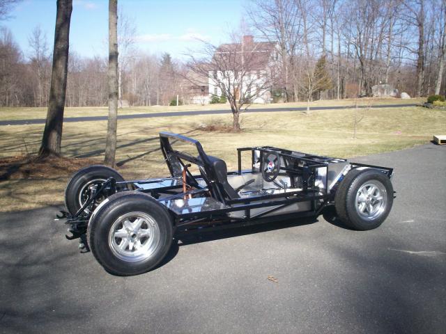

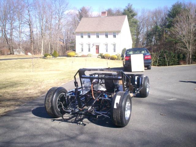

Today I put the car down onto blocks at ride height and set the wheel alignment.
Then I installed the coil-overs and rolled it outside to turn it around for next weeks engine install.
All this in just 50 days.

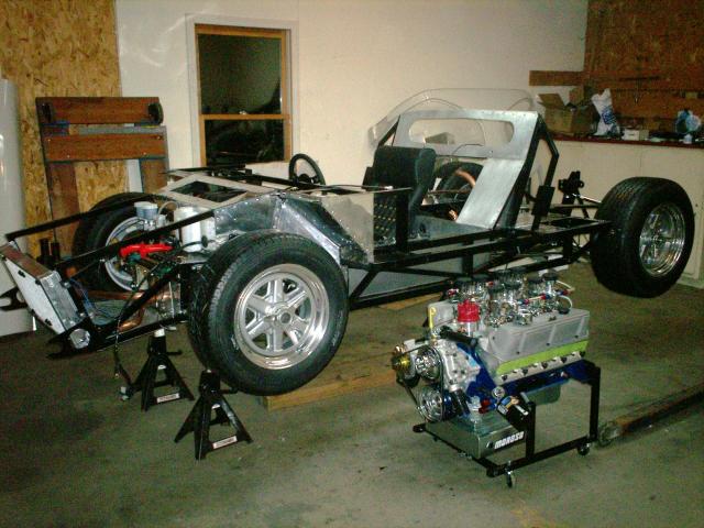

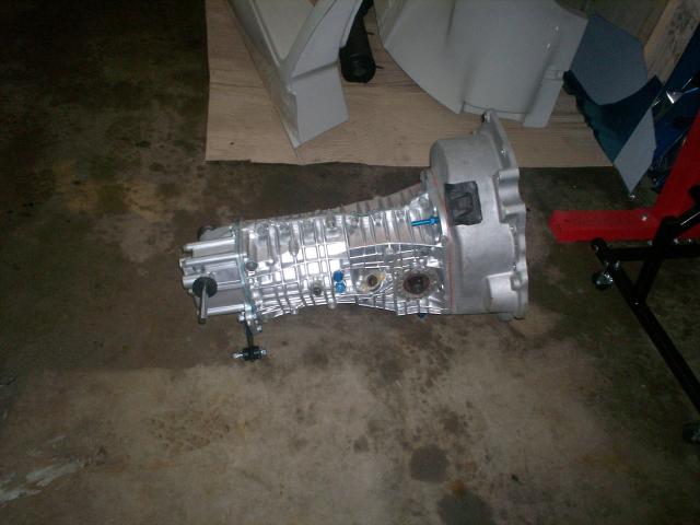

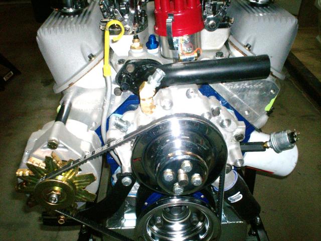

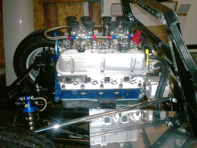

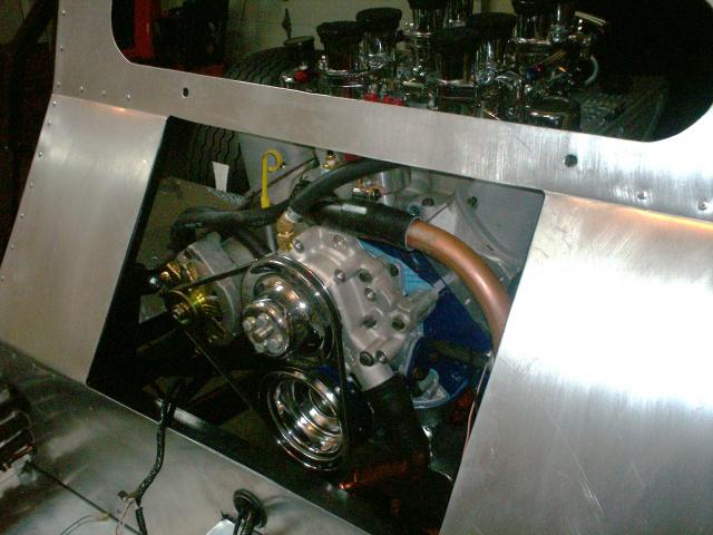

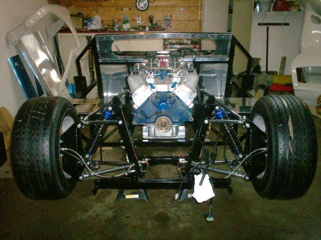

Today the engine was installed.
Later this week the clutch and the UN1-26 with 3.44 F/D.
S
