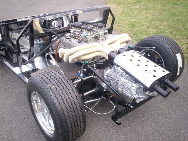

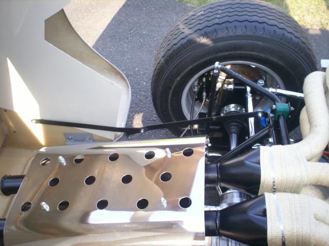

Re: Tornado TS40 #875

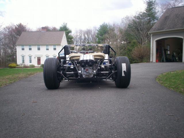

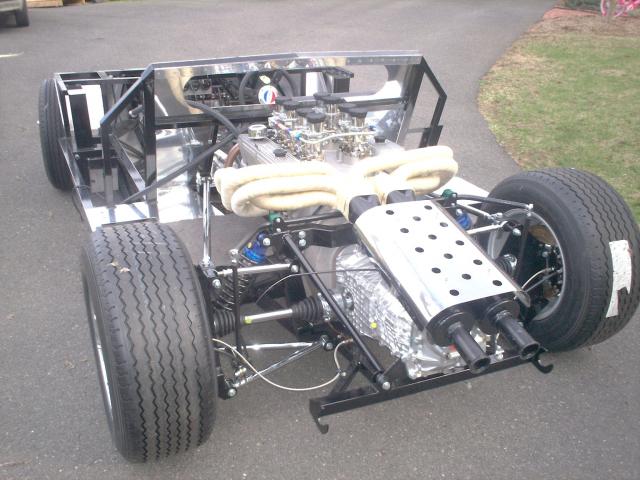

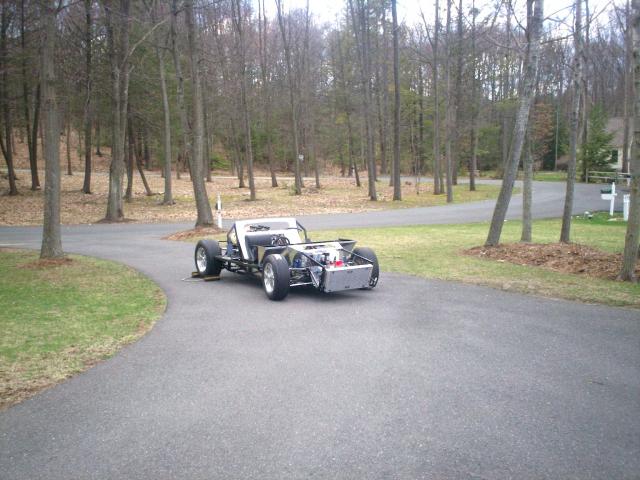

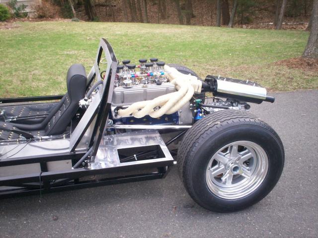

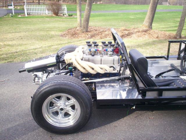

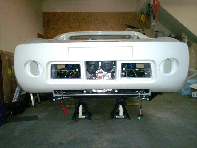

Its been a few days since my last update.
Here is what has been accomplished;
Installed the flywheel and clutch assy.
Installed the bellhousing and transaxle.
Installed the clutch slave cly. and bled system.
Installed the starter motor.
Installed the rod type shifter linkage, I must say its quite positive and slick with a very short throw.
Installed the half shafts.
Installed the exhaust system.
Pressure tested the cooling system, to ensure no leaks before engine coolant fill and subsequent start.
Almost ready for body work
Cheers,
S

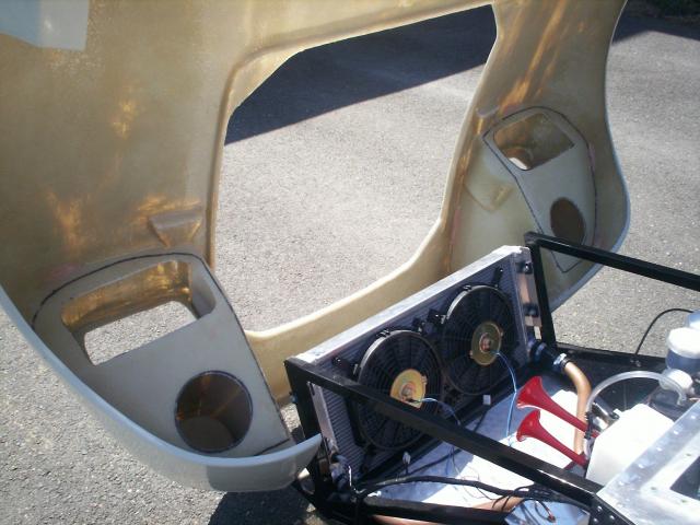

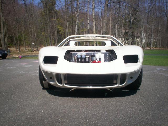

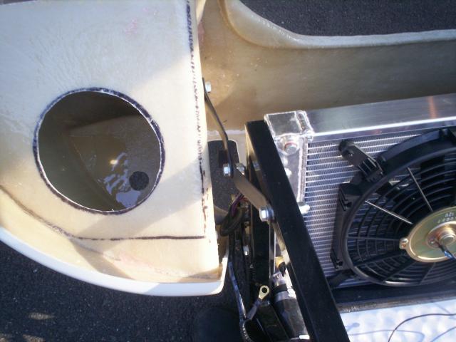

OK the last couple of days....
Cut out all the holes in the GRP body parts
Started Installing the rear clip
Tommorrow the spider front apron
Cheers,
S

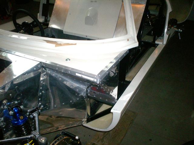

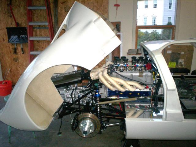

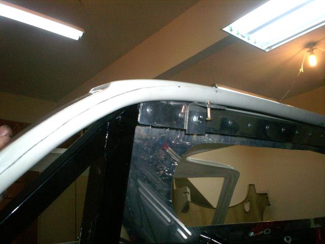

Tonight an important step in a Tornado build, aligning the roof spider.
Doors have been rough trimmed, the winshield dropped in for fit then the front apron can be trimmed, then riveted and bolted down.
Also installed the spider to rear clip, gap adjustment stops. These have been just rough installed as they get finished adjusted/trimmed during paint.
Tomorrow installation of the wiper motor/drive setup and installation of the front clip and hinge system.
69 Days.

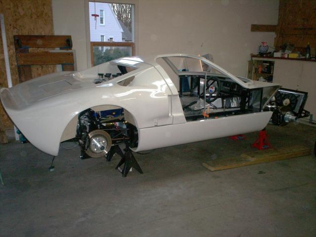

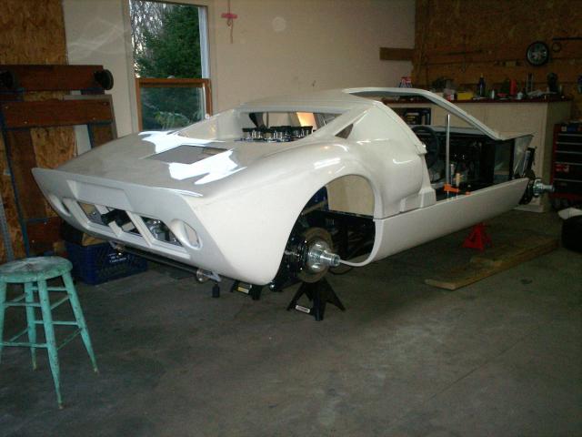

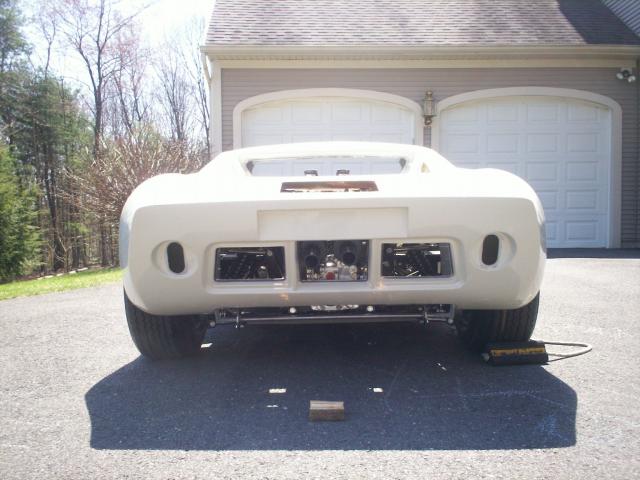

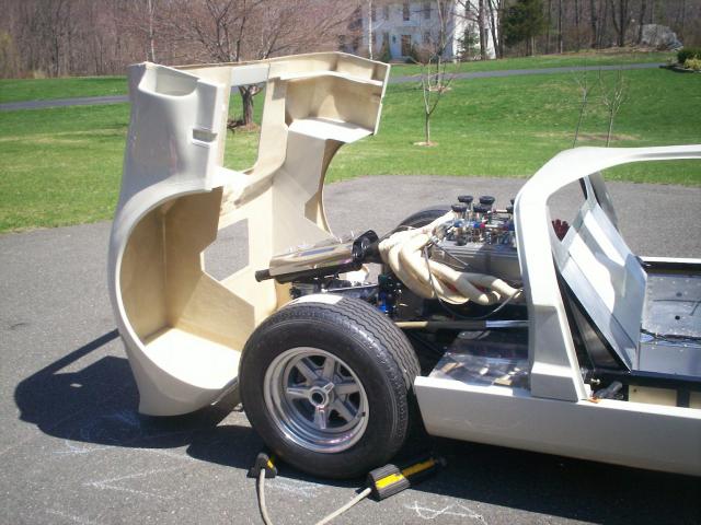

Had a great morning today!
875 outside with the front and rear clips hinged open!
Later today the scissor stops for each clip and the wiper motor assy.
Enjoy!!!!!!!!!!!
S

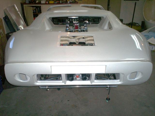

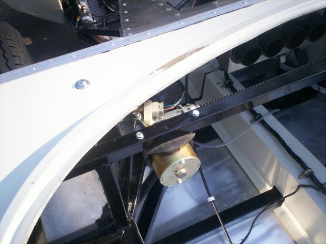

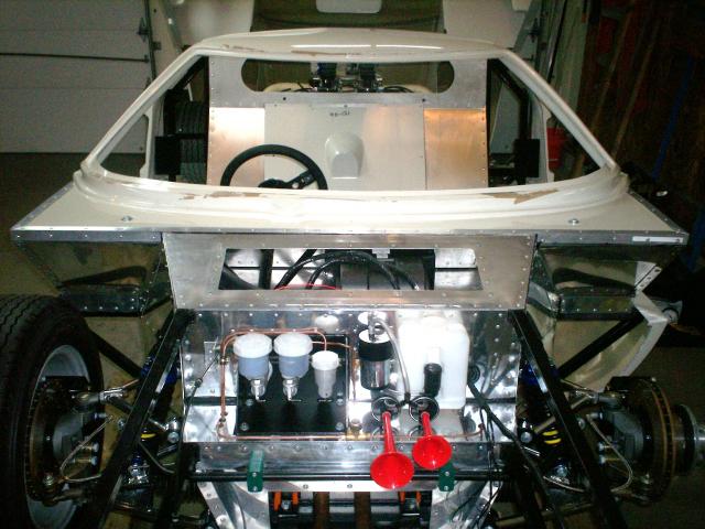

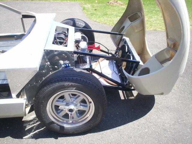

This afternoons work;
Installed the wiper motor and drive cable.
Note the OEM type pre terminated harness end on the motor assy.
Still need to flare the end of the drive tube and cut the cable to length.
Installed front and rear clip scissor stays.
This weekend all the windows/lenses will be fit ... maybe .
S

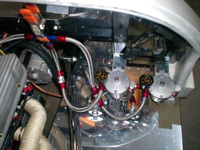

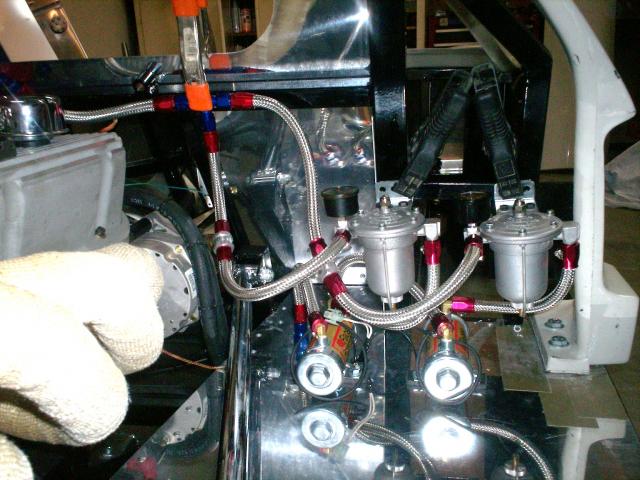

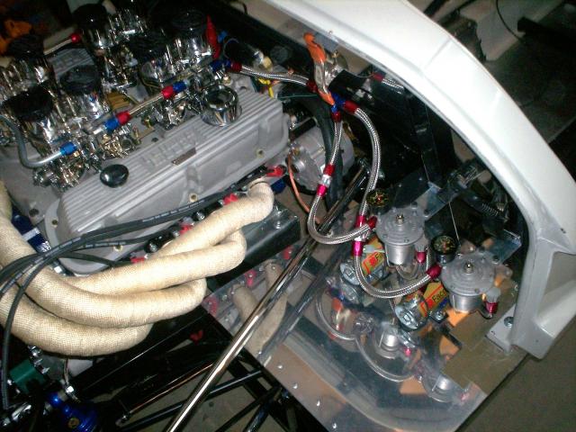

Tonight the the TSC "Twin Pumps and Filters" option was mocked up with fuel lines.
The cockpit closure panels go on at paint, then the filter/regulators get mounted.
S

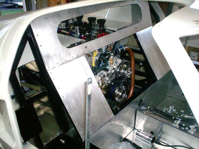

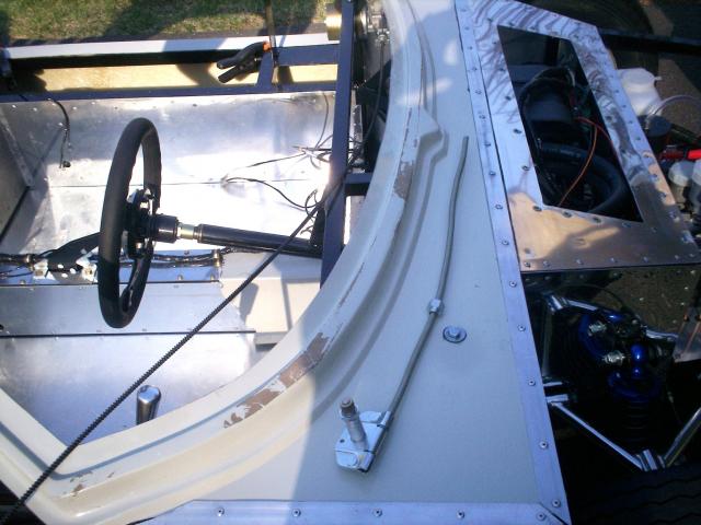

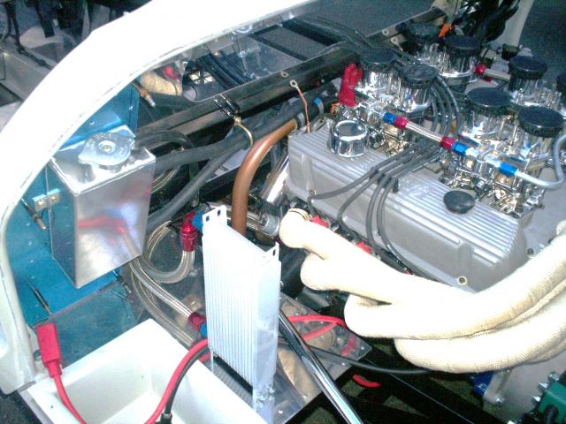

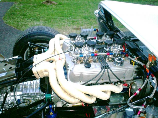

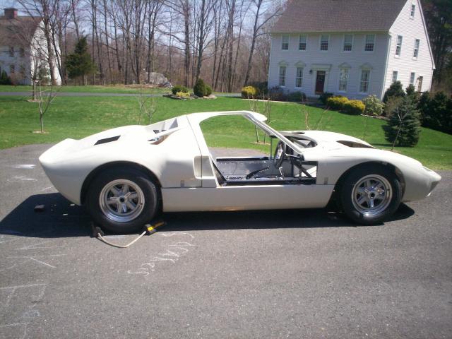

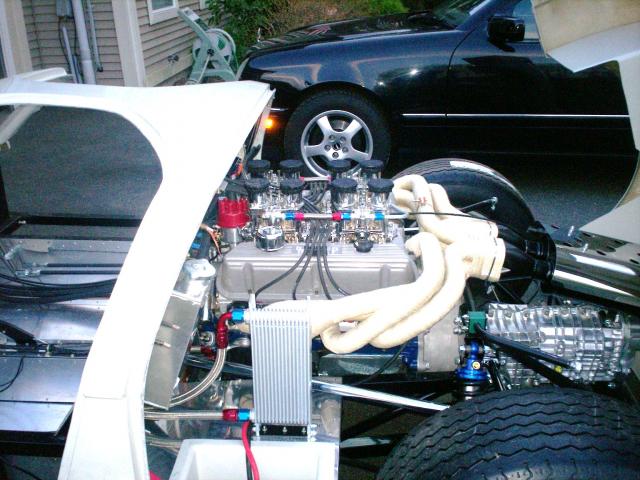

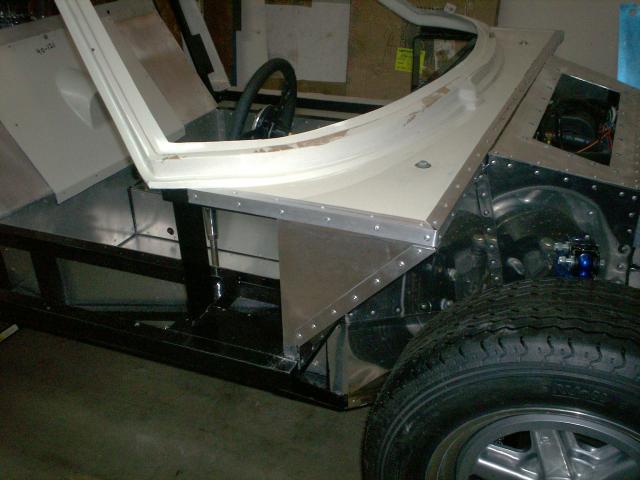

Todays activities;

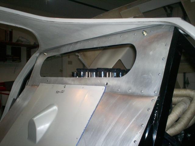

Started ignition wire routing setup so I can cut the wires to length and crimp the ends then put the boots on.
Layed out the rivet pattern for the left cockpit closure panel and fit the oil cooler then fabbed the hoses.
Fit the coolant purge tank and hose setup.
Body and paint soon
S

Just a quick update today.
Rigged the throttle cable for the Webers.
It is visible on the front of the engine with the spiral anti - chafe wrap on it.
S
