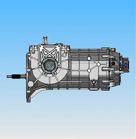

Hi Steve
If you look on the picture above the scavenge port can be scene directly below the output shaft. On the picture below the return port can be scene at the top right rear of the differential casing. The return will feed directly onto the pinion where it meshes with the crown wheel.
The ATB differential runs significantly cooler than the LSD fitted to a ZF/RBT so excessive oil temperatures should not be generated inside the ZFQ.

To be capable of selling so many units on the base of a nicely made CAD drawing is really meaning that you are a great commercial.
About the car testing.....it is also a bit of luck to have a vehicle at your disposal......but what's about the test driver?
Are you not affraid to customise the unit to close to the driver wishes, and probably missing the 50% driver requirements???
Isn't it one car too little for a full development of a transmission???
Normally you would need 2 or 3 cars at least.
One for dynamic endurance, another for functionality performing and another doing a sort of car life endurance test in the hands of a non professional driver ( 50.000 kms are sufficient )
The risk by leaving to the professional driver the full power to set up the fine tuning is as I told before, a customisation to his desires and a NON perfect fine tuning because he is capable to drive even with minor troubles untill full assuefaction of them is completed, and leaving them to the NON pleasure of the final clients.
regards
Chris.
This would probably generate premature hydraulic pittings.
Spray in the exit like all the Porsche and many other boxes are doing.
Again it is not a race box.
It sounds like it is designed under opinionism imputs in state of being designed under experience acquired.

Why don't you just tell everyone about your product with Goran and the name of your American distributor as he is to shy to reveal himself? You have your own thread, please go there and stop worrying about what we and Quaife are doing.
I appreciate you are in the transmission business and a commercial competitor and are trying at every opportunity to spoil what we are doing but please stop and take on board forum rules and ethics that have already been explained to you.

What Chris and Quaife are trying to do is to produce a modern and affordable alternative to the ZF/Porsche gearboxes for the GT40 market etc.
Some of Wanni's comments probably do apply but if you want to put that degree of research and development in a gearbox you are just going to put the price into the range of plenty of other gearboxes that are available on the market and even at that most still will only give 1 years warranty.
Having used Quaife products for years in motorsport i think they will produce exactly what is needed.

1) As I already said, I am not worried about this application ( FORD GT 40 ) because my unit does not fit.
2) try to be all relaxed because by developping my unit, I ahve already drawn the " MAP OF THE SHITS ", and I suggested Chris to be carefull where he put his feets.
3) AGAIN.......you can see my unit in perfect operationality on many vehicles.....all the rest is still theory.
THE FACT is that all the replies from the PUB ENGINEERS were based more on skin simpaty that on real position on this matter.

PS. The ZFQ feeds the return oil to the exit of its crown wheel and pinion so cavitation or hydraulic pitting should not occur.
Regards
