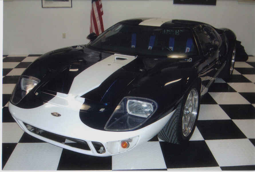

CAV GT40

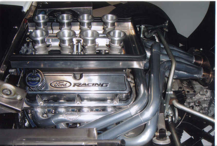

427 Aluminum

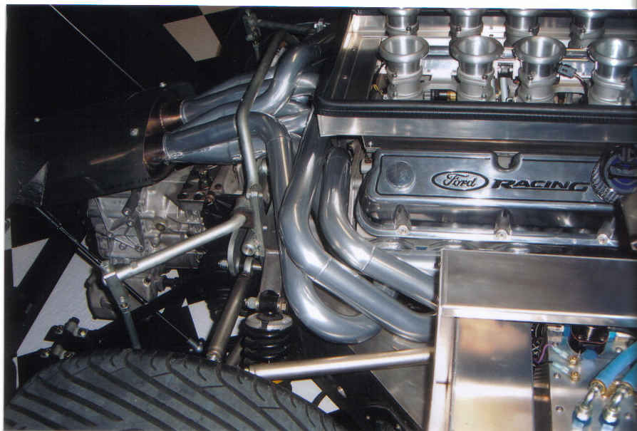

Engine 550 HP
Strike2 is offline

Re: John Place GT40 rebuild
Hi there, fab looking motor. One thing I've always been curious about - how do these stroked smallblocks sound compared with a big block 427?
Hard to tell unless they were both together. I would think not much difference, although small block done this method is fairly high revving.
John
