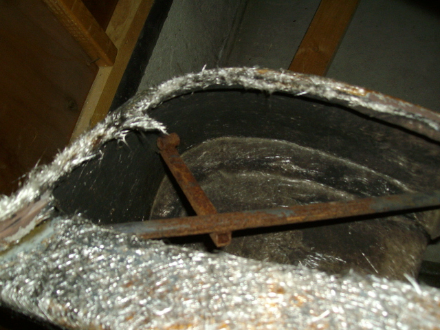

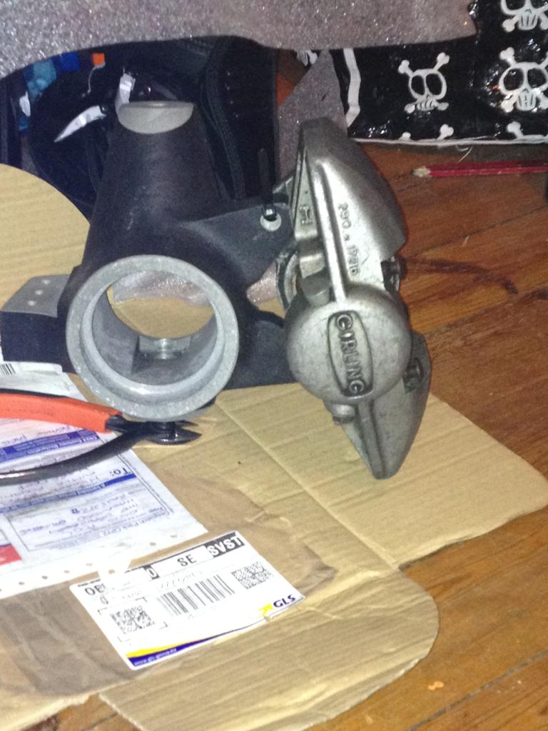

I decided to start a new thread for the B16. I am close to starting the chassis for the car. I am just about done the molds for the car, The rear clip is all I have left. I am also pulling parts as the molds are done after prep. They are in black gelcoat, 3 layers of 1.5oz roving. For the Admin guys I am not a reseller and am hoping Fran will join the cause in the future now there is some half decent bodywork and If I can get some DOT glass done soon. The car I will be building will be LHD 2 Up Road car on a getrag 016 transaxle RCR cable shift mated to an Pontiac 90 2.3 Quad 4 HO (190HP+) ExtrudaBody Fuel injection on a DCOE intake. I will be using Cortina MkII front Uprights Momba Motorsports rear. I may change the fronts to the Racelead Uprights from MVR and to pins instead of ball joints like the original car setup.They come with the steering arms and look close to the original Chrevon(RTM) uprights and mate to the Cortina rack. I would like to thank all the guys and vendors that helped me out because unless you own one or have one for reference the info on this car is hard to get. I will post a few pics of the parts I have already.

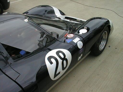

The Willwoods are 12 1/2 inch units and as I had yet to buy the front wheels, drilled the hubs the same Audi patern as the rear. We had a B16 down here in NZ last year and that was running a BMW 2 litre and was very quick with a great sound. I will dig out a couple of pictures.
This car was running at Pukekohe along with a very large contingent of F5000 cars and a Mclaren M8D. Lots of camera time.

The car in the pictures looks like a B19. I was looking at the mounting points for the upper control arms and it's a different setup. I also have to run the remote resevoirs on the brake cylinders. The two cars are basicly the same one has open cockpit and different bodywork. A GT 40 killer would be the B8 with the Repco V8. The B16 ran Cosworth Fords, BMW M10 M12 and Mazda R12- 1600 to 2.2 L. I am going to use the cable type shift and mount it on a raised console between the seats. I am doing the car LH drive.
