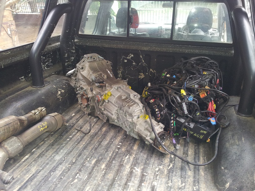

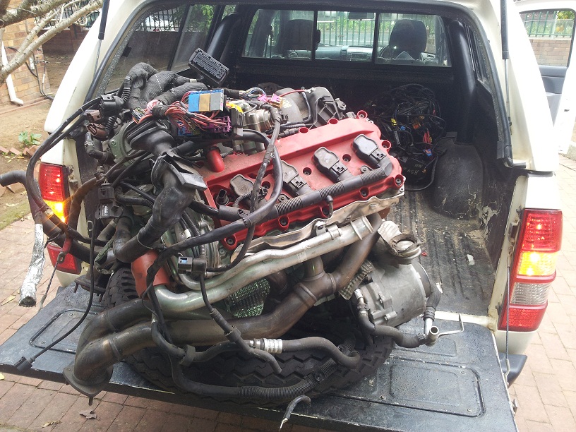

Thanks David. I definately have a OA3. I picked up my engine, box and other stuff today.
Name:	2012-07-02 15.13.13.jpg
ID:	59525   Click image for larger version
Name:	2012-07-02 15.13.19.jpg
