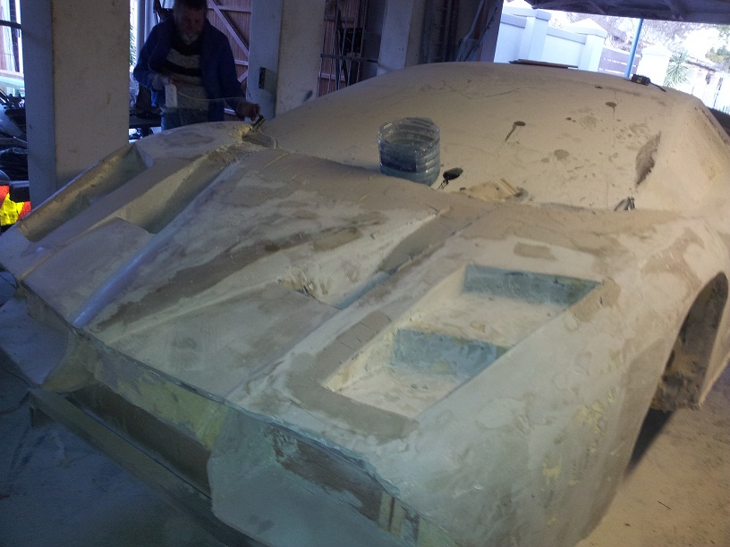

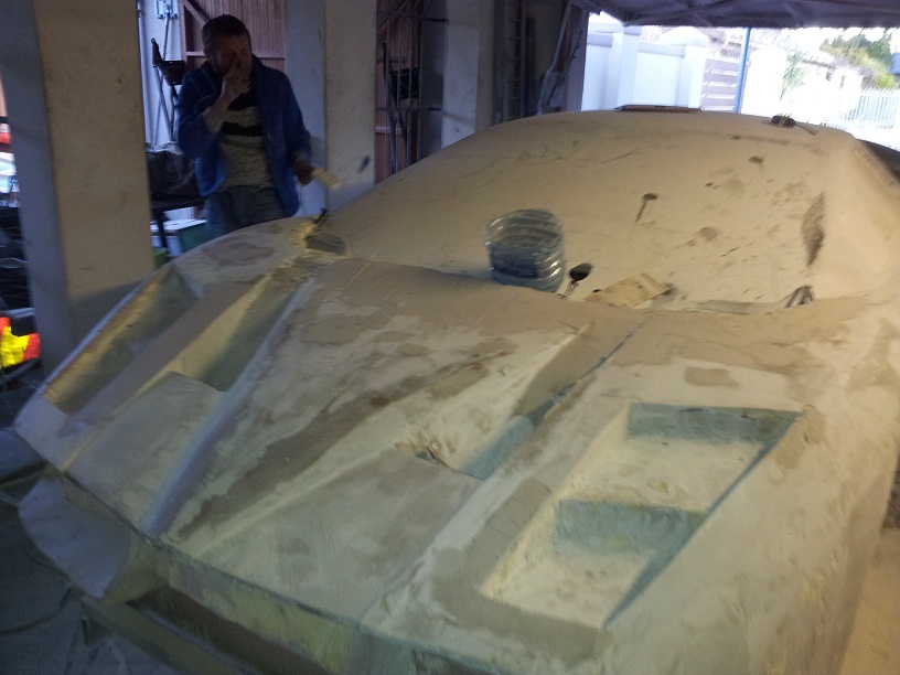

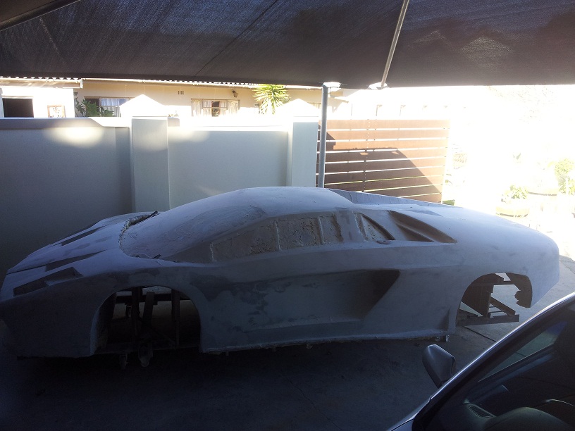

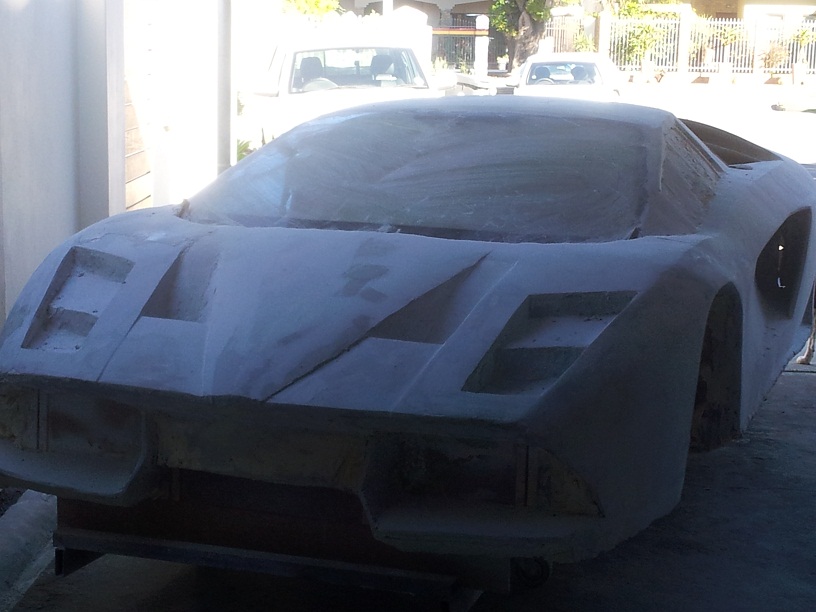

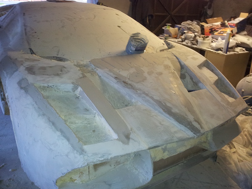

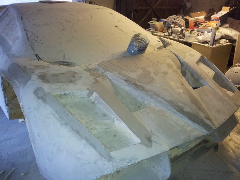

Starting to get the bonnet/vents/nose area close to what I want. The bottom front vents I have changed a bit too but not quite there yet.

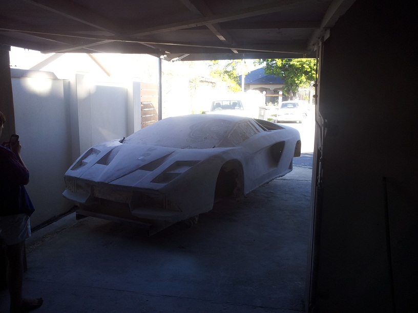

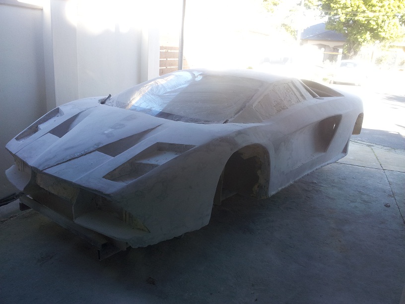

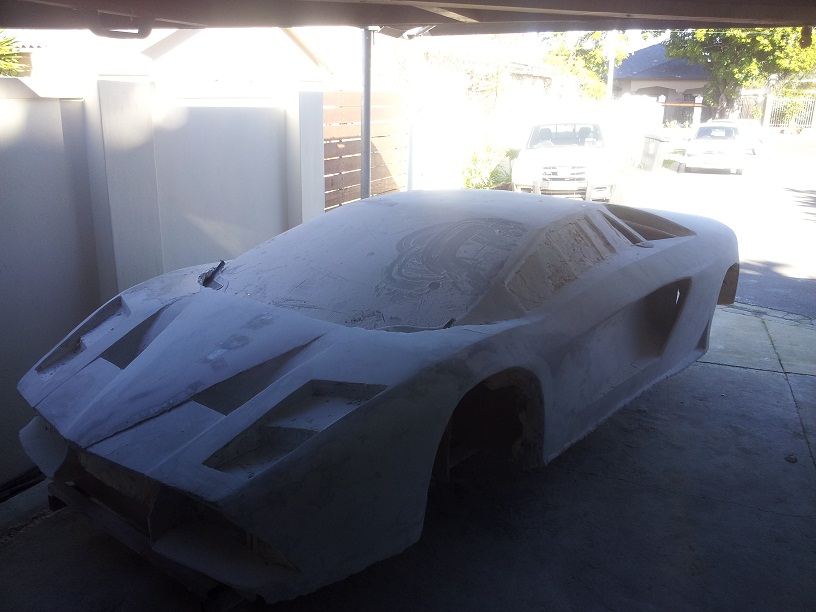

So pushed the fat lady out of the garage to have a look at it. It is getting there but even at this stage, especially when I think of the doors and recesses, I get my doubts sometimes! When I looked at it outside though it's all worthwhile.
We worked on the nose again, the bottom front vents STILL needs work. Where the bonnet and the winscreen meets also needs to be finished. Side vents needs alot of work on the insides etc. etc. etc. etc.

Man that looks impressive!
When you see how long body shaping takes you certainly have made fantastic progress

Looks like you are making good progress. What is the projected ground clearance and overall height?

Hi Doug,
Ground clearance is 150mm and overall roof height +/- 1120mm, the frame on wheels is about 190mmm high, so looking at the pic visualize it as 190mm lower.
What do you think of 150mm ground clearance? Too much?

150mm = 5.875 " may be a bit high but is probably good for road use especially if they are a bit "rough". 4.5" = 115mm is a bit more "exotic" but may be a hassle. For the track you could probably drop down to 4" = 100mm. I think most the GT40 guys around here are at 4.5 -5.5" and keep an eye out for speed bumps!

Since you are doing a custom chassis you can tuck up the tender pieces and still keep the door sills low for the stance you want.

yes. I might drop it to 120 mm, then my roof to ground will be 1100 which I think will be more in line. As far as speed bumps..... I was thinking of pneumatic lifter in the front, which should help.
