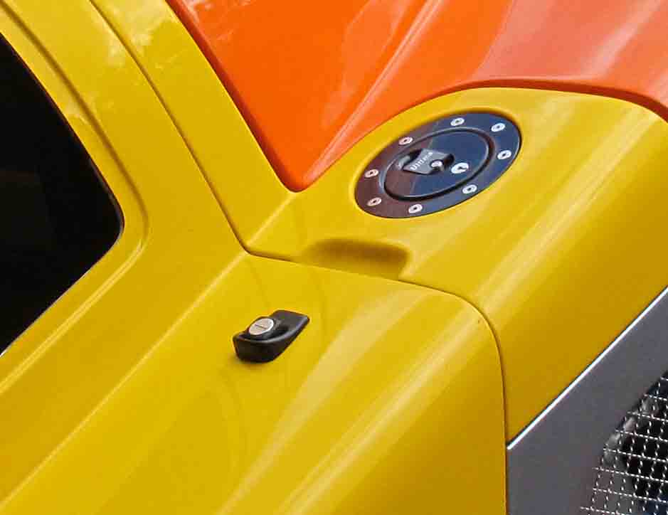

Basically the centre section needs to be removed, screen is the same on the Can Am as the GTR so that is re used. The centre section incorporates the roof section , pods that support locks and hinges and fuel fillers. It was better to remove this by cutting it out with a slit disc grinder, messy but effective.
8 x 6mm bolts and about 20 rivets to remove.
Disconnect all the dash switches and gauges and out it comes.

New door hinges will be needed and Can Am locks need to be modified.

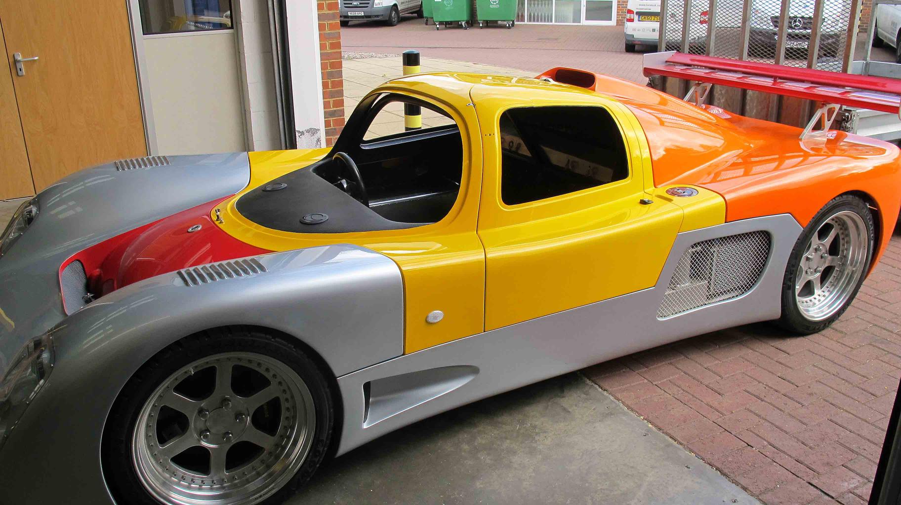

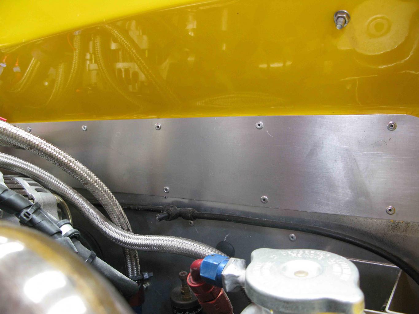

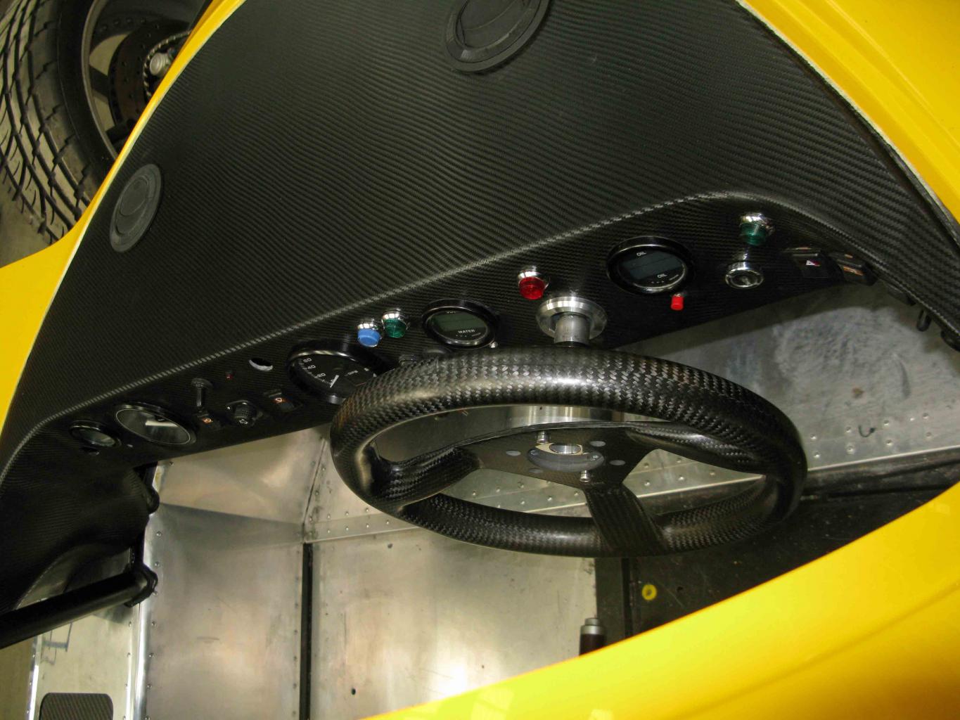

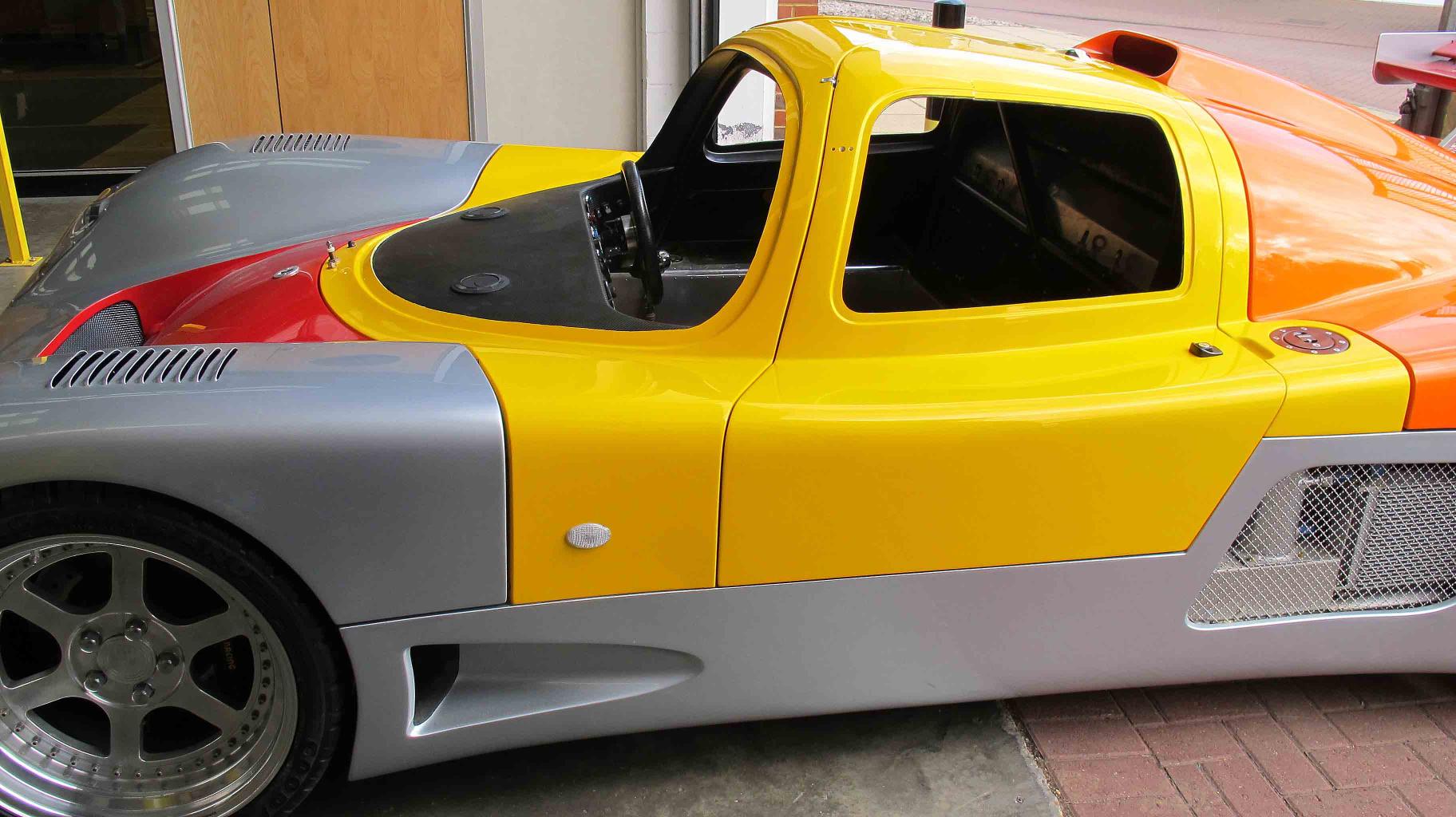

pictures of the new centre section just dropped on the body at the moment but at least it sits well.
Need to extend the engine bay ally fire wall up about 70mm both on the engine side and from inside the cabin.
This will eventually be panelled in real carbon fibre to match the lower section.
Seriously considering having the dash wrapped in 3m carbon, keeps it simple and effective.
The good thing is I have the other GTR as a reference car, dusty as it is.

Actually John the silver and yellow looks ok.
You should see the rear canopy it's bright orange.
Joseph and his multi coloured car comes to mind
I'd Like to drive that Radical John

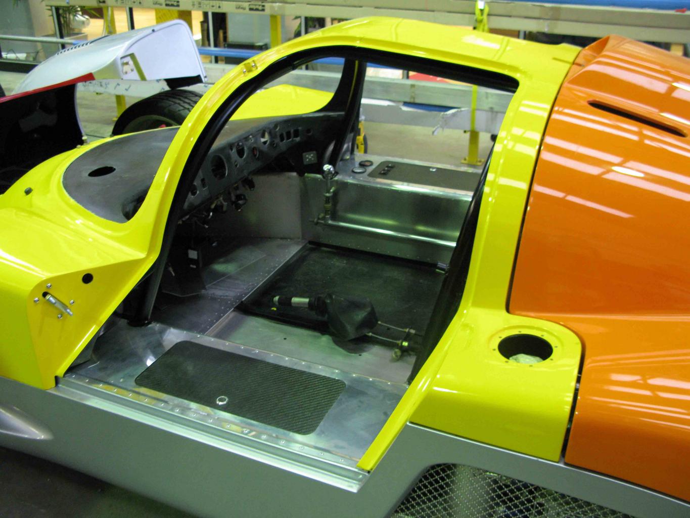

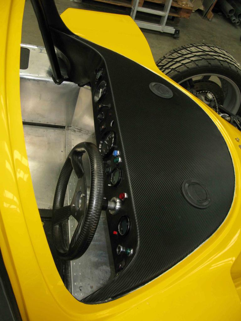

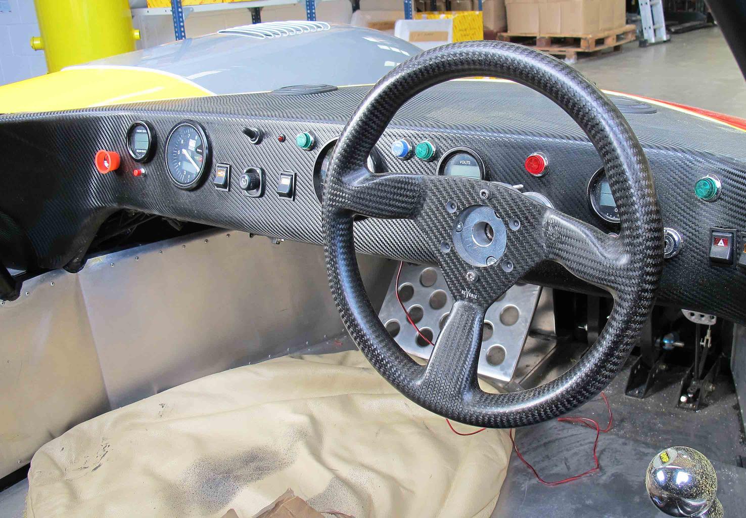

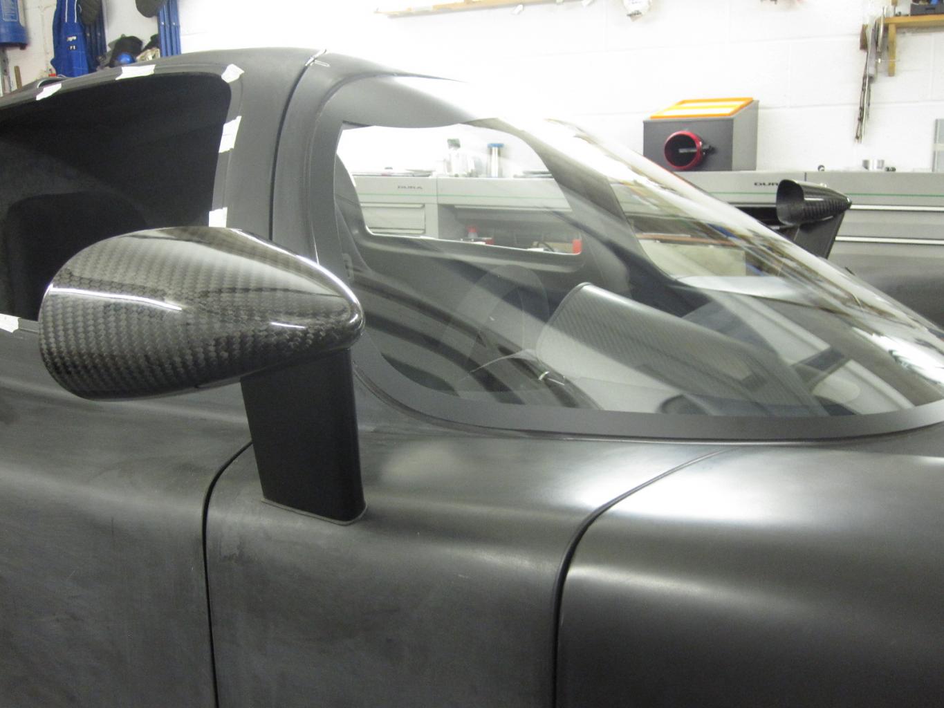

The new Drivers door and top door hinges arrived today.

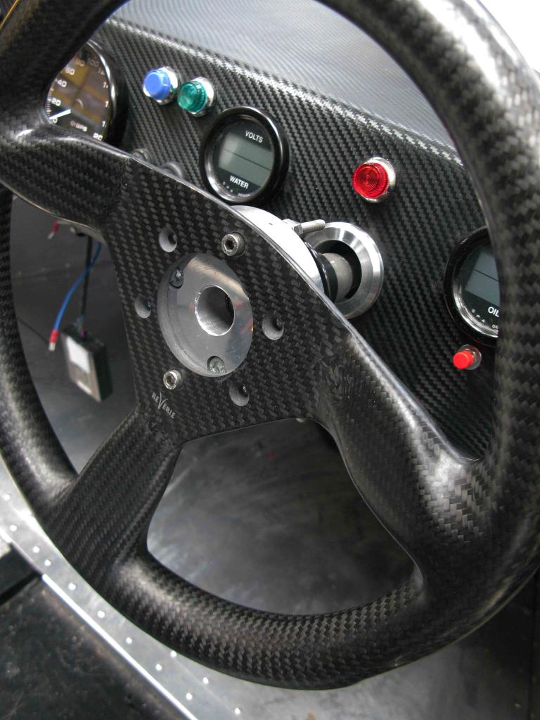

Cut the gauges and switch holes in the new centre section / dashboard
I have cut an extra hole in the dash for the Speedhut GPS speedo that I have ordered from the Yanks, should be here soon.
I think it's about 85mm dia, so hope the hole is not to big, too small's not an issure !
Trial fitted the body and all looks ok, drivers door is out of alignment a bit but it's adjustable.
Although the car will be painted or wrapped the colours look ... well different !

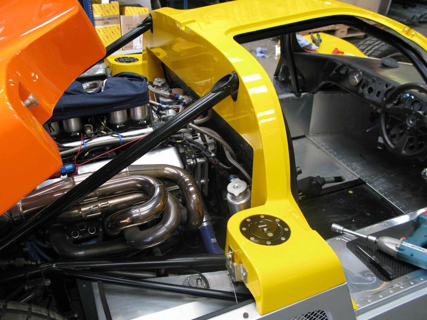

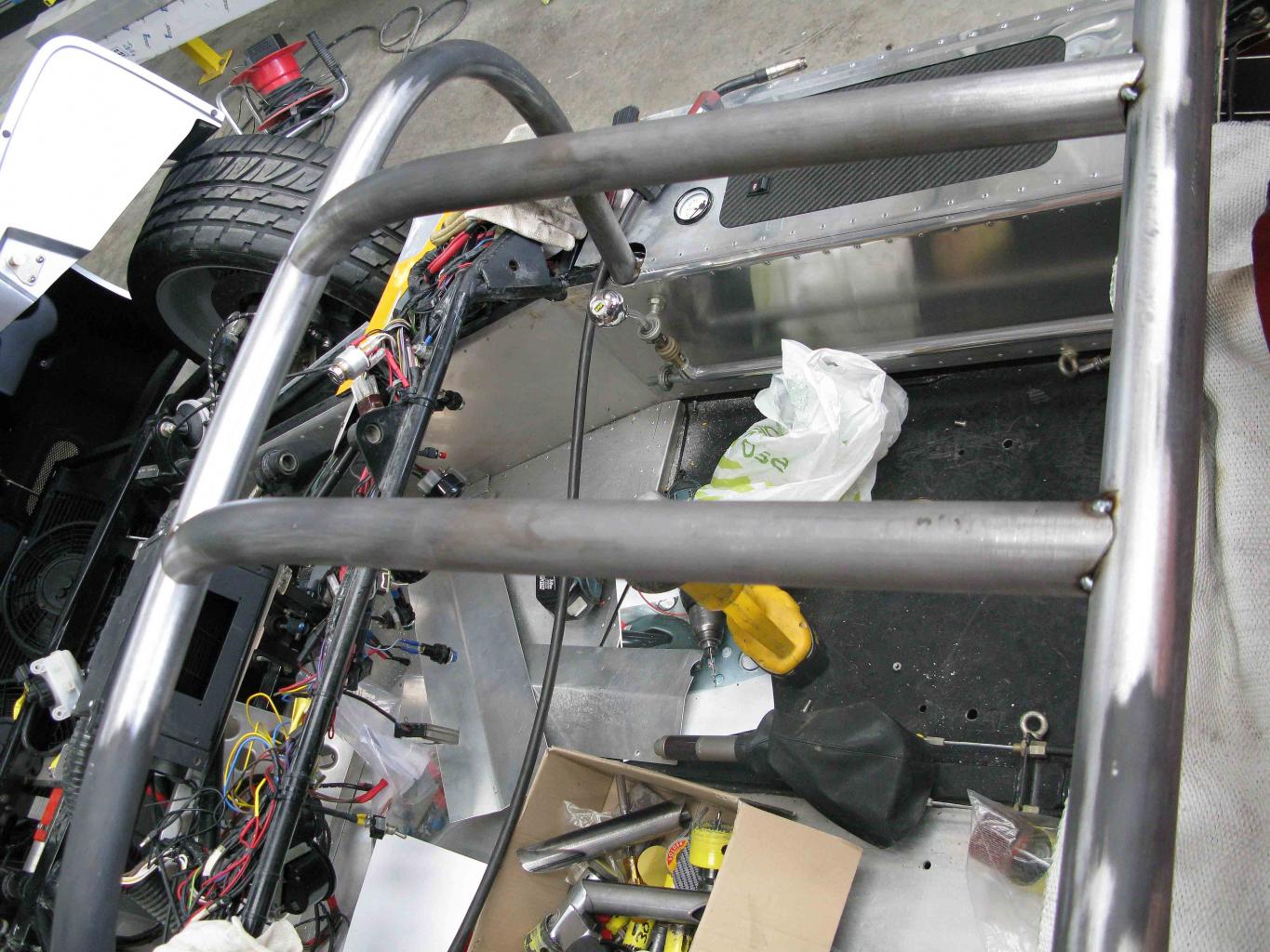

Stopped un building the Ultima now and starting the build.
Although I can't final fix until the new roll cage parts are here and welded in.

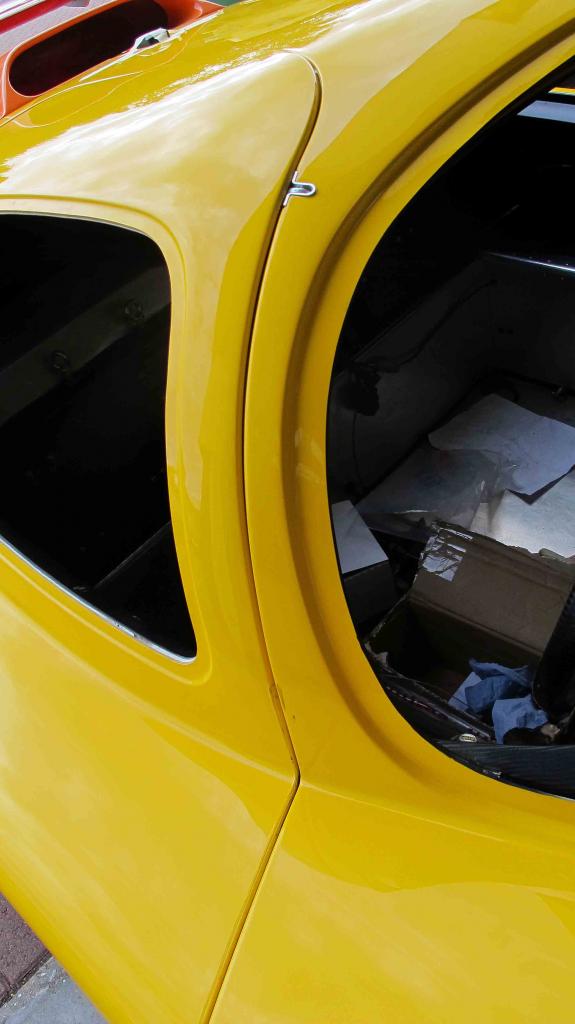

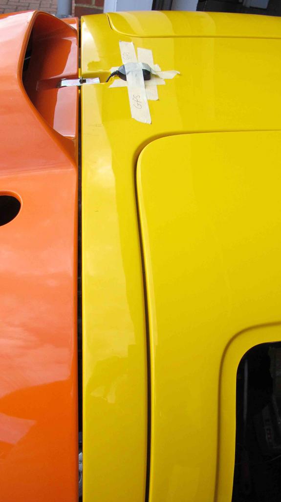

I trial fitted the rear canopy and fitted the lights, rear loom,locks, canopy telescopic struts and of course the carbon rear wing.
Although this wing is painted I will consider stripping it back to carbon and having in re polished. If not replace it for new... I'll see how it comes up.
When you consider how time consuming a gt40 body is to get right. I reckon you can easily fit a complete Ultima body and align it in a day.
I did have a bit of trouble getting the Ultima lights into that new rear canopy, I had to sand a portion of the light cowlings, took about 2 hours to do all six.

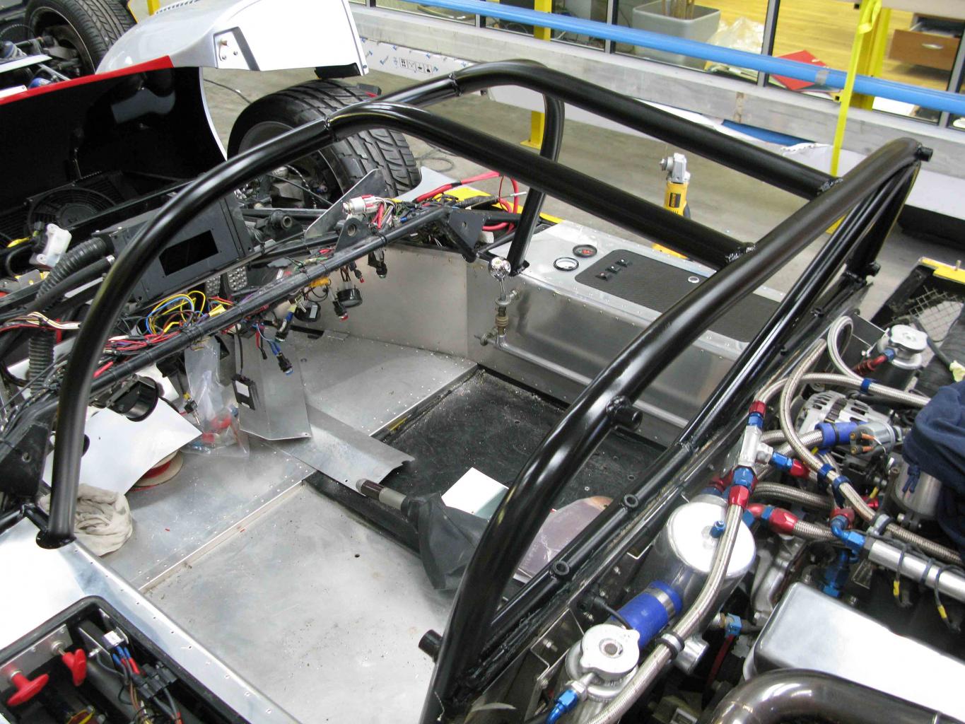

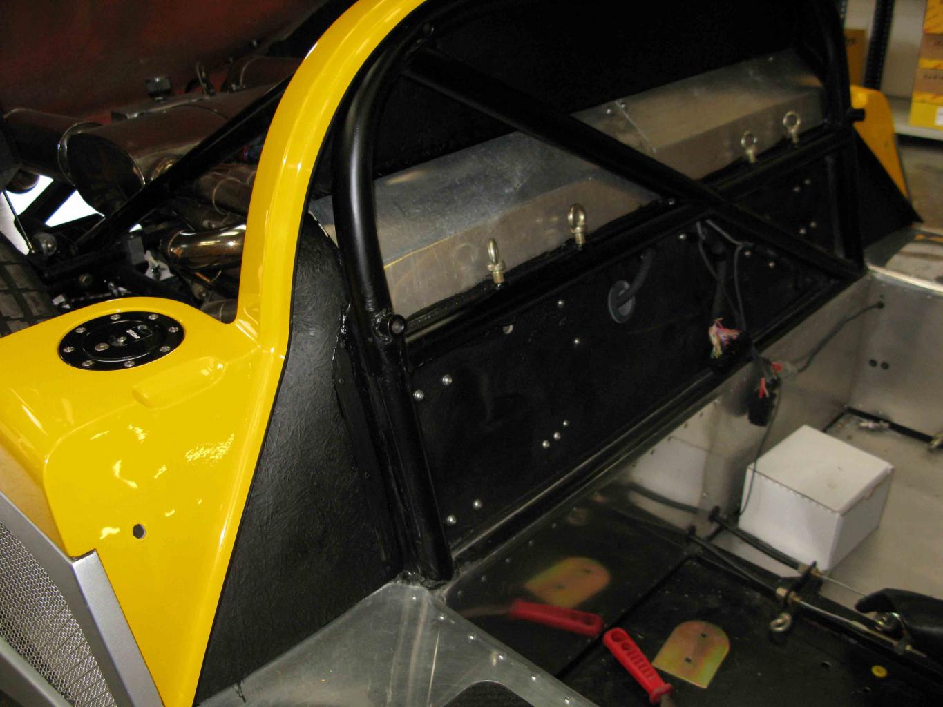

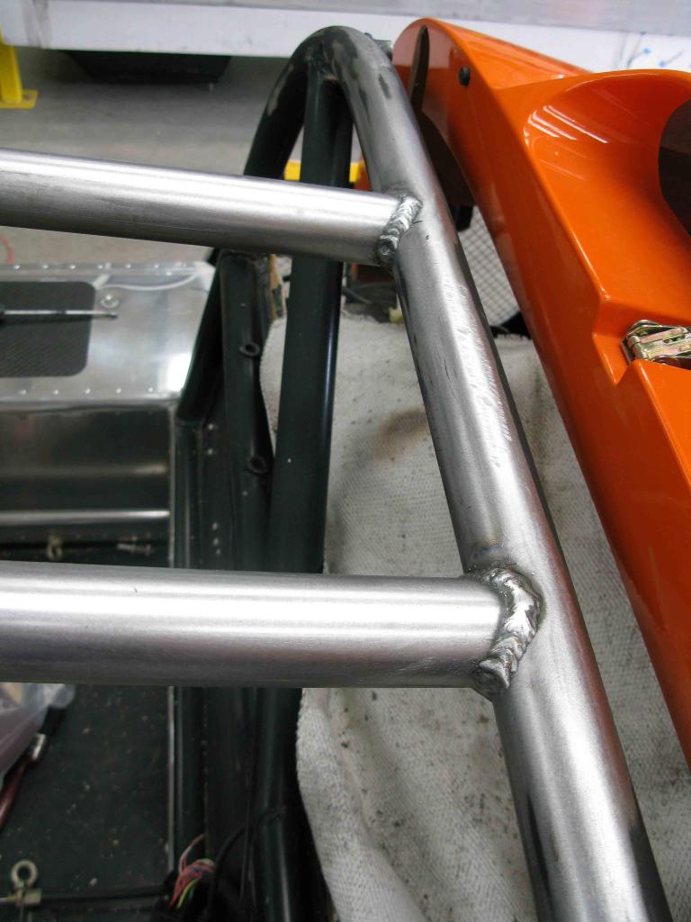

Hi Tom, Cage I believe is RAC approved as well as other type approvals.
But although the pictures are not great examples they show the 2 rear supports from the rear top of the cross member and the other picture shows the main hope following the screen area with 2 braces back to the main cross member.
This screen and braces bars are what I'm waiting for.
Ultima's website shows a better picture of the bare chassis where all is revealed.
Ok, in the early pics I just saw the hoop behind the driver, nice car.
