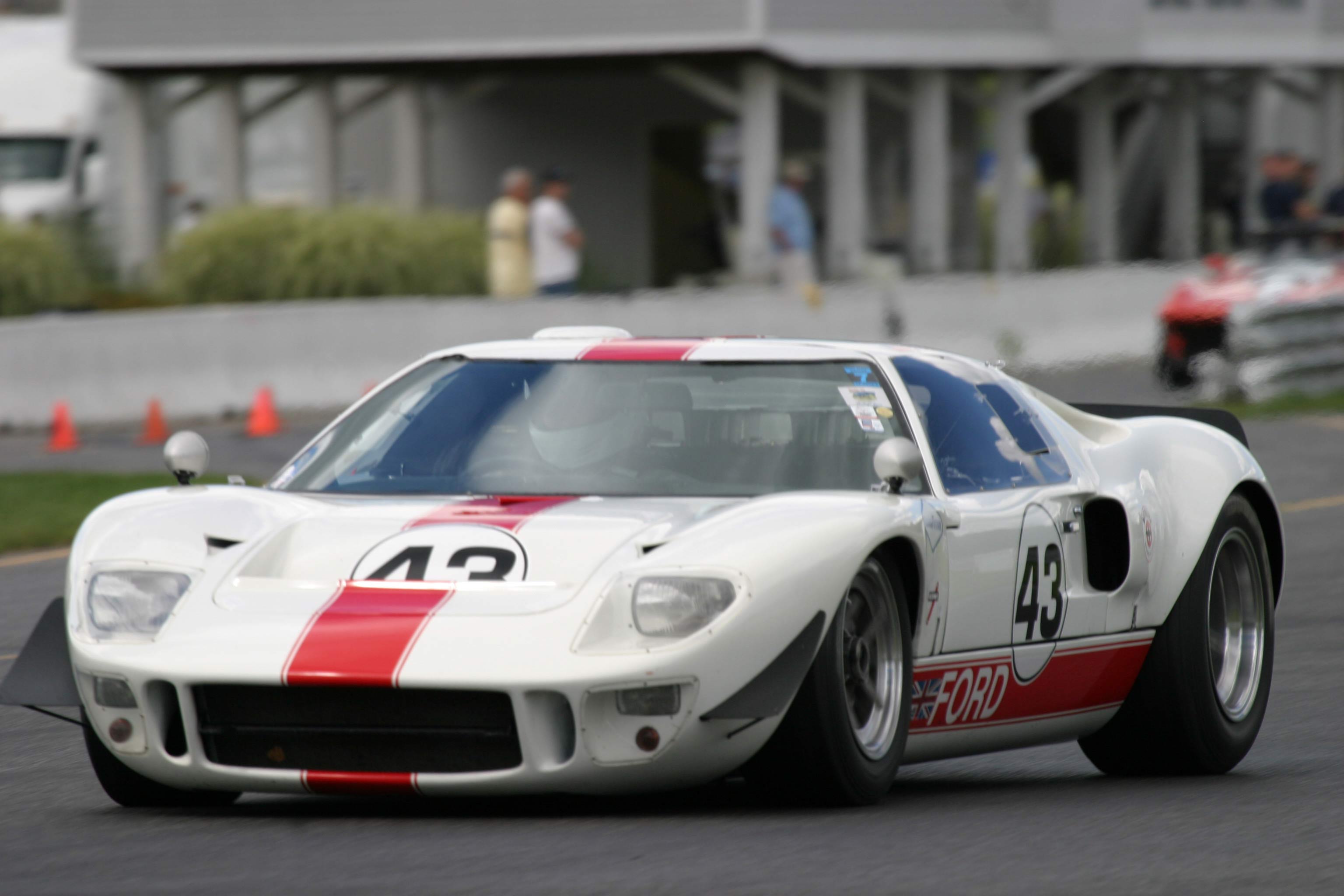

Front view....

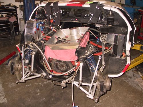

Another shot from the rear...

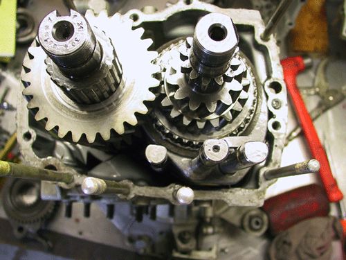

ZF going back together...

Awesome pics John!!!! Thanks for sharing. Is that a -1 ZF?
What ring and pinion are you using?
Can you tell me about your clutch set up ?
Thanks!

You get a gold star for spotting the early -1 ZF!!!!! Yes, it is the infamous 1st gen ZF with all of it's problems. It is actually the orginal which came with this car. I am searching for a later model ZF to race with, so that I can put this one is storage. This trans is certainly the Achellies heel of the car. The exposed shifter input needs cleaning and lubing after every event.
I was running the car with a 4.22 ratio ring and pinion but broke that set at Limerock last month. I just replaced it with a 3.40 set to run Sebring and Daytona.

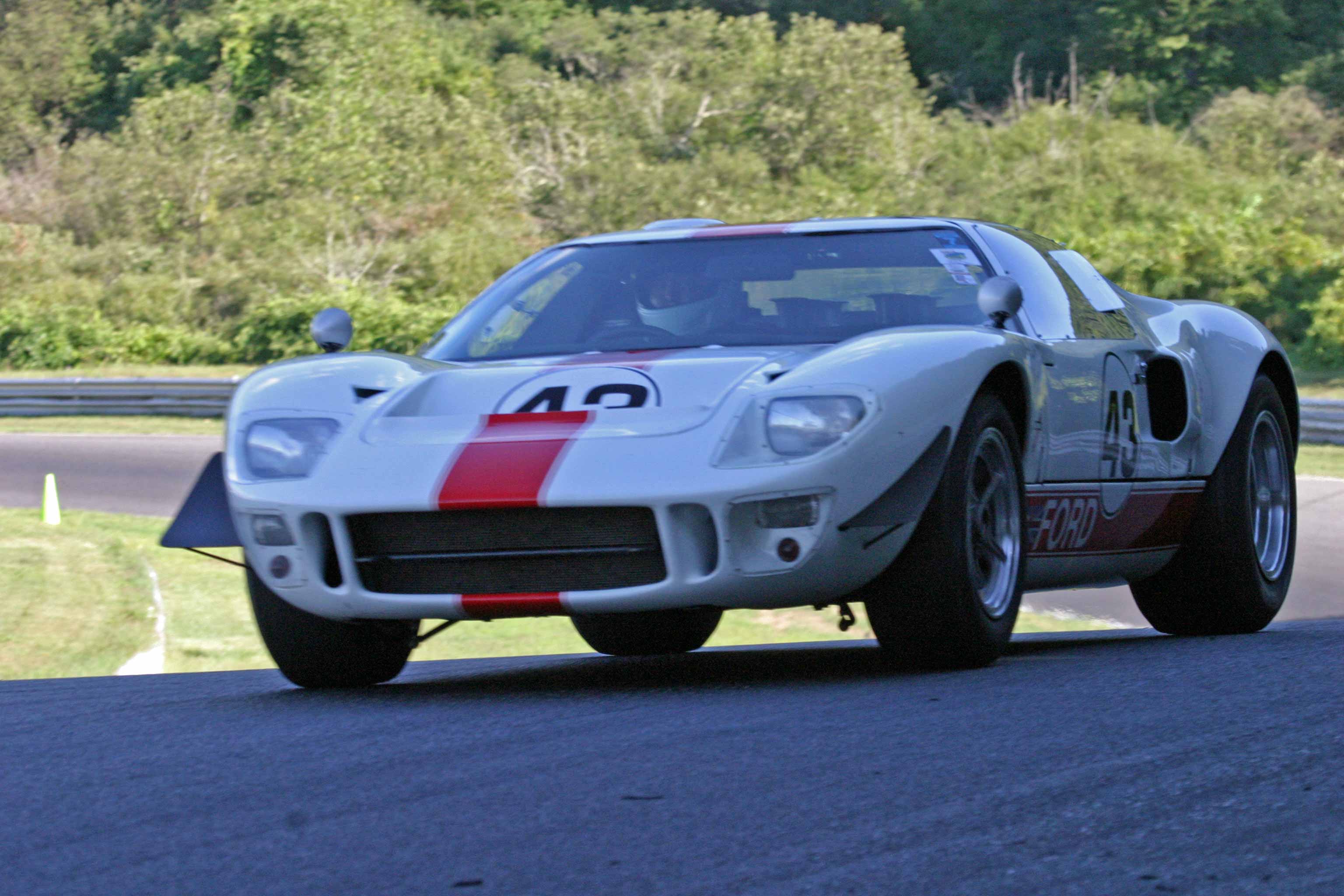

Here is is, again at Limerock, entering Turn 1. Top speed about 147 MPH braking down to about 60 MPH.

A great example of suspension travel. [img]/ubbthreads/images/graemlins/grin.gif[/img]
That first photo must have got your blood pumping!

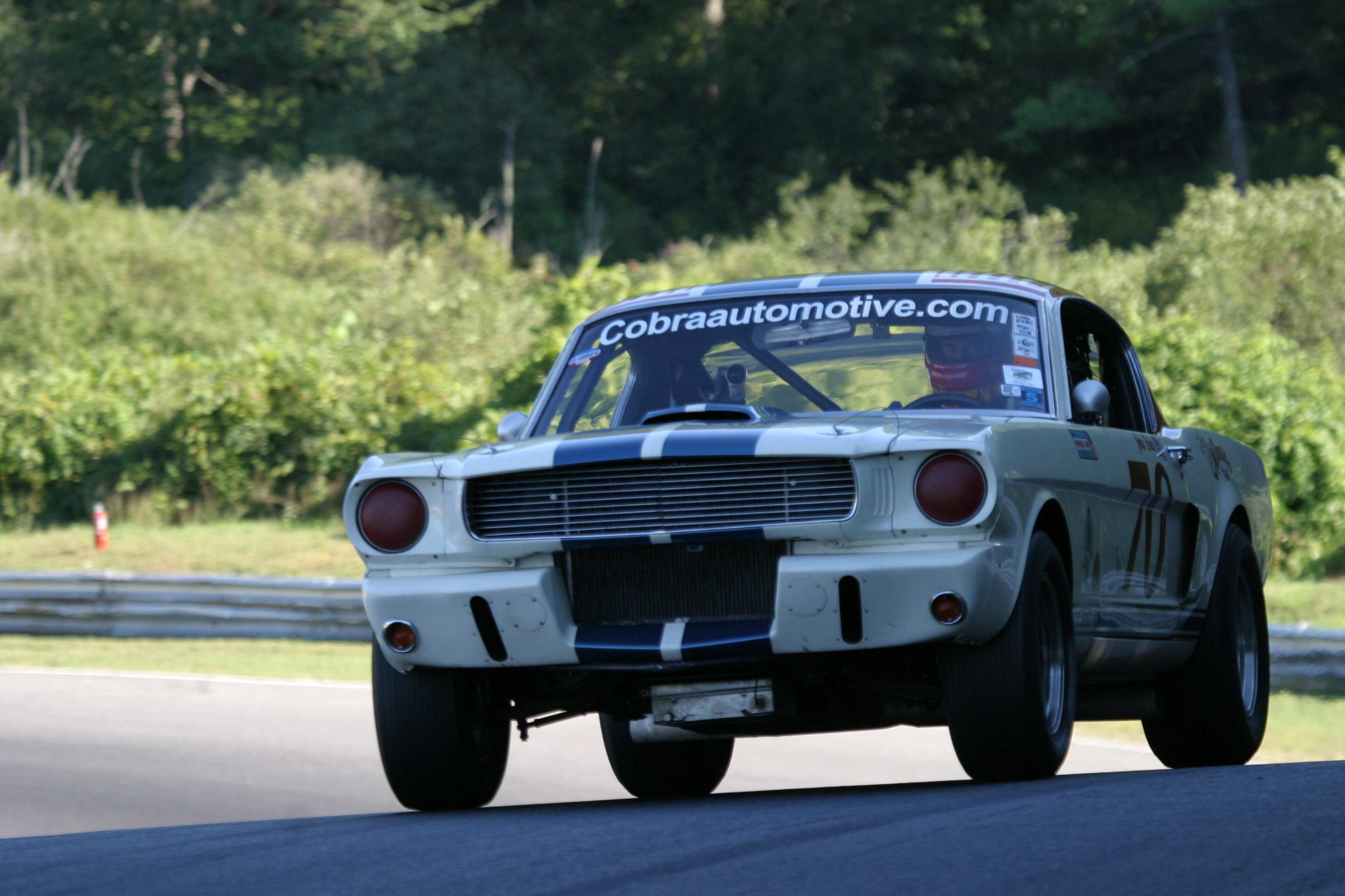

Here's the same car under braking. These pics are a great help in setting up the cars.

Great pics. Definitely suck up the seat leather on that one!

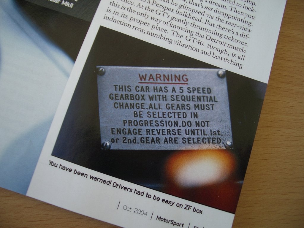

You question about ZFs with sequential shifting was true of some units but I do not have any first hand information. However, the label worn on those cars is in the attached picture. This label will also create a lot of interesting comments at car shows and it will convenience the valet service to just leave your car parked in front of the restaurant until you get back.

Thank you for your input on the ZF. Did you buy your ZF from RBT in Califonia or did you find an original for your CAV? If so how does the shifting sequence work?

Just like many others, I bought a new ZF from RBT. The shift pattern is like in this picture from a Pantera. Note that reverse is slightly off to the side and is not directly aligned with 1st. This is the normal shift pattern with no sequential stuff.
