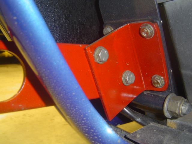

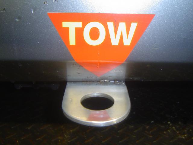

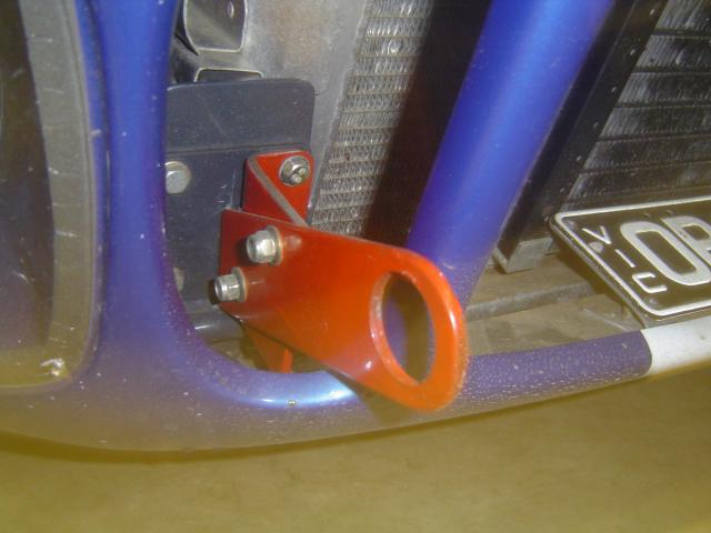

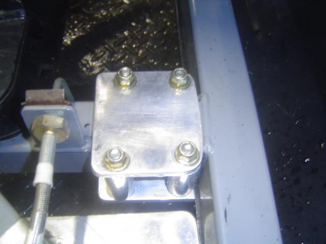

Bobski,
Photos of front and rear towing eyes FYI.
Both are very strong, the front eye I use to winch the car up onto the trailer. Its made out of a piece of angle iron and flat strap bolted to the front hinge mount. The rear eye is flat aluminium with4*38mm round spacers between rear rail. Hope these make sense and are helpful to you, I know it took me a while to figure out how to mount the towing eyes on the car. The first photos are not of my car but a mates who I just made some towing eyes the same as my car for him (In case your wondering why the car is blue).

Thanks for the pics Andrew. If you don't mind, I may use the front design, where as the back I would have to come up with something different as i have a rear diffuser on the car. Thanks again mate.
