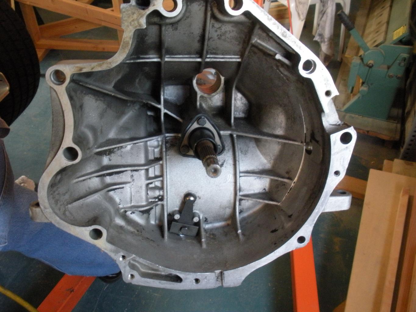

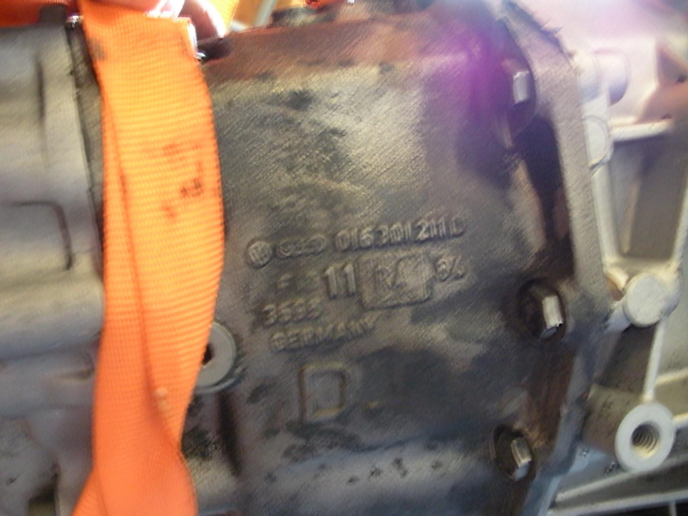

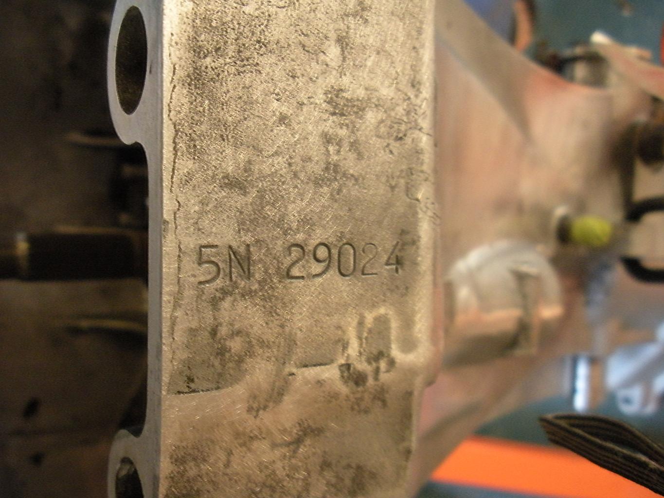

All just getting into my kit and have this transaxle. I know it's Audi, does anyone know specifics about ratios, and where does the clutch fork go and where can I get one? Also, anything to check out before I bolt this on and expect it to work well? And, what type of auto did this trans likely come out of. Thanks,

Doug, it's Audi 5000. Take a look at the .xls chart attached above - it gives you all the ratios. You can get the clutch fork through Audi or a german car auto wrecker.
It's worth replacing the output/input shaft seals and changing the gear oil before even considering doing anything with it. Make sure it doesn't feel "crunchy"
