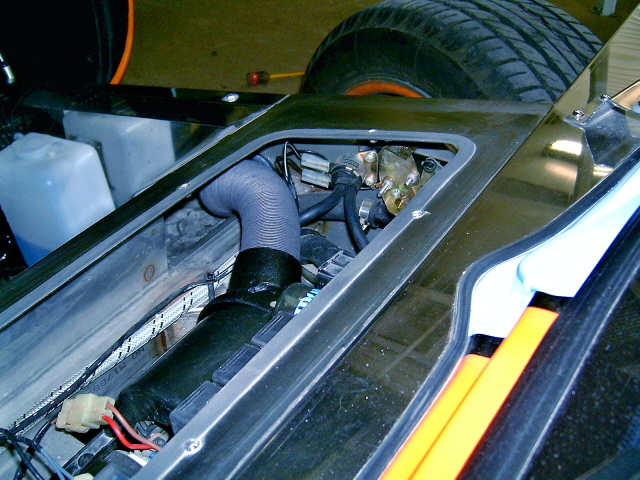

Also check the vacumm to the hot water valve dashpot. I've seen them reversed or leaking, either way, no heat. You could also have an airlock in the heater. You can see the valve in the pic below.
Although not in this pic, we fit radiator back flush fittings in the hose entering the heater and fill the car from there. The heaters' vacumm valve has to be propped open while filling the car. FYI:)

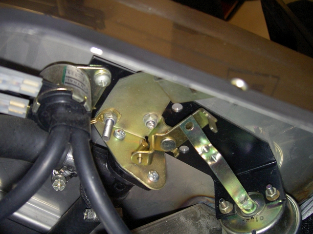

This may be a helpful picture. In the upper right is the mechanical lever that I think Chuck mentioned. The actuator rod slips off the lever. My fix was to add a small washer and cotter pin on the end of the lever to keep the actuator rod on without binding. Several of us have had problems with this in the past.
For what it is worth, I drove my car back and forth to work all last week during daily thunderstorms and the heater/defroster seemed to easily keep up even on the lowest fan setting. I also found a source of water leaks where the fiberglass edge in front of the windshield seals against the S/S chassis and around the removable electrical access panel just forward of the windshield.

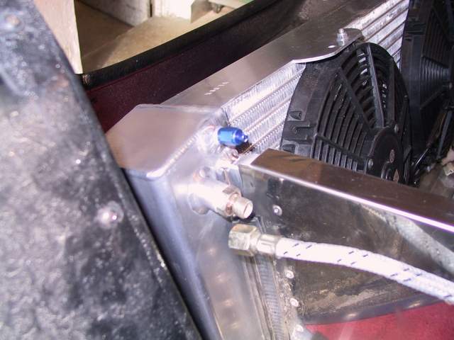

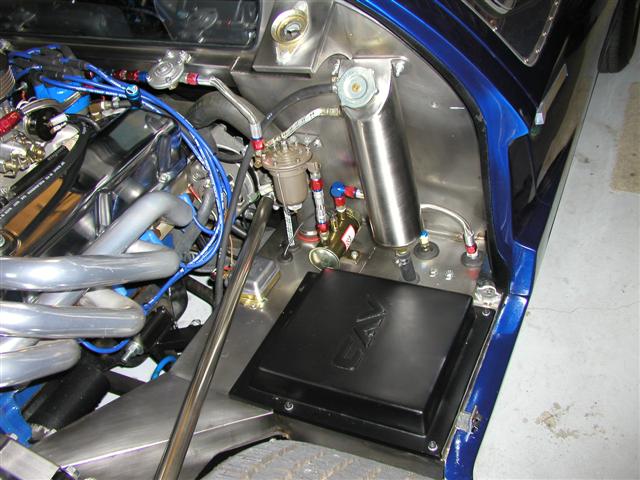

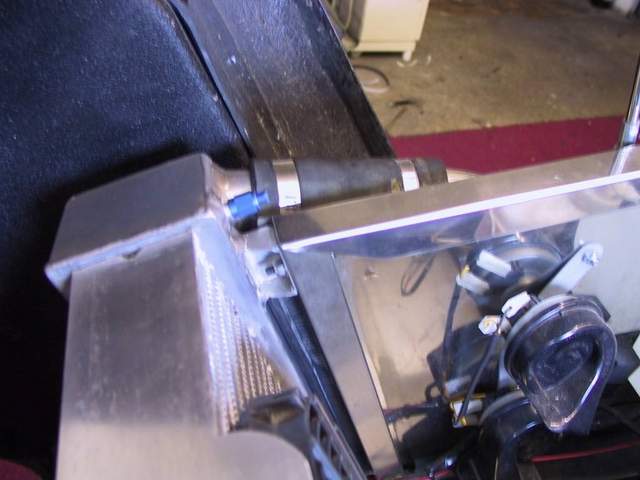

Here are three pictures to help. Bleed valves could also be added in the heater lines or the main radiator hose instead of to the radiator itself. Also note the brackets to anchor the top of the radiatior. AutoFutura has add on brackets to do the same job. Finally raising the rear overflow catch tank in the engine compartment will naturally get rid of a lot of air in the system especially if you let the car idle with the nose down.
