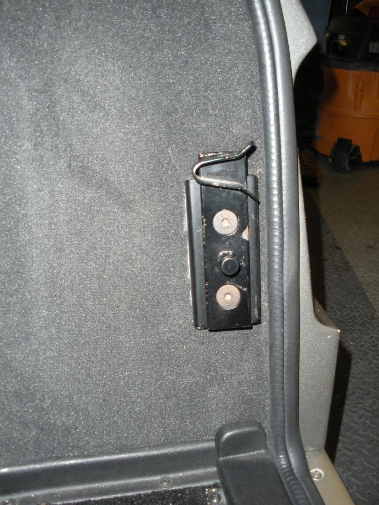

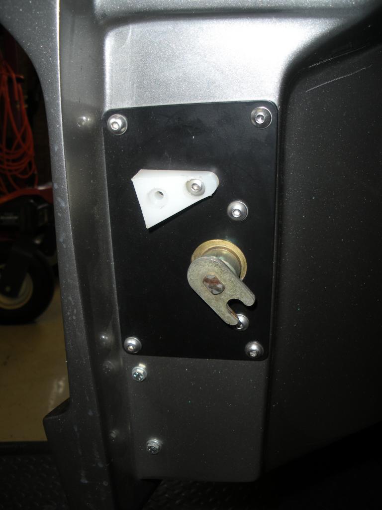

I've got the standard hot rod bear claw for door latches. Not bad, but the gap between the firewall and door is greater than I want it to be. My thought was to use a latch with an external (outside the door jam) latch vs. the bear claw. See pic. Does anyone know where I can get these? Thanks,

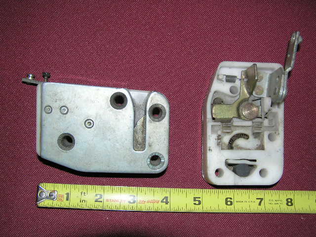

Doug:
Try these, I am using them, and I have seen them on some of the GTD replicas
They are from a MK III mini
They are right and left handed, and have the lever for connecting to the inside release.
Phil
