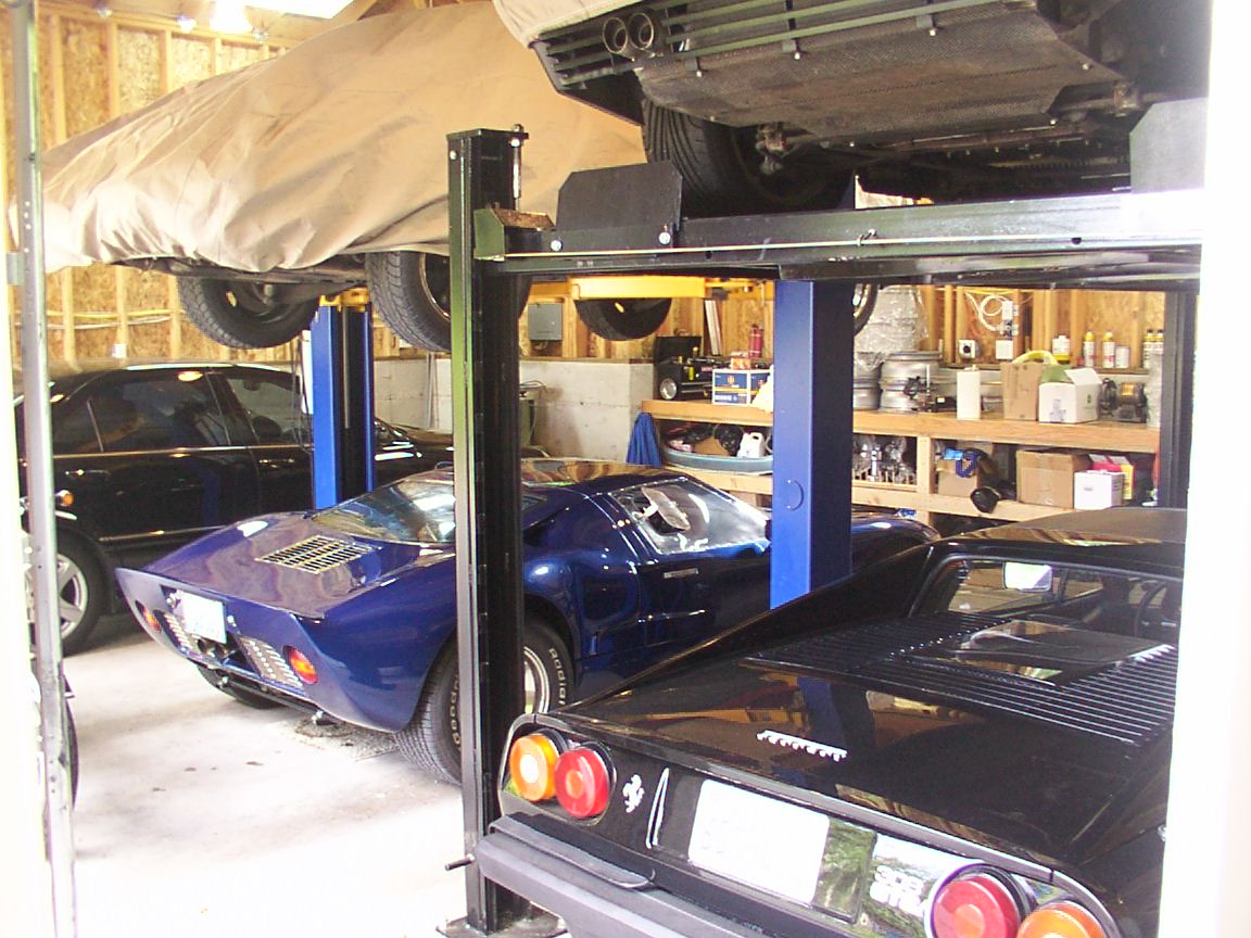

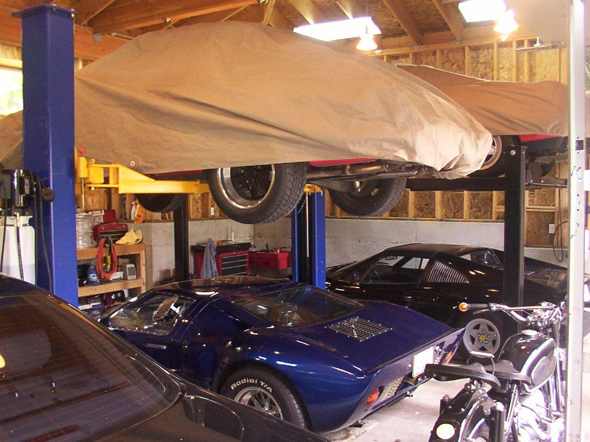

I'd like to install a gas garage heater in my recently (finally!) finished detached garage/workshop. It's a 3 car garage with additional work space and 18 foot ceilings. About 800 square feet. The walls and ceiling are insulated. Gas is plumbed in along with a switched 110V outlet up in one corner of the garage, near the back wall for forced air venting (like to avoid a roof vent).
I'm thinking about 60,000BTUs would be plenty....I'm in Seattle where it's typically 30's and 40's in the winter time. I don't need/want to heat the garage up to 72....just a warmer 55-65 degrees when it's 35 degrees outside.... The garage isn't dusty, I don't do any wood working, won't be painting cars in there, etc. There's two cars lifts (2 post and 4 post), a lathe/mill, tool boxes, long work bench, etc. Pic attached is prior to completing the interior drywall/insulation.
I like the looks/reputation of the Modine units. Big Maxx looks pretty good too....my 7yo son Max would get a kick out of a "Big Maxx" up in the corner. With high ceilings, the unit can be tall-ish (rather than squat and wide) and perhaps fit a little better up in the corner. Don't really know.
Any advice? Sound about right?
