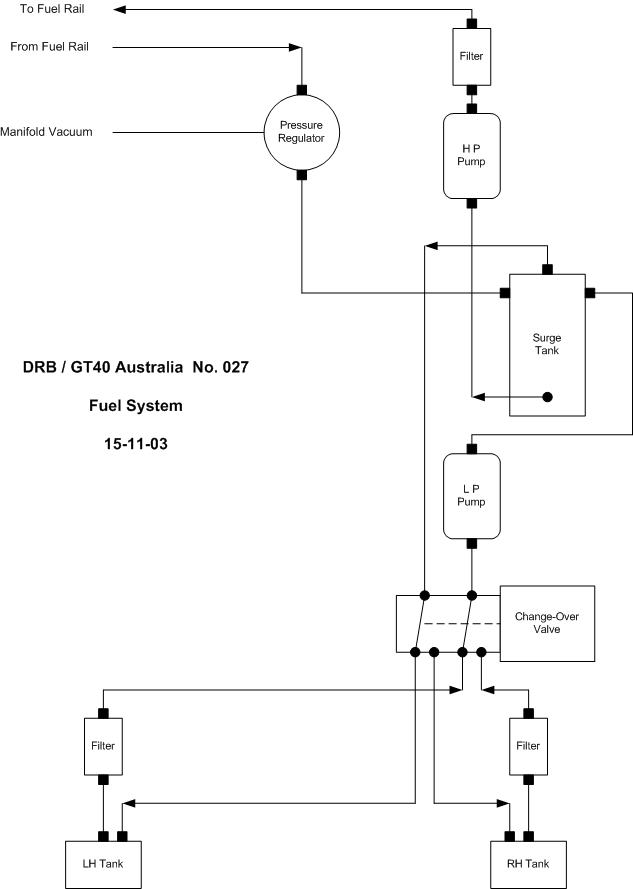

I purchased electric fuel shut off to make my efi sys work with two pumps, two tanks and two return lines.
has worked flawlessly

I was thinking about your problem and am concerned with weight transfer with a 1 way built into it. If you don't use the one way you should put the crossover at the rear of the tanks. There are a number of fuel tanks that have two pickup points. you may pickup some air if your that empty so you should consider a reserve. Airplanes have the same issues as they have wing tanks and need to constantly balance the plane, so you may want to look at the aircraft industry. They are a bit more expensive but simpler solution. My setup is two A1000 pumps with fuel gauges and a regulator that has a 3way valve for the return fuel at the end of the rails. flip of the switch and a twist of the wrist and I go from left to right or vis versa. this also gives me a level of redundancy on the pumps should one fritz on me.
