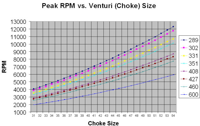

Once the motor gets some cubes and the max RPM goes up the standard weber seems inadequate (from the Weber tuning book and formulas, not me). I just graphed them for ease of visualization.

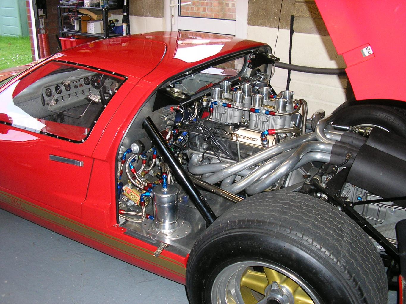

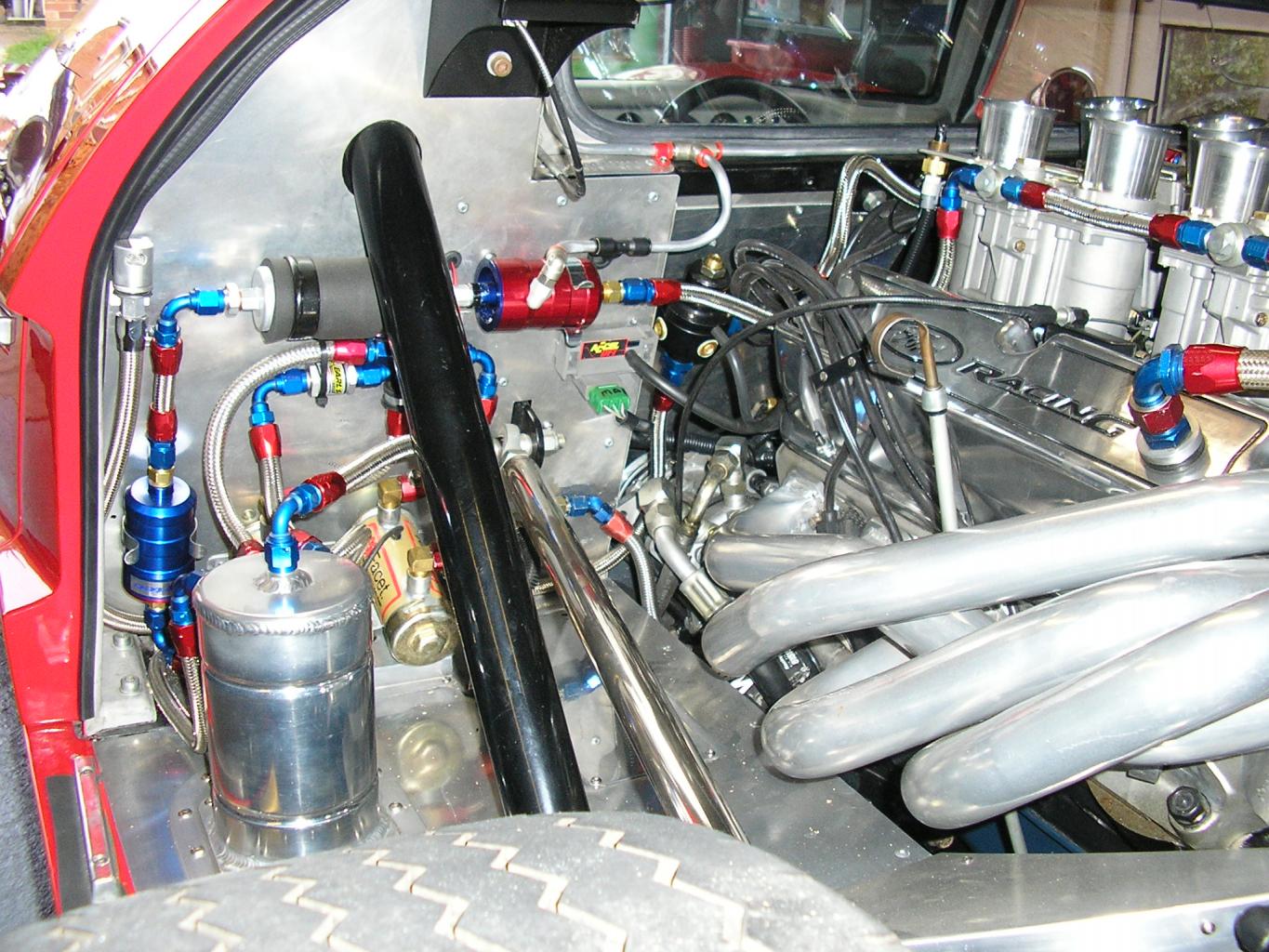

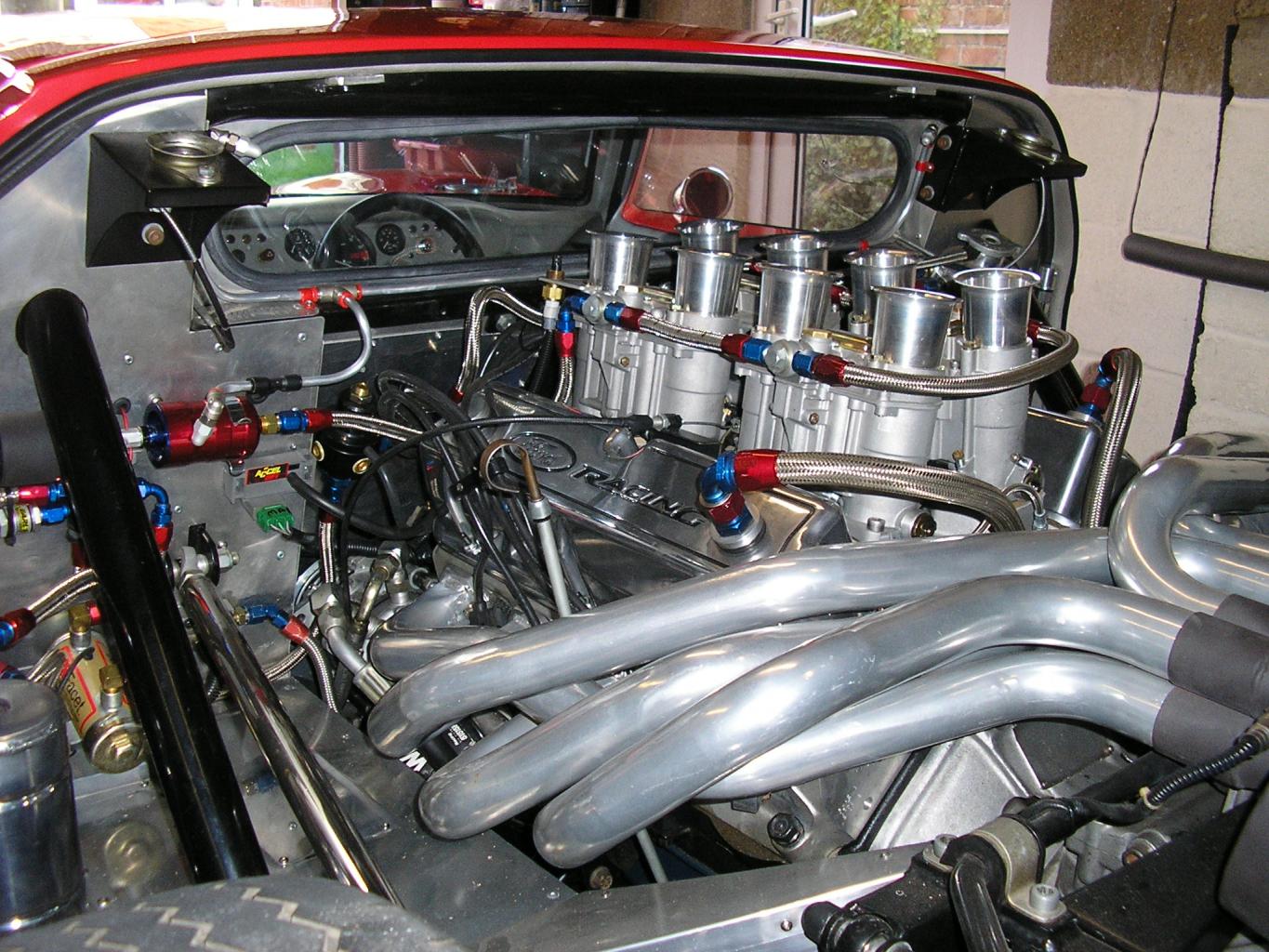

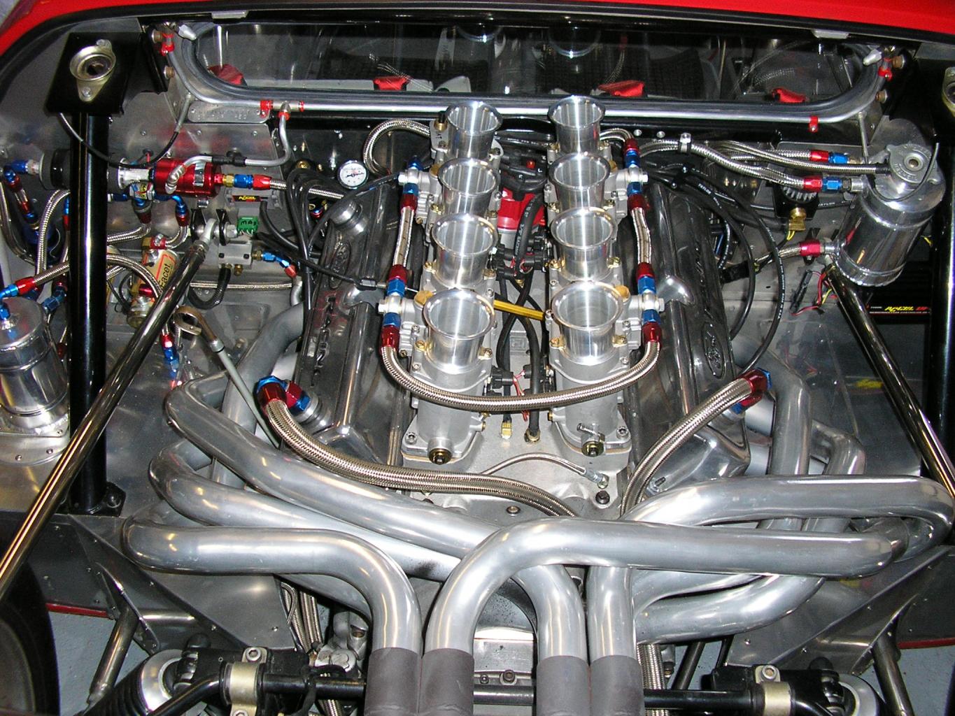

Or you could try one of these.
Photos that Mick Sollis sent me of his Southern GT at the Goodwood track day on Saturday.
In case you're wondering it's our 347 Dynaformance/ Accel EFI motor.
Apparently it went rather well !

After driving on webbers for many years with the gt40 the change to fuel injection was quite a shock it totally transformed the way the car drives making it so much smoother right through the rev range it also starts easier and the fuel guages dont go from full to empty between petrol stations.Also it went from 450 hp to 490 on the dyno.
regards mick.
