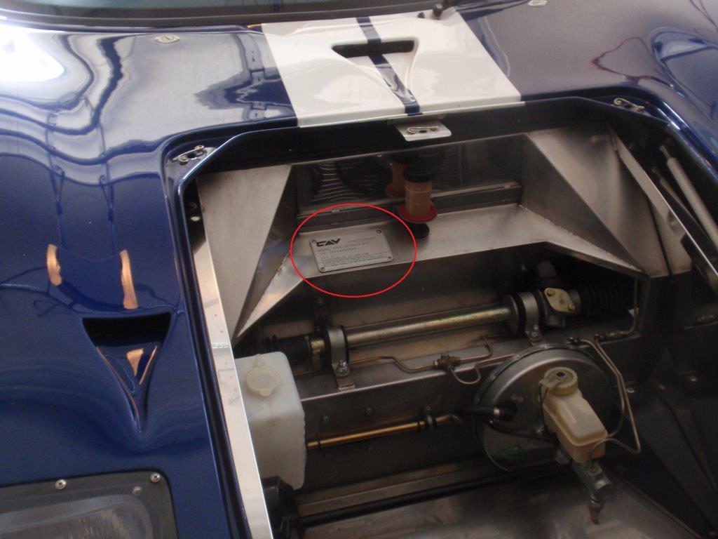

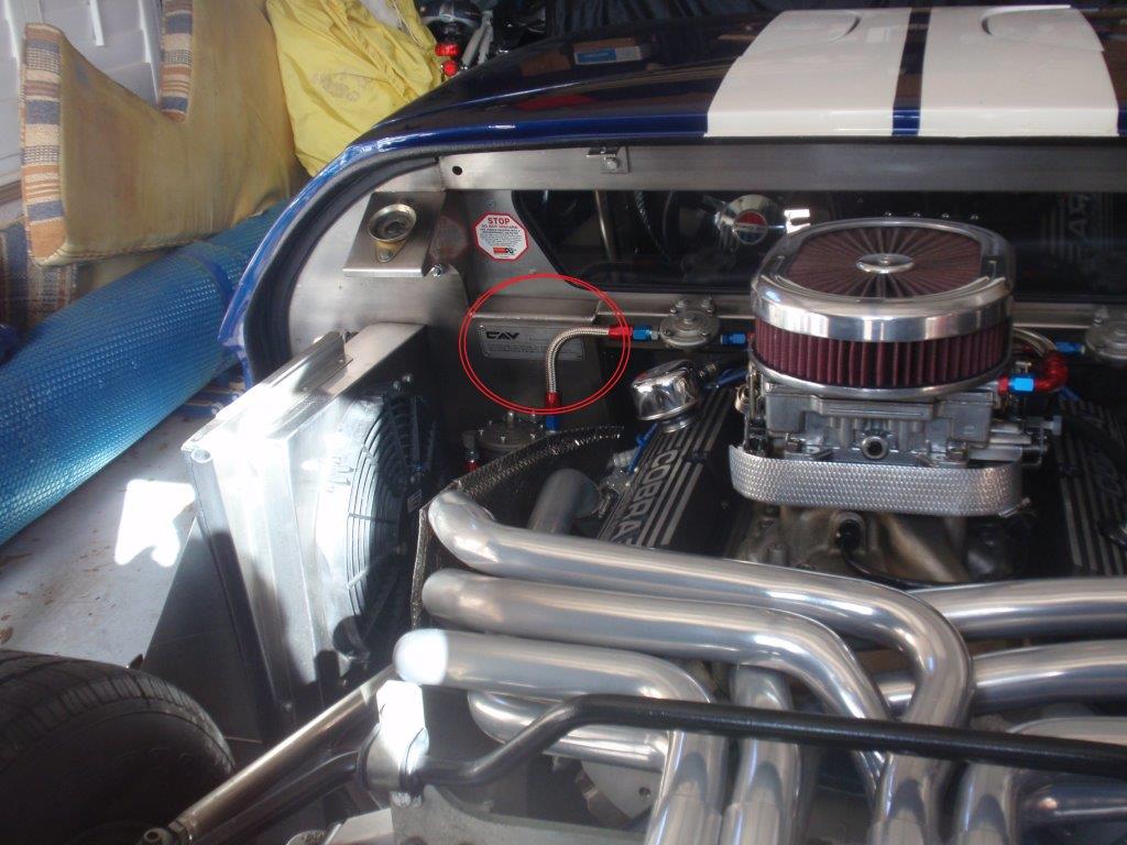

Thomas, there are two places to look. Under the front clip there should be an Autofutura/CAV dataplate as well as one under the rear deck on the left side firewall behind the driver seat in the engine bay.
Thanks Veek!
I will pass on your pictures to a potential seller who told my he would not be able to locate such number which did sound a bit odd to me but anyway.

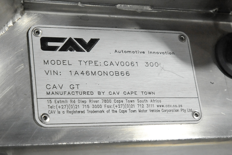

So would this mean that this one (from another car for sale in the US) is a pre #100 car - correct? It was built in 2006.
Pat
You are correct, the data plate you have in the photo is CAV MONO #46, obviously a pre-100 car. As for the 2006 car you mention, I'd also verify the build date. The plate serial number would be as of the date the car was built by CAV. It may have had the engine and trans added much later to become road worthy (which I would refer to as the "finish date"). That could be quite some time after the factory build date. To add to the confusion, the first "registration date" may be thrown into the seller conversation as well.
