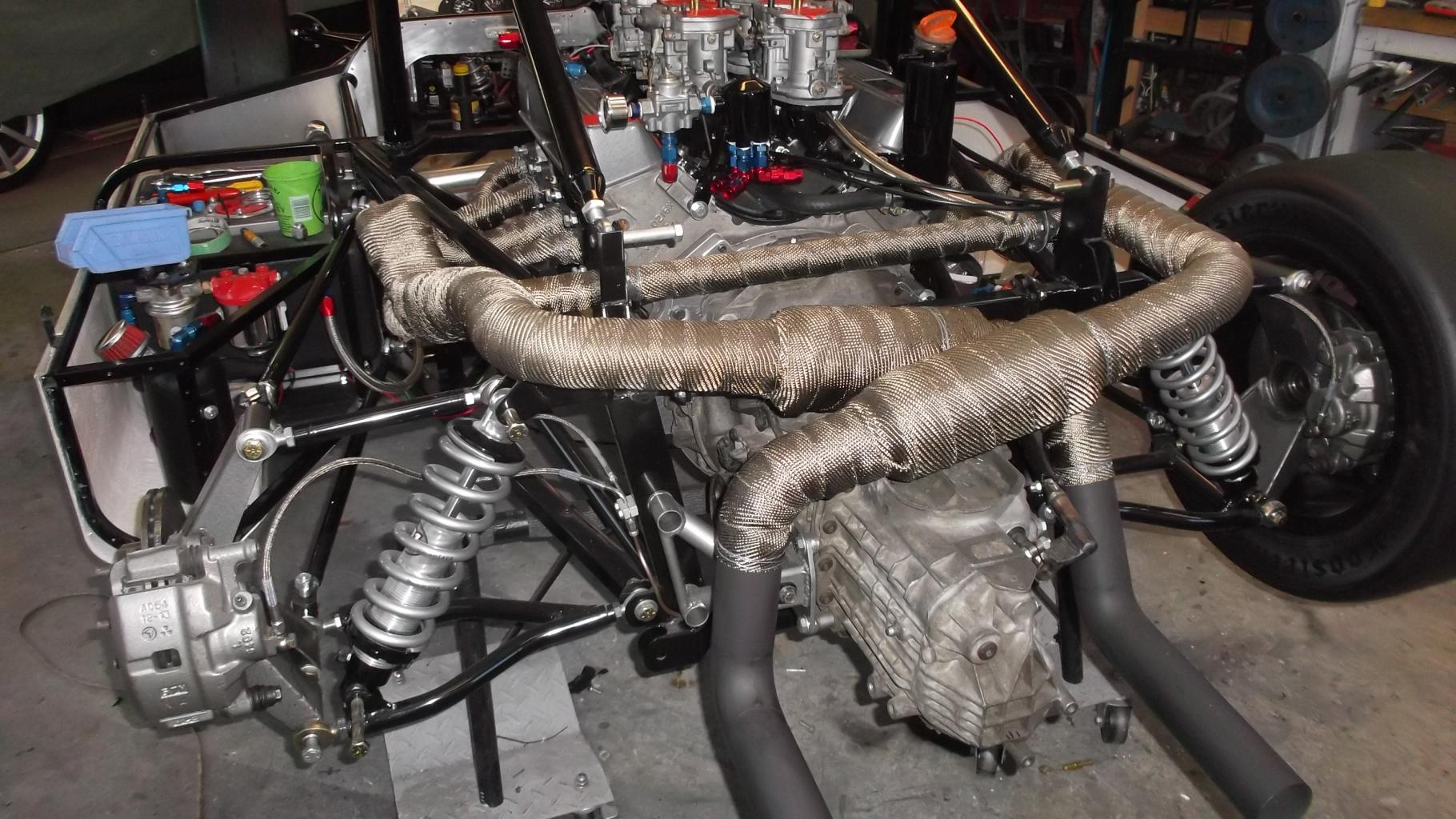

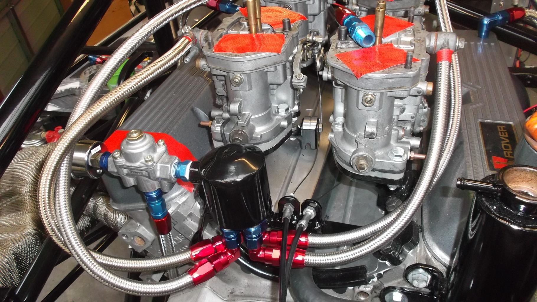

The second photo shows the fuel accumulator with the 4 fuel hoses out the bottom....

Sounds like an air lock or a Vac lock ?
The accumulator --maybe the hoses should be at the top ?
Does the fuel tank breath ?
Eh ?
The hoses are at the bottom of the accumulator / surge tank to take any possible fuel surge, the pump has very strong flow out of the carb side of the regulator and yes the tank breaths.
The question really revolves around why it has worked before and why the regulator suddenly stopped passing fuel. It is set up as a deadhead arrangement and the regulator is designed for this set up. There are also overflow drains to the tank from each carb and each carb feed pipe is clear back to the surge tank.
Russell
flatchat(Chris)
I suspect a vapour lock in the accumulator--- when that can gets hot the fuel vapours expand creating back pressure --locking out incoming fuel
While everything is cool and flowing --probably OK --a bit of heat soak and you're in trouble again
By pass the accumulator or put a pressure relief in it back to the tank
-- better still all surging and accumulation done before the pump
That's my Trumps worth :)
