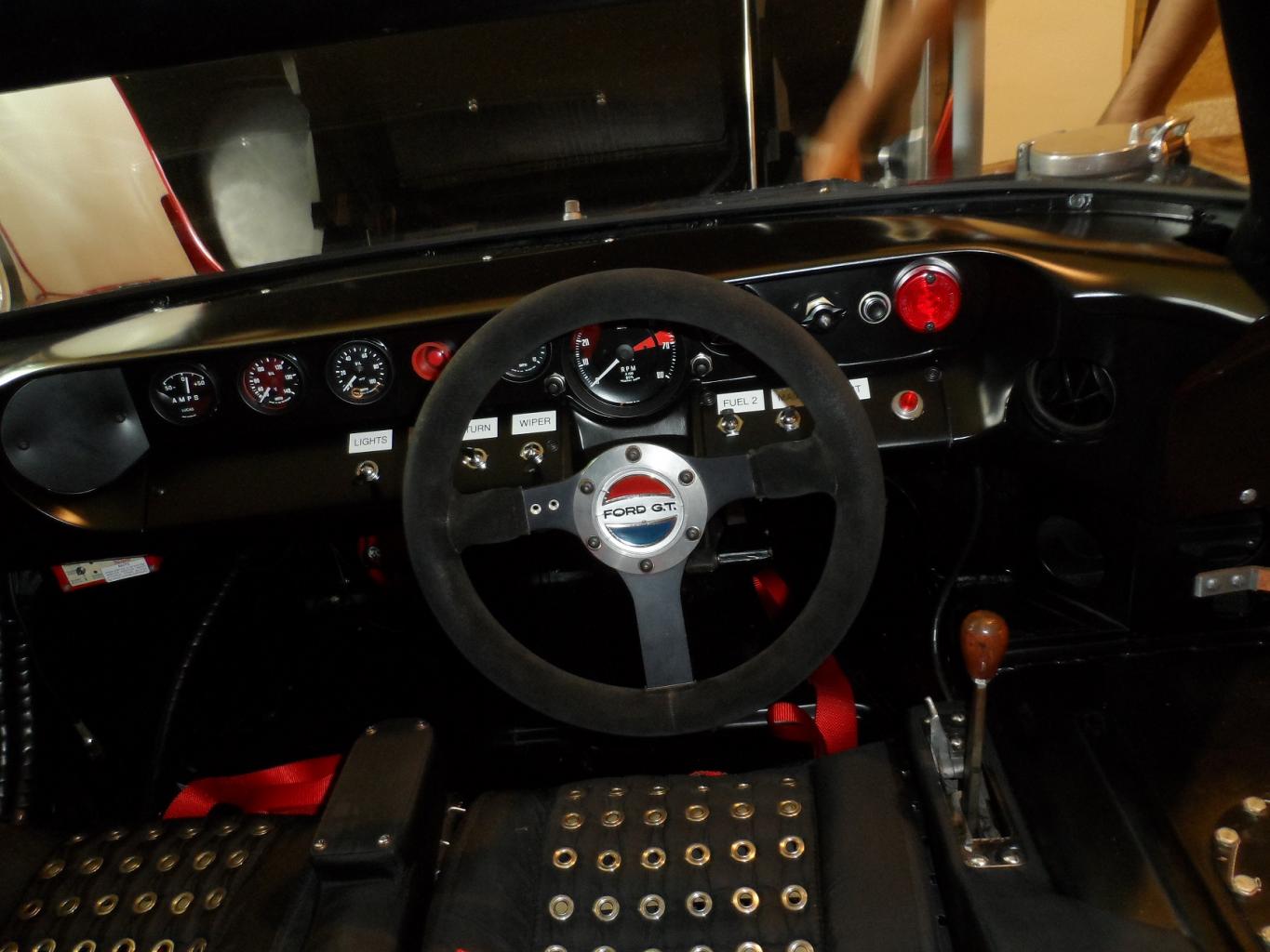

Here is the steering wheel from my buddy's P1083. I can't confirm if it is actually the original wheel, but it is what is on the car now. I don't know why it would have been changed. It evidently used to have buttons for radio or something.
-Bob Woods
-Bob Woods
It is a later addition, no GTs came with Alcantara wheels.
Ian Anderson
That means there is another original steering wheel out there ----- around which another original will be built :laugh: :laugh:
So now of the original 103 built now only 372.6 originals exist ?
With the race cars and the changes they all had there can be many original pieces depending on the year. So to me it's very confusing. I am glad in a way I know mine is not ( real) so I can change small things without affecting the feel of aGT40 if that makes sense.
