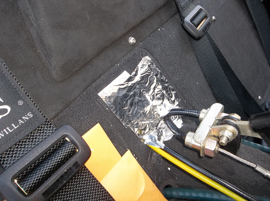

There are two threaded adjusters where the cables attach to the handbrake lever. I don't have a picture I can find right now, but they are forward of this where they attach to the handbrake lever.
Interesting. I couldn't find them, but probably didn't realize what they were. There are now 3 adjustment points! That just adds to the mystique of getting it right.
