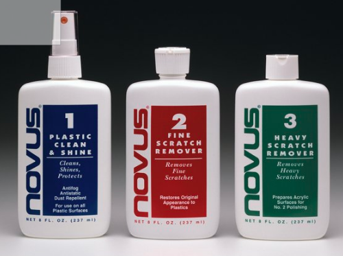

Back in my motorcycle days I always had good luck with Novus products for cleaning and polishing scratches out of lexan motorcycle windscreens.

I use Novus to polish pinball playfields bloody top stuff, brings the plastics up really well
