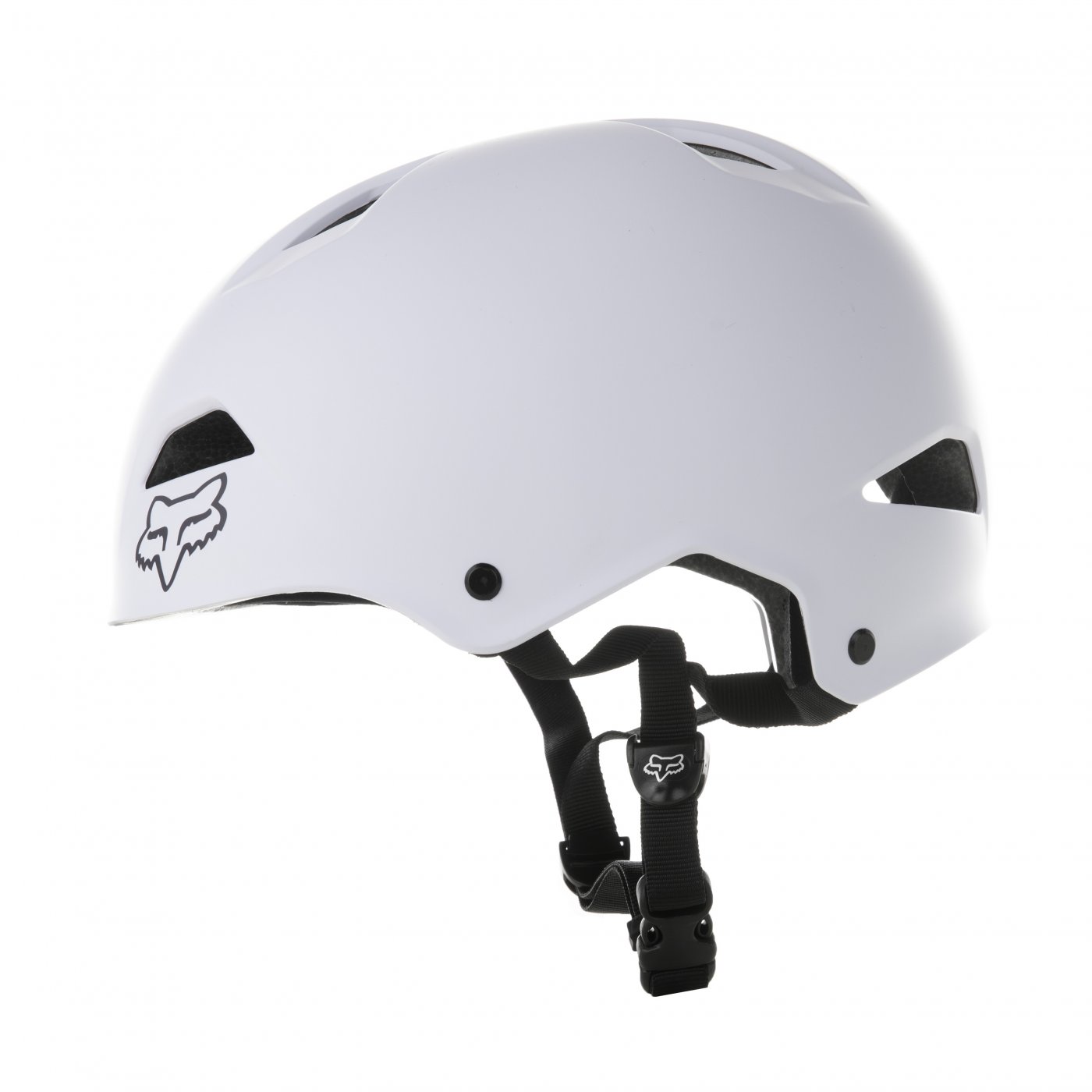

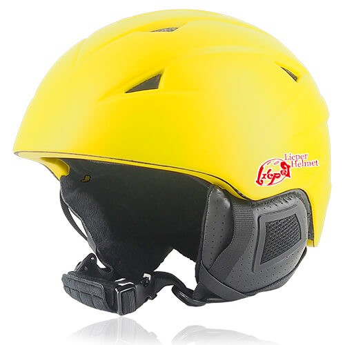

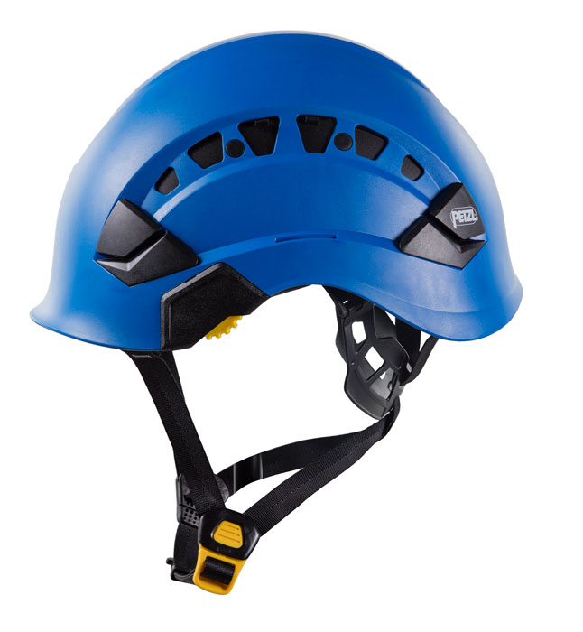

something like this perhaps?
Howard Jones
Here's a few ideas I came up with. Before I begin. THEY ARE NOT MEANT FOR MOTORSPORTS. They do not provide the high velocity impact protection that auto racing helmets do, not even close. OK I said that first!
But.............would they work under very limited circumstances such as a low speed fender bender, or a slow slide into a ditch, or even a light crunch into a guardrail. Enough of a shunt to damage the nose or rear clip bodywork but not hard enough to really hurt the chassis or rip suspension pieces off the car.
Just to protect your head from bumping the roll bar hard enough to hurt. The helmet and a best quality tubing padding would be better than nothing.
And........ be suitable to wear given the goals of a lightweight, small footprint, cool with good airflow, and good ability to hear. Note that they all expect hard surface impacts such as rocks, concrete, and ice.
Rock climbing, skateboarding, and snow skiing. Left to right.
I don't know if this is a good idea, but its a option I suppose.
