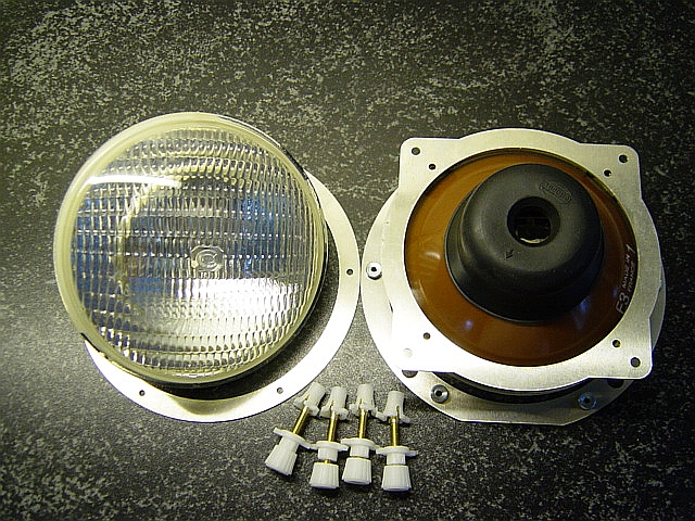

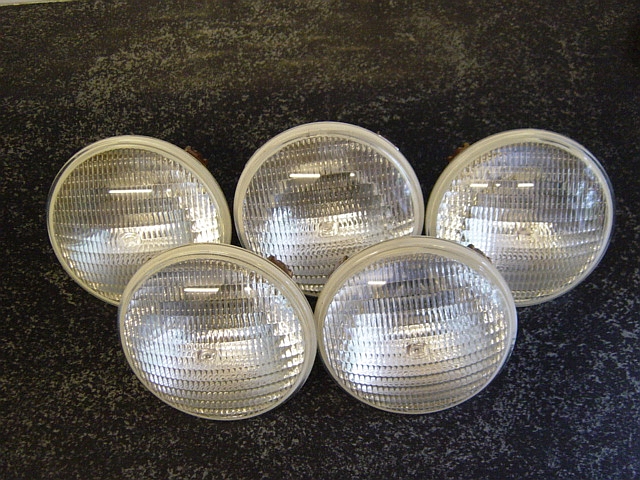

The original round units were made by Cibie.
Check out the sponsorship story on the Wyer Gulf cars.
http://www.gt40s.com/forum/gt40-build-logs/26363-mirage-automotive-jimmymac-alistairs-cars-22.html

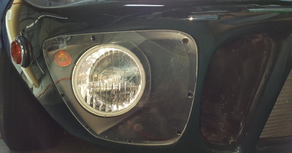

This is what I'm using on my RCR....Long Range, Center-Weighted Beams. They are CIBIE IGM units and they are bright! Kinda like aircraft taxi/landing light bright...so should get people's attention on the highway even in the daytime. I never liked the look of the rectangular lamp and question their effectiveness. I believe the round lights add to the appeal of the car (form) and actually work quite well (function) considering it has to pierce through a polycarbonate cover.
I am able to squeeze in a small amber turn signal unit on the upper corner, which works with the side marker so I can signal my intent from the front and sides.

Thanks for all the tips. Jeff-great looking car. Do you know what LED indicator you used? I like that it's subtle and avoids using the low beams. Probably a modification I can do myself.
