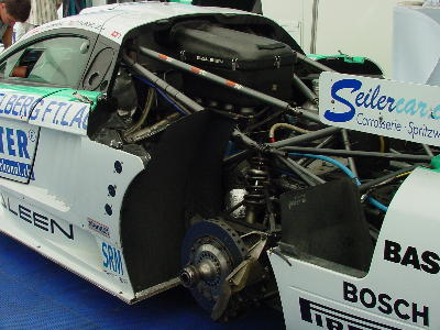

I am reasonably sure the S7 uses a RBT-6 speed. Which is about 2" longer then the 5 speed ZF with the additional length added to the rear area (after the diff).

thought id try this upload pic deal with a pic of a s7
