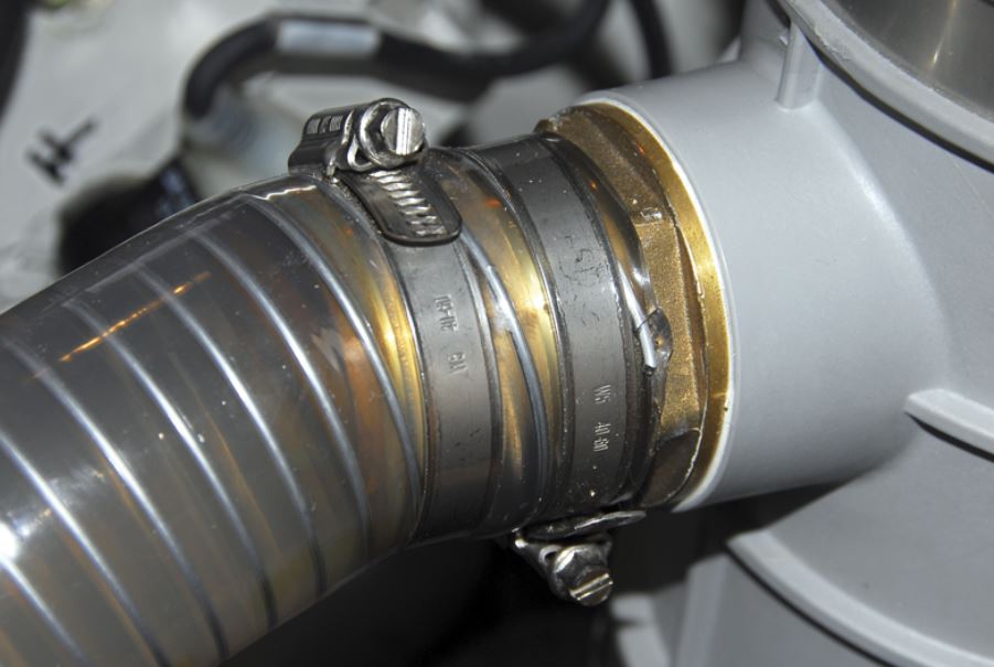

Just an idea - in the marine industry it's standard to use offset double hose clamps for all fittings that have to be water tight (below the water line).
Personally, I like to use the smooth band stainless Norma hose clamps on everything rather than the open/cut thread type as the smooth type seems to provide a better seal and damage the hose less.
