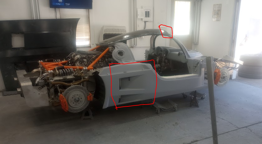

Just curious, what does everyone use for the vent screen material on the body and roof?
O Ryan Apr 9, 2024 #1 Just curious, what does everyone use for the vent screen material on the body and roof?

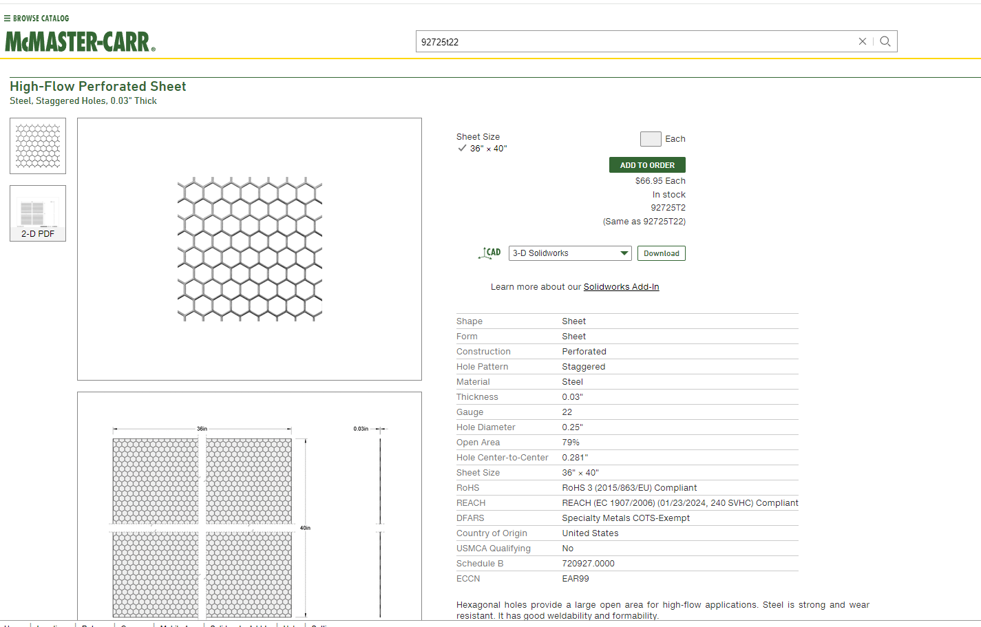

H Kurt Hoffman Apr 9, 2024 #2 Ryan, This is what I used, painted flat black, then bonded around the opening with 3M panel bonding adhesive.
