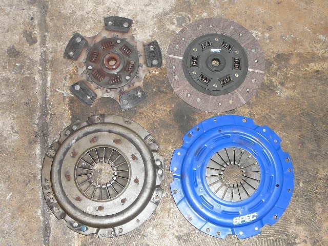

If you have an 016 then you might try the clutches from SPEC. I replaced my original clutch years ago because of the chatter and it's been great. When I upgraded to the GTA (www.germantransaxle.com) modified 016 they added a reasonable ring gearing and LSD. I've been really pleased with it. The SPEC clutch I used was SA113F and even though the thing was five years old when we installed the new box, it showed little wear.
Here's a comparison.
