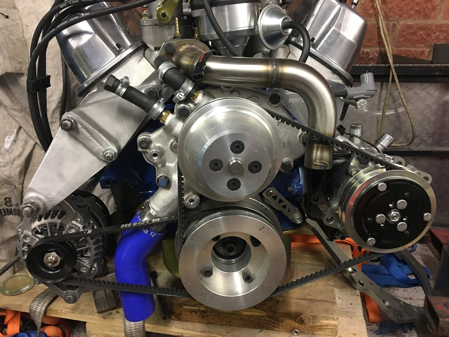

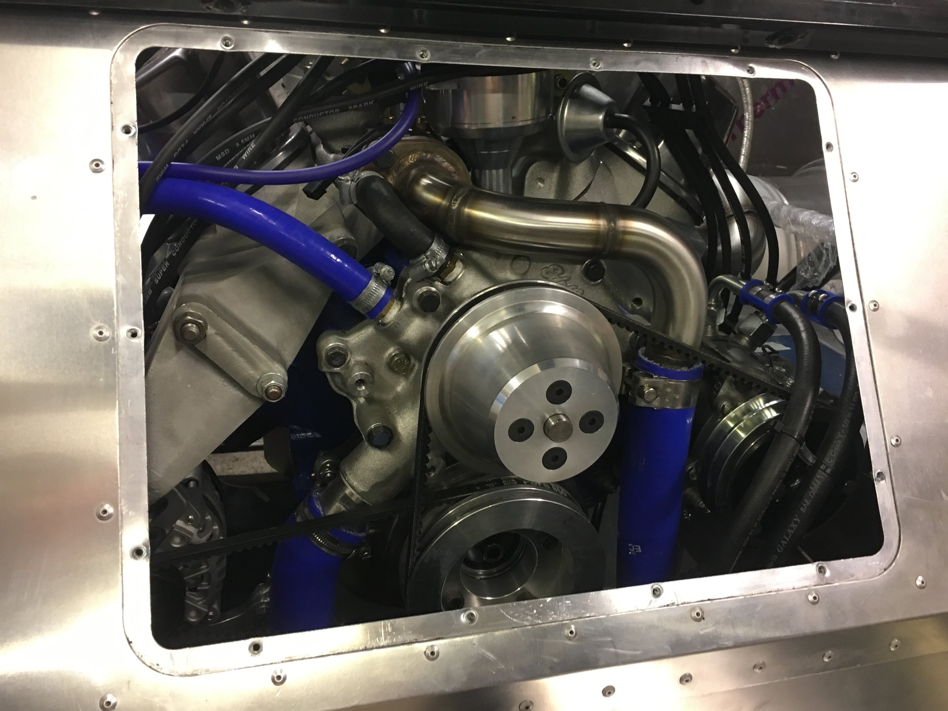

Hi, Moroso electric water pump/ short nose Weiand uprated alu waterpump/ low mount alternator, AC bracket from SGT. Short AC compressor. Alu pulleys from SGT to match his setup.
Which Gearbox?
Maybe this could help

Just a tought.,. Plan your pump purchase with your pullies in mind so you get everything aligned. Mick can get you all the parts you need for the SGT in regards to waterpump, alternator low mounted, brackets and ac compressor. Short for ZF, standard ok for UN1.
Easier than rethinking the wheel:)
