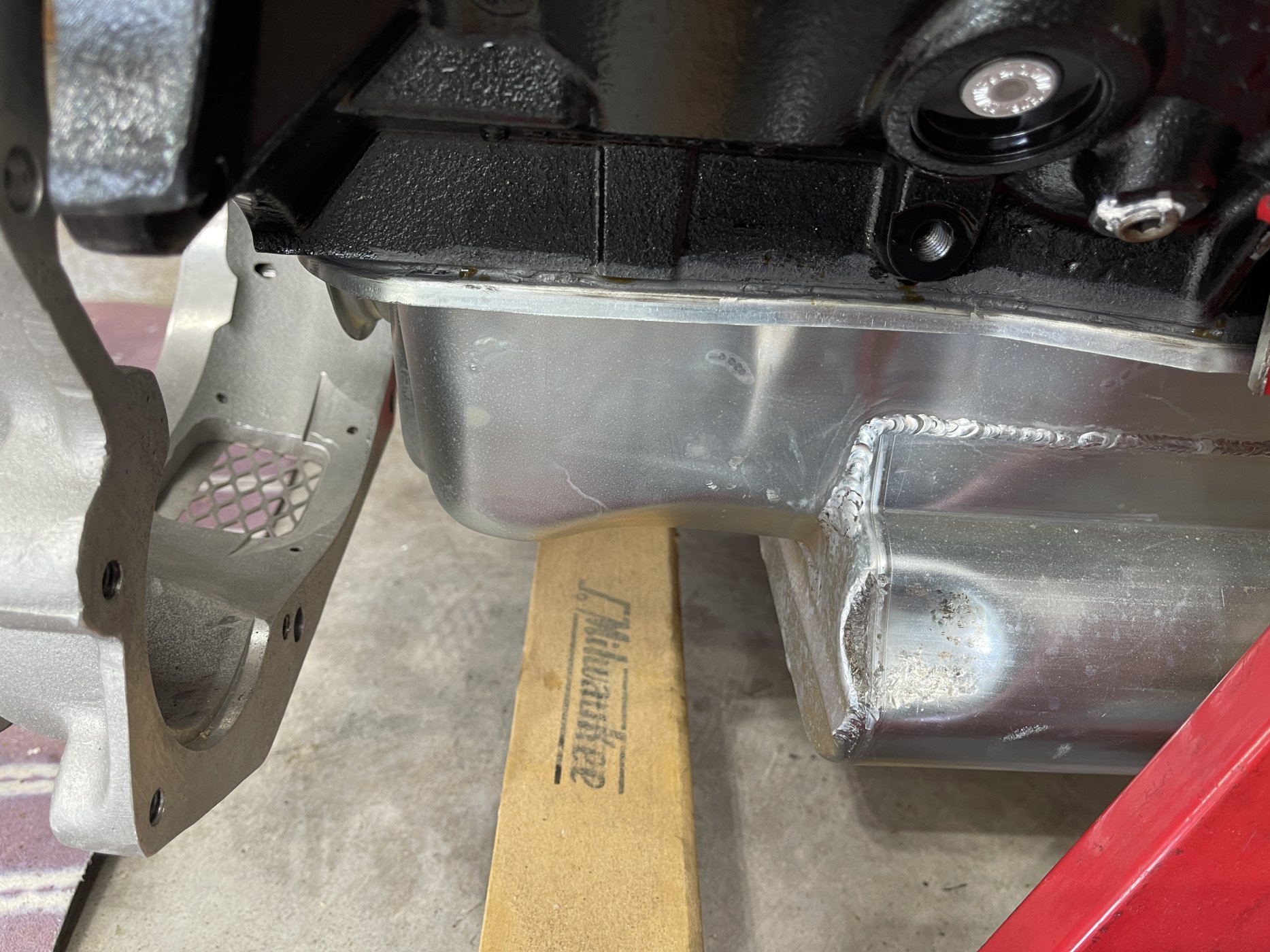

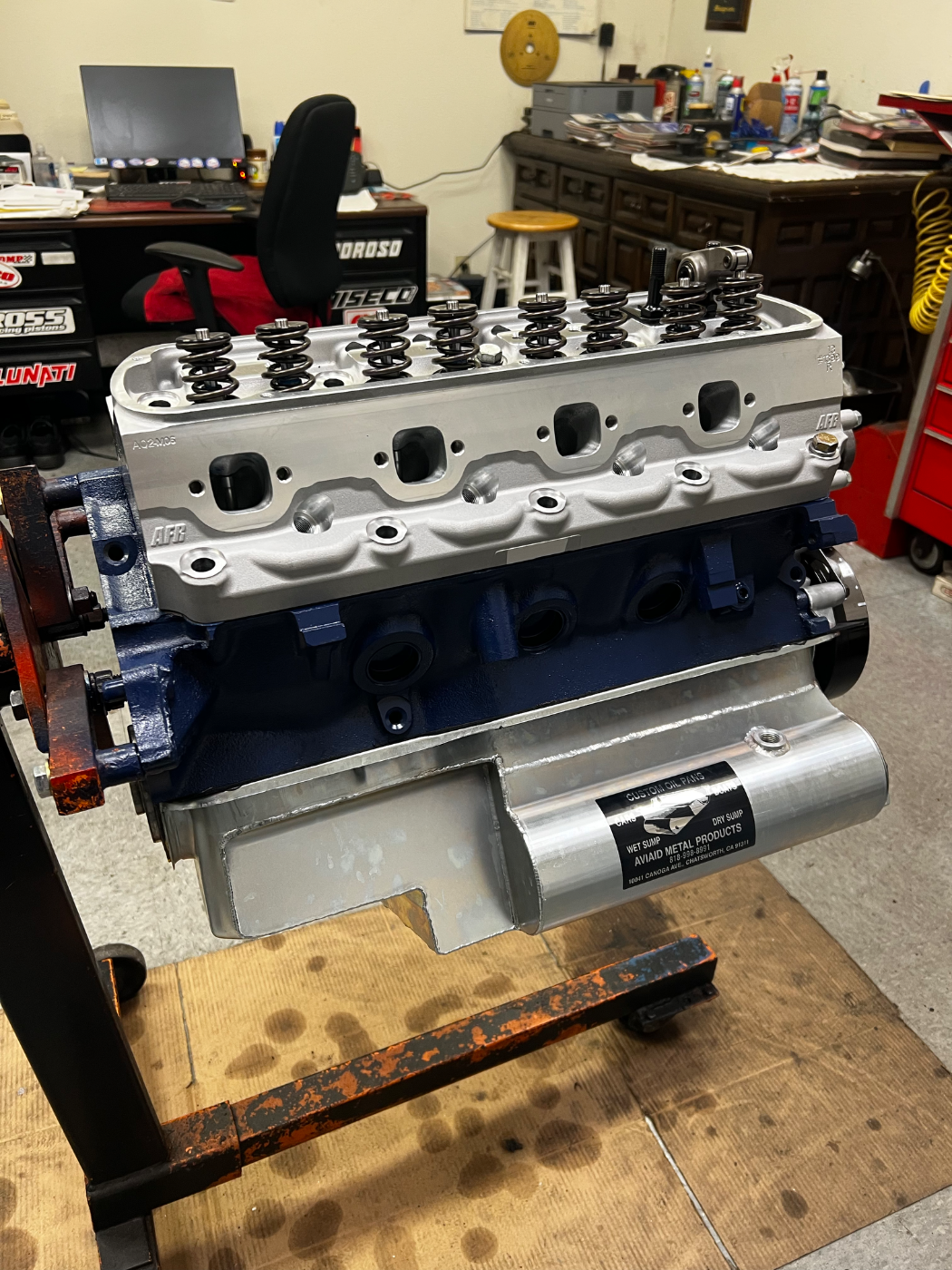

The Aviaid I have on my engine has 4 gated baffles, side baffles and a top one over all the others. However, I had to modify an outside corner to allow for starter fitment. Hopefully the engine won't mind a few oz. less oil.
