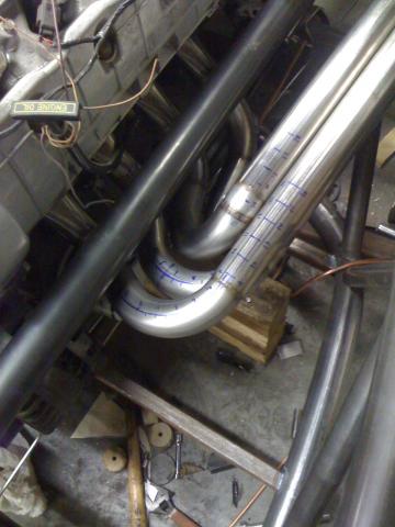

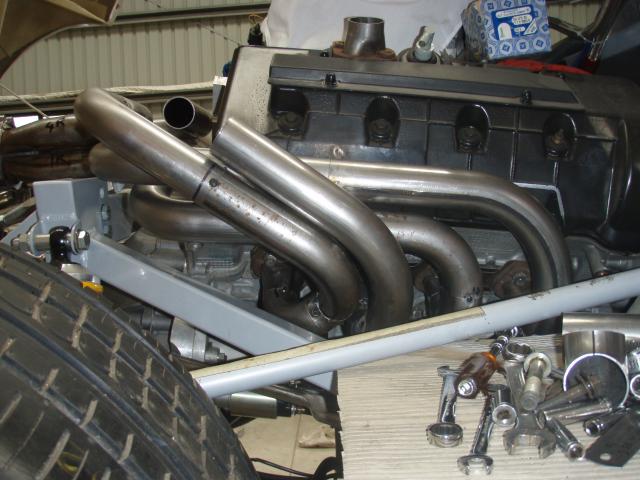

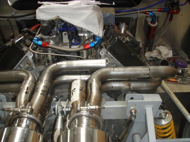

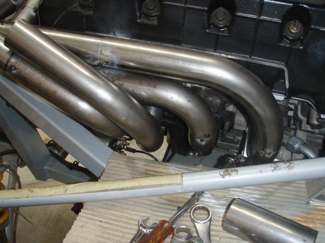

Hi Pete,
I built my own,i used the flanges off orginal exhaust manifolds(lincoln mk8 engine) made a tool to shape 1-3/4 dia pipe stubs and then went from there using bends and donuts into 3 inch collectors

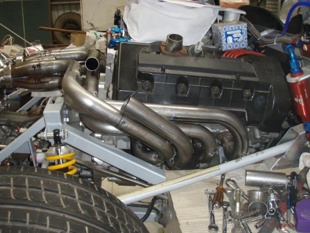

these are for a supercharged cobra heads with the rectangular ports. I made the flanges from 3/8" ss plate and formed the rectangular to round sections over a steel mandrel. 30" equal length 1 3/4" tubes to a 2 1/2" collector with a 3" reversion cone.
