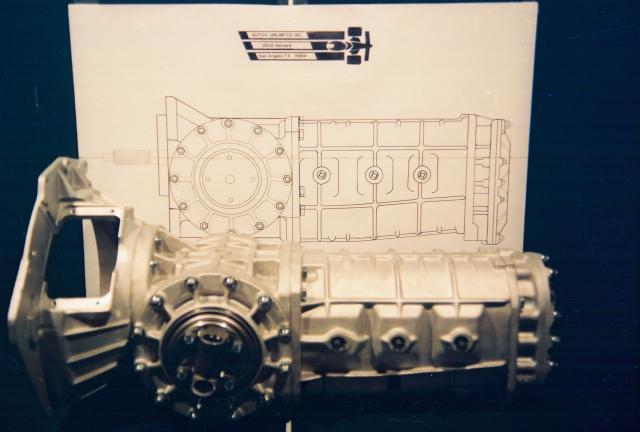

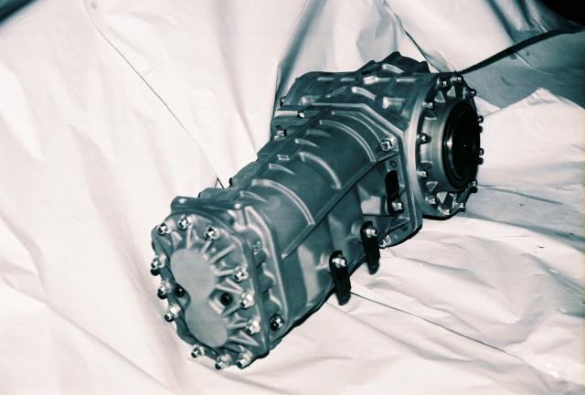

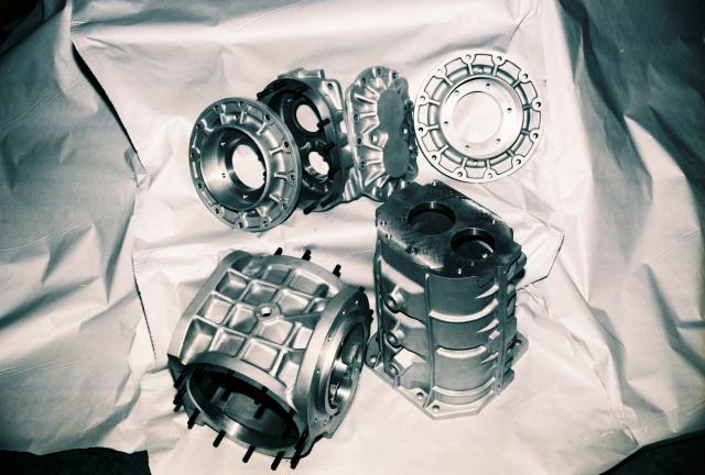

For those who never saw a 850QC...
Here are some Pics..
DeLynn
