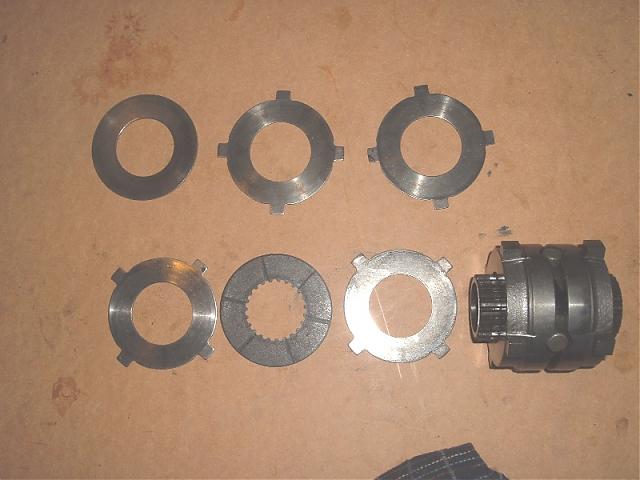

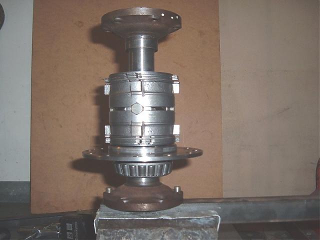

Well Jac Mac, it must be rocket science! But it works this way:- The ring gear turns the diff/LSD housing which drives the tabs on the two halves holding the 4 spider diff. This works as a normal diff. The LS effect torque transfer is achieved by a clutch pack which drives from the housing onto the diff output gear.
1st pic is diff and slip assembled up without housing.

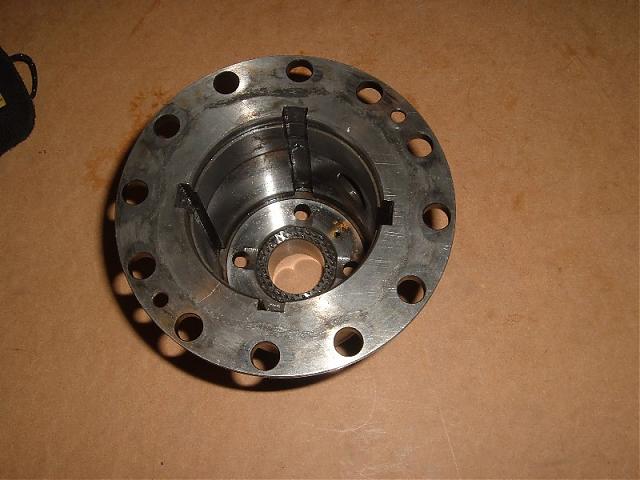

2nd pic is housing. You can see the four slots which drive the tabs on the drive plates and diff assy.
3rd pic is is one side laid out in order. Diaphram, 3 drive plates, driven plate, drive plate, diff. The other side is the same mirror image. The drive plates and driven plate are available in three different thicknesses 1.9, 2.0, and 2.1 to adjust the transmitted torque to spec. Probably easier just to shim it up if nothings worn. The three drive plates together seem like a prime target to replace the middle one with a driven plate which would then act like a twin plate clutch and transfer more torque to the loaded wheel. 351 cubes ;) and 14" tyres could benefit from a lot more LS drive.

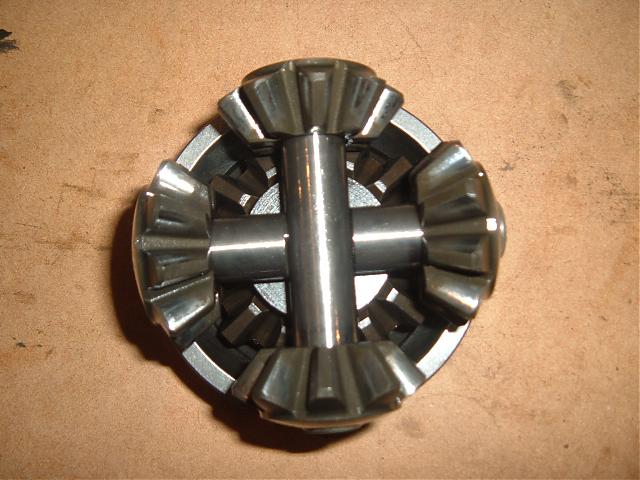

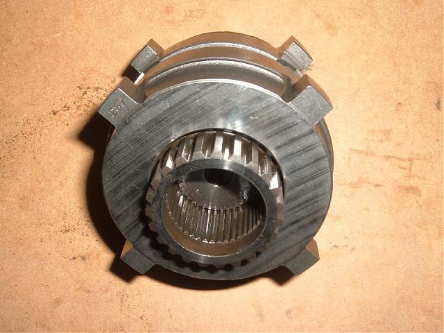

Last two pics are just photos of the diff itself

Russ, you missed one point in the power flow, the 4-lugged plate housings also drive the cross with the spider pinions which in turn drive the side gears axles- now note the ramps that the 'cross shafts' climb up on to apply clamping force to the clutch plates under differential action- now if those 'ramps' had different angles to apply the 20/80 forces under deccel/accell or whatever then fine, but to me they look to be the same angle & therefore would apply the same amount of clamping force in both directions. Since the clamping force applied by the ramps/side gears is virtually fixed the best way to acheive a more effective LSD is to increase the number of plates per side. ( that increases the friction surface area ).
