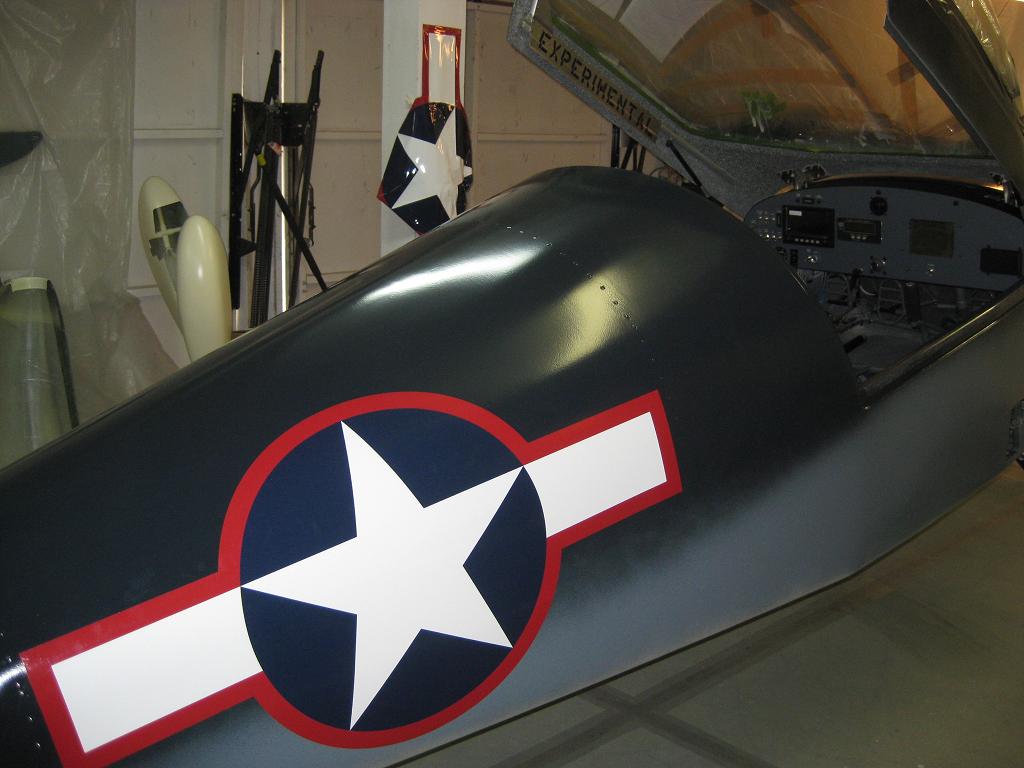

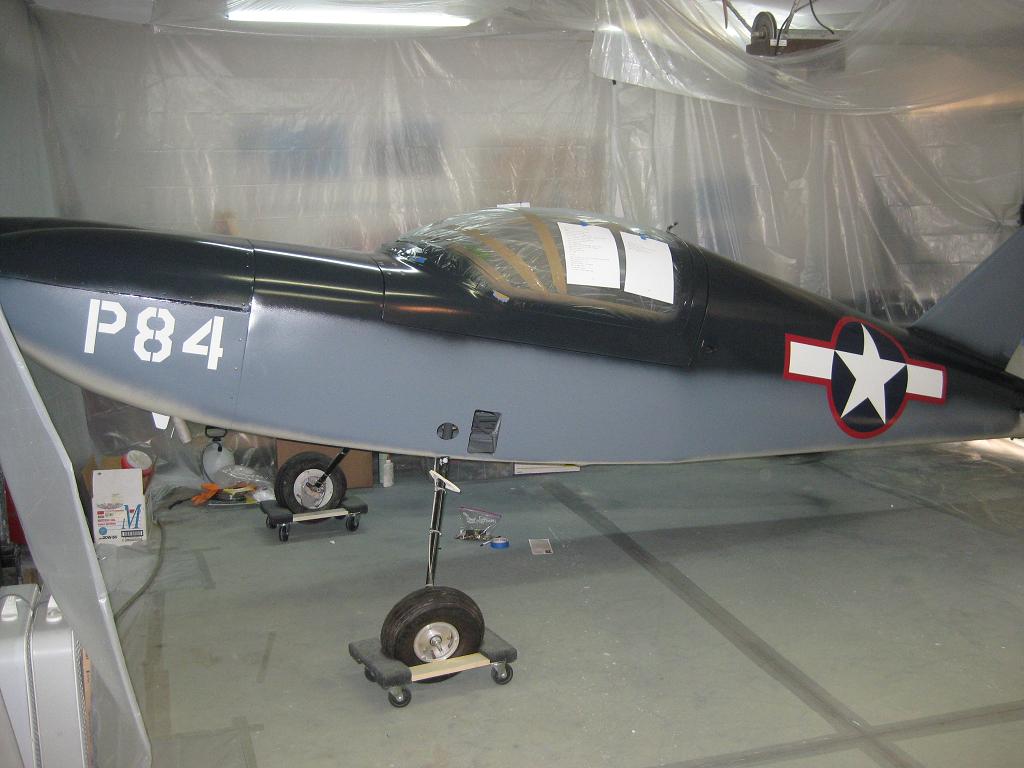

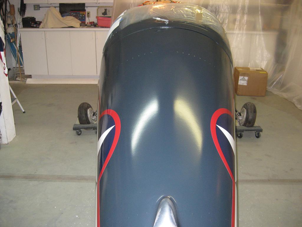

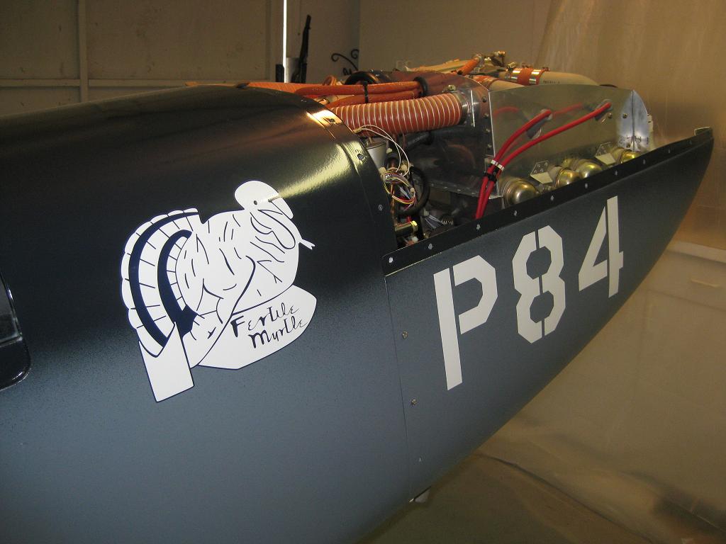

That's it! I have just painted mine in the three color Pacific Theater WWII paint scheme (dark blue on top, grey-blue on the sides and white on the bottom). Then I put period correct roundels on it and a digitized copy of my Father-In-Laws nose art. He was a Marine and flew SBDs and TBMs.

I must say that there are some seriously talented people that are members here. Post up more pics as I have a feeling that the tech involved could cross over to what we are passionate about.
Jim Craik
Mike,
That's a beautiful aircraft!
Love the paint. I notice the red border on the US insignia, used for only a few months in 1943. Was your father-in-law flying SBDs in 1943?
I would have to look at his logbook Jim. He flew SBDs in the Virgin Islands - antisub, then moved to carrier based (CVE107) TBM and saw combat in Okinawa bombing kamakazi bases and close ground support. I suspect he was more late 1944-1945.
I took liberty on the paint scheme. I live near Chino, CA and the Planes of Fame museum and they had this scheme on a Hellcat and I really liked it. I prefer the red outline on the roundels. My FILs SDB had the white/grey Atlantic paint scheme and his TBM had a solid dark blue paint scheme.
The nose art was from his TBM days - the TBM wassometimes referred to as the "Turkey".

In my mind they are very similar. This plane has a steel tube cockpit cage covered by 6 large moulded fiberglass shells that were bonded/riveted together. The wings and control surfaces are all riveted aluminum (I plan not to paint those). The kit was complete down to the washers.
The places I got to exercise my creativity were the avionics and the firewall forward. For avionics I have a GRT EFIS with built in GPS. This is fed via a serial bus by a GRT EIS which constantly analyzes the engine with some 20+ parameters. I also have a comm, a transponder, an interco, two trim systems and a video camera with monitor. Pretty basic fair weather sport plane.
Firewall forward I have a TCM IO240 (like the front engine on the Voyager around the world plane), dual Lightspeed electronic ignitions, and dual alternators. It should feed 130HP to the fixed pitch Sensenich wood prop (painted black with yellow tips of course). All the fuel system, ignition system, electrical system are all my own.

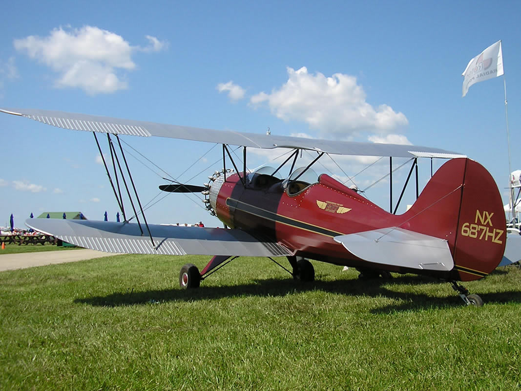

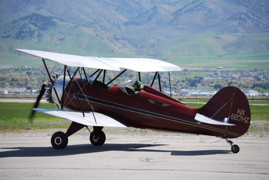

This is what prompted my original queston. Been studying it in detail - Rotary 9 cylinder engine (made in Australia), two place, fabric cover.
Hatz Classic, based on the 1930's Waco.
Reality check: would probaly take about 2000 hours and would be strictly a fair weather flyer (20 hours a year?) Jag would take half that time, even with lots of detailing, and could be drive under IFR conditions.
So the dilema: build an XJ13 or a biplane?
