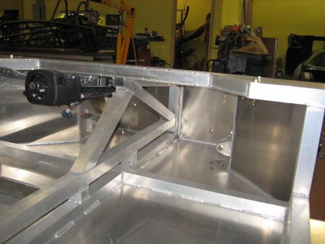

There are a lot of pictures of the SL-c interiro on this forum, on the RCR site and in various magazines. No offense but have you ever looked at them.??
There is no room between the seats. None. Zero.
Man I hate not being able to edit. Forgive the spell checking, I submitted before I was done.
The interior is large but seats are moved inboard. The area between seats is only about 3 inches and it is occupied by the mono's back bone tubing.

At some point the shear amount of modification you would have to do to the chassis is plain undoable. No amount of money, time or skill is going t change the fact that the back bone is centrally located. If you scrap the triangulated square tubing, and move the seats outboard (causing problems with pedal box offset, you would still need some form of central structure to provide rigidity, support and carry the torque tube.
So to indulge the fantasy you could make a square box out of .5 inch aluminum plate. It would still need to be a good 6 or 7 inches wide. Now you have to fix your steering geometry and linkage. I still do not think the rear axle will line up (what with transfer cases fore and aft) so you may need to stretch the rear sub frame as well.
At this point it is cheaper to just start from scratch with a new chassis and maybe you can keep the SL-C body. Hell at that point make your chassis out of carbon composite panel like a Mosler. I was told that one could have a carbon composite panel monocoque delivered and ready to assemble for about 14k (you provide the cad). Teklam http://www.teklam.com/ can cut them for you. Now you do not even need to know how to weld. If you can do a puzzle you can make a chassis.
I am trying not to be a nay-sayer but on every board I belong to this flight of fantasy is discussed. In the end there are very few AWD cars in this genre for a reason. The DP1 http://www.dpcars.net/ uses one engine and a chain drive driving both sets of wheels. An Ultima was converted to all wheel drive by installing 2 motorcycle engines ( Hayabusa). Each engine is dedicated to a different axle. That was such a nightmare that I only recently heard the thing now moves after some 4 years of professional development. The Murtaya http://www.murtaya.com/ is a kit that uses the whole drive train of a Subura WRX as the donor. It maintains the front engine layout.
I am not saying it is not doable but the only practical way is to develop the car from the ground up around the drive train. Doing it backwards does not seem to have much history of success behind it.
