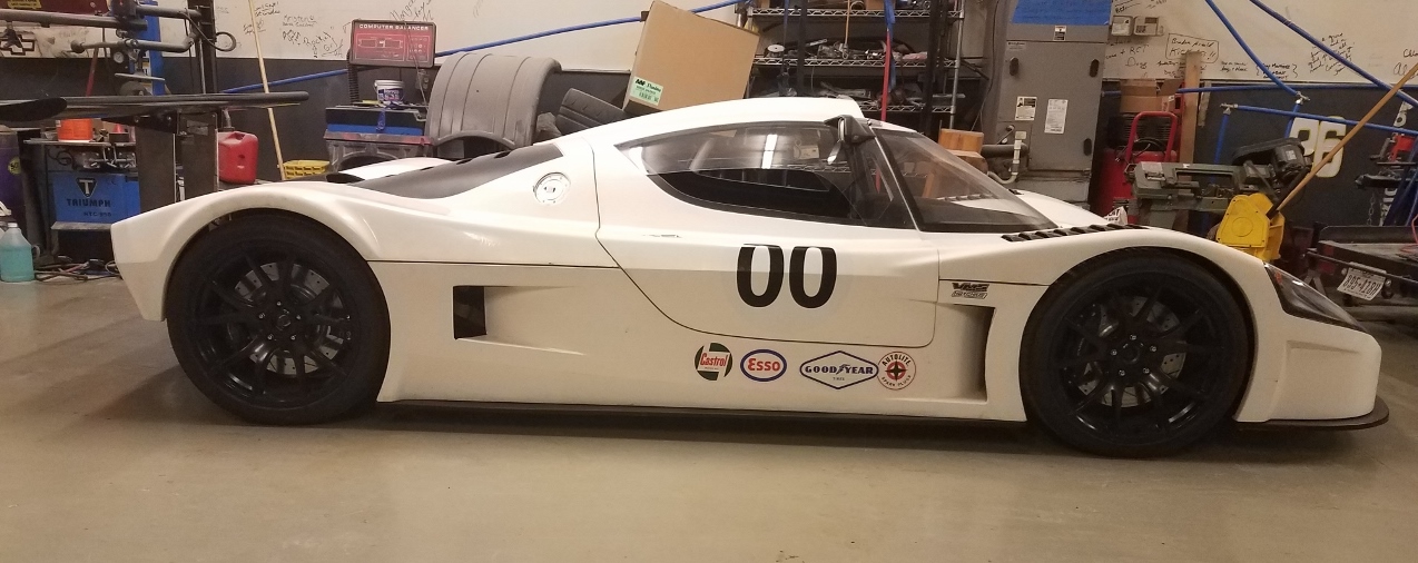

Another SL-C finished in Dallas
Well, almost finished. But it is registered and titled.
Thanks to Cam in Dallas. I wanted to build one of these ever since I ran across his build thread here, then it sealed the deal when I saw his car in person at Cars & Coffee and he took me for a ride. wow. Thanks also to Fran and the team for making a great product, Craig and Frank for their help, Alan for his YouTube videos, Will and the others for the wiki. It's very helpful to have people willing to share their knowledge.
A few details: LS3 525 hp, Mendeola SDR-5 transaxle, race tail, cf front fender vents, track ball joints, hippo mirrors, lexan windshield, 2 piece side windows. Primarily a track car so minimal interior finish.
I built a FFR Cobra track car so I'm used to driving a simple car with abundant power, but this takes it to another level. Can't wait to get it on the track.
Cheers,
John
