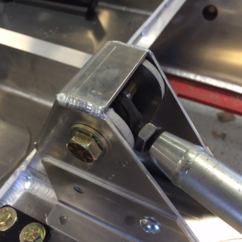

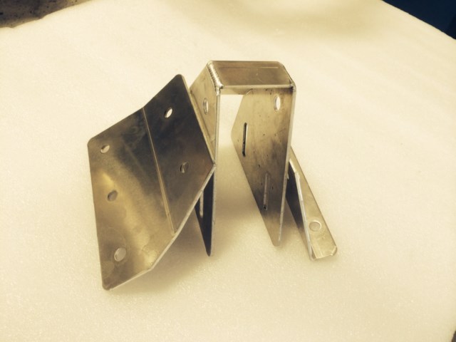

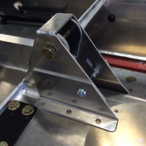

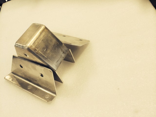

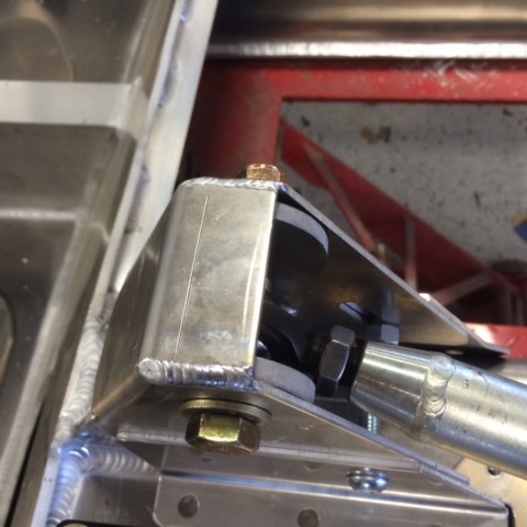

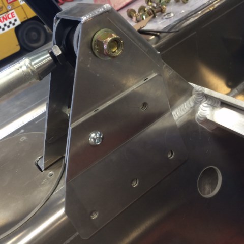

In an effort to keep our customers safe and happy.
We have developed these parts to relieve any concerns about an age old problem with rear radius rod suspension cars with the potential for the rod to enter the cockpit during an accident.
They also have the additional benefit of providing more strength to the suspension turret.
These components are a bolt on and will fit any monocoque chassis we have built in the last ten years.
It should be noted that we have never had this happen and it would need a "perfect storm" scenario for it to happen, but better safe than sorry.
These will be available to ship mid next week once welded and cad plated.
They are available to anyone that has an RCR replica monocoque free of charge.
