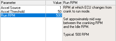

Have you set starter crank speed in the ECU. I know from Megasquirt I had to set crank speed for starting otherwise the ECU didn't fire the injectors enough (to low RPM).
Shaun
Hi JP, not sure I have, its a map I inherited but it did not have a setting for the HP fuel pump so I am not sure it was ever 100% I will check that as it makes sense the injectors are not triggering during crank but do on test, cheers
Shaun
Looking at the map offline I only seem to have this setting
Run RPM, cannot change it but that's maybe as I am offline to the ECU
What ECU do you have Shaun? And do you have something like Teamviewer installed, a lot of people that can help with 'remote tuning' at least to get the basics right. If its an ECU i've worked on before, I could help as well, but my time zone might be slightly different.. (update: it's not, your in the UK.. thought you were in the USofA)
